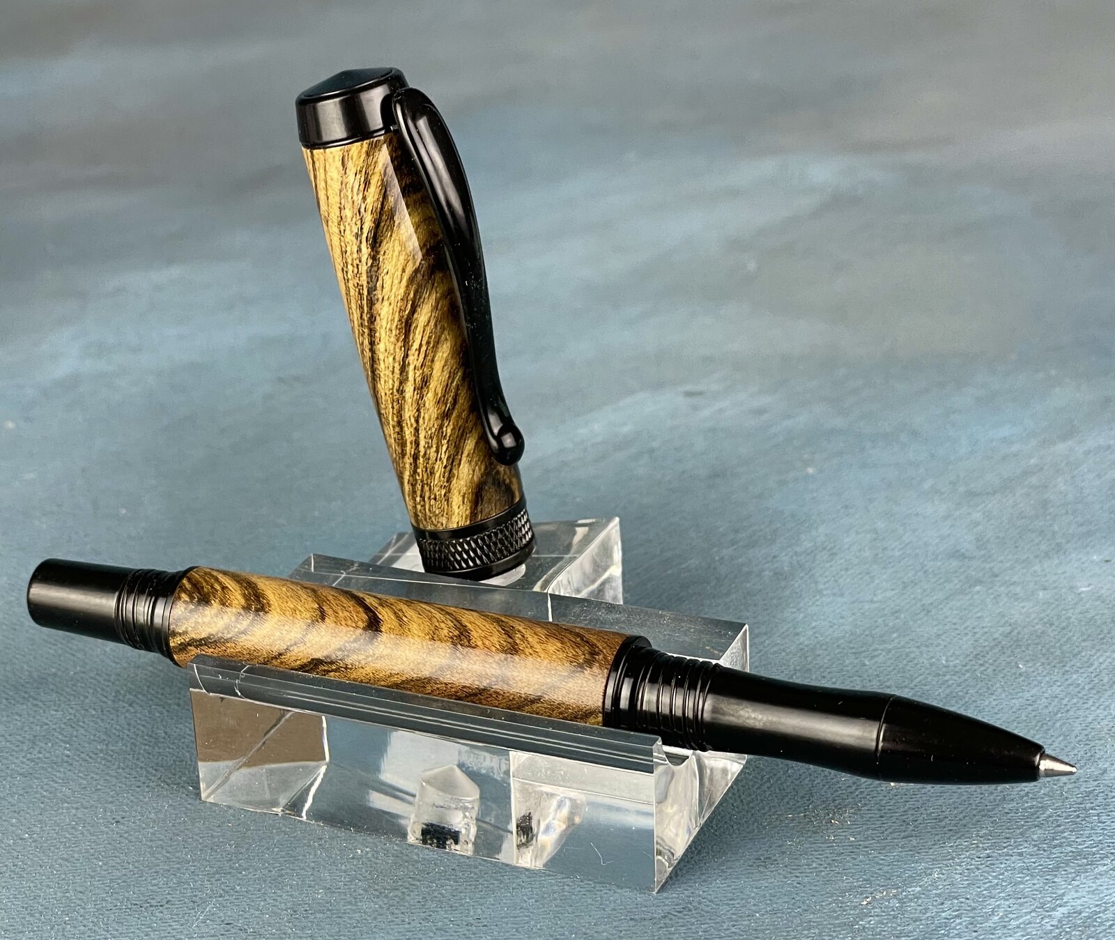

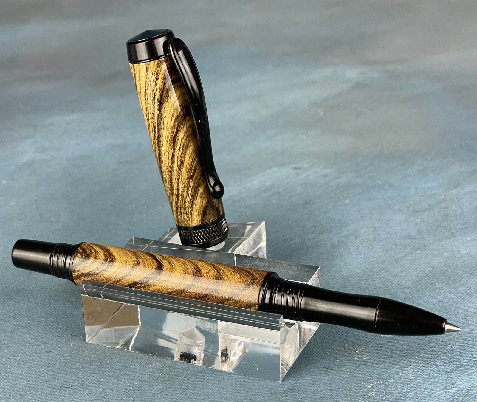

Task 1 - Finish a Diamond Knurl Rollerball in bocote. The blanks were tubed and sanded flush. As I turned the cap I heard a non- typical sound. It sounded hollow! I looked and the blank had separated from the tube on one end just a bit. Lemon! It could have been a catastrophic fail if I continued. I added CA, sprayed and went on with the pen body which was routine. After the cap cured I turned the remainder without issue. Whew!

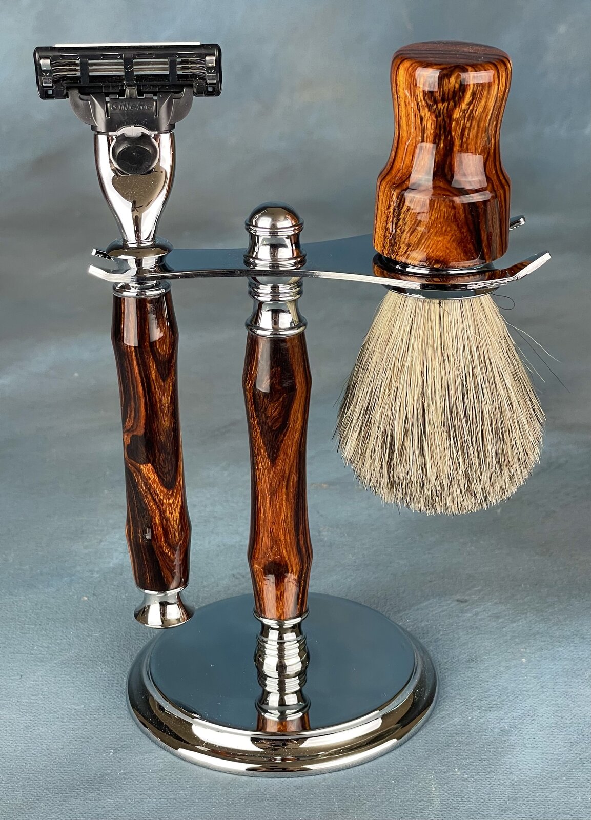

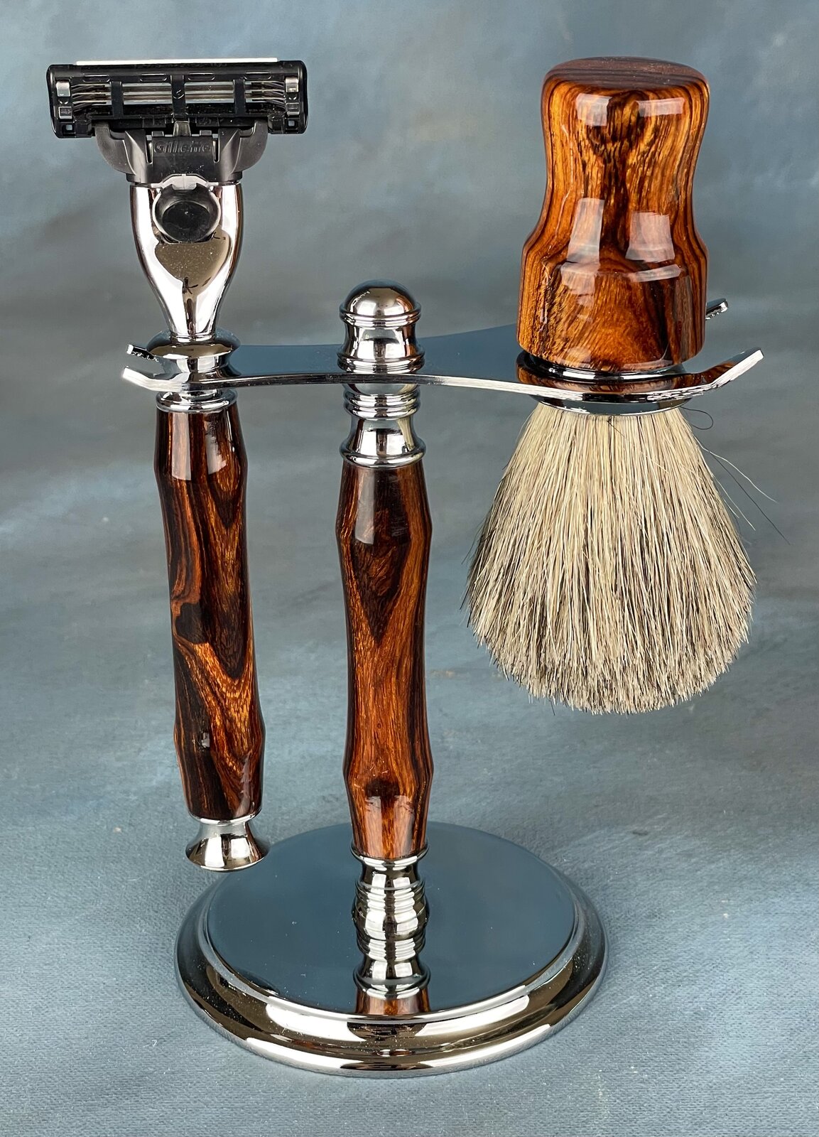

Task 2 - Shave set using desert Ironwood. I turned the brush handle first. All went well until a large chunk flew by me. The end away from the threads looked bad at first. Lemon! After very very careful turning I ended up with a very comfortable, though not typical handle. When turning the razor handle I again heard strange noises coming from the blank. Lemon! Upon inspection I saw voids that were a bit deep. Black rubberized CA to the rescue. That stuff takes a while to cure, but after it looked like the void was filled perfectly. It faces you in the photo and to me looks great.

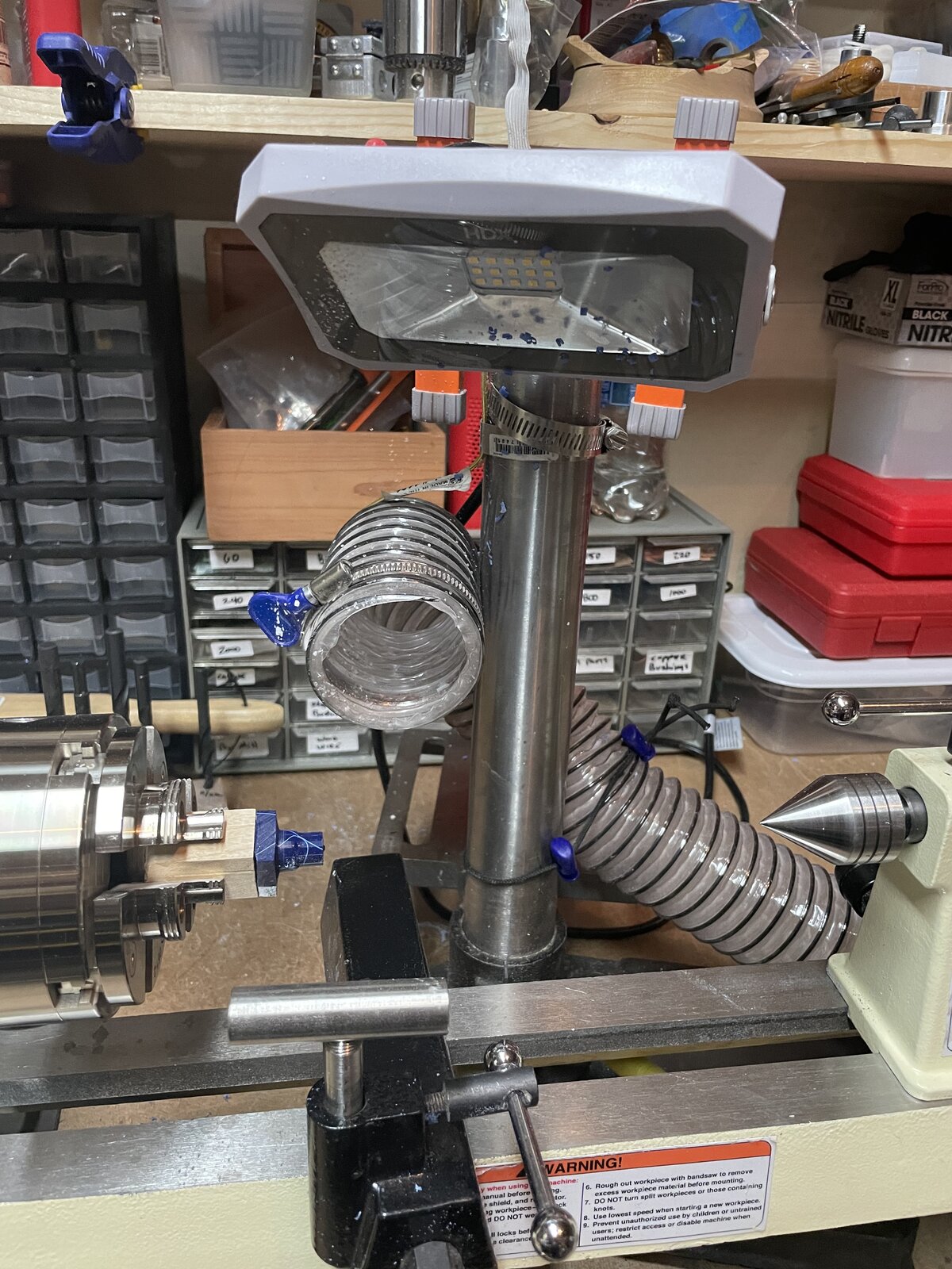

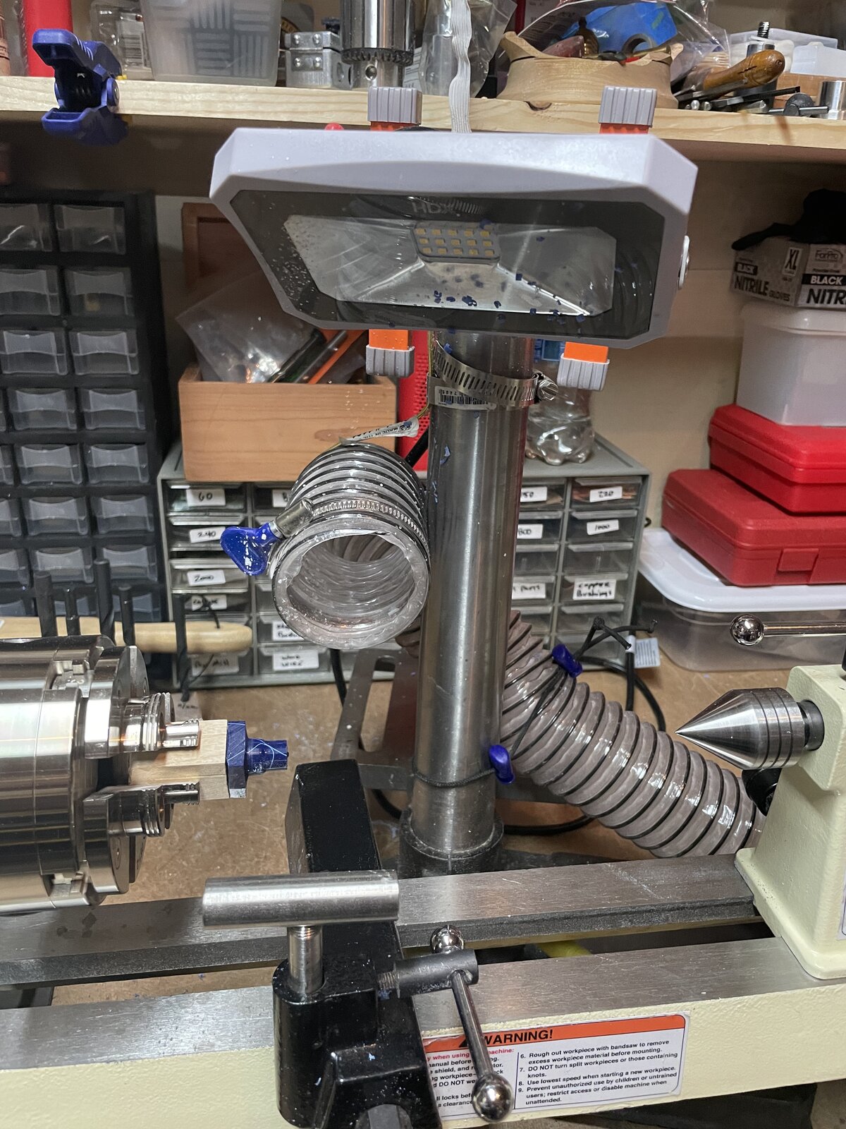

I had a lemons moment with shop equipment a couple weeks back. The cheap drill press if had for years finally bit the dust. I found a great deal on a 1957 Delta Rockwell drill press, so I snagged that.
Then, I pulled the stand off of it and used it to mount a work light and dust collection hose that I'm able to sit right behind my lathe. It works great!
