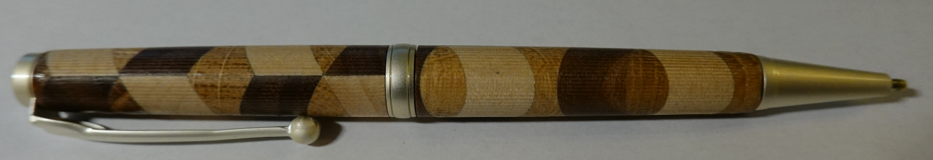

Here is one made from leftovers from a small box I made. The wood is walnut, oak, and maple.

Thank you for your kind words. I have to admit that it was not nearly as hard as the result makes believe - I assembled the pattern from wedges, glued together to a block, and I cut a makeshift pen blank from that.

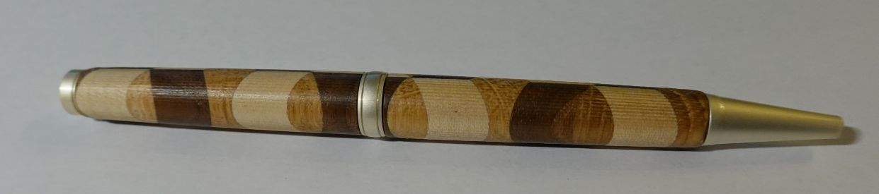

Ah, maybe I should have made it clear that the pattern does not wrap around the blank - here is what it looks like 90° around the pen:
Theoretically, it is of course possible to glue a blank that has the same "3D magic" pattern all around the pen. This challenge is on my list of things to do, and I have put some thought into it, but I have not quite untied the knot in my brain yet...

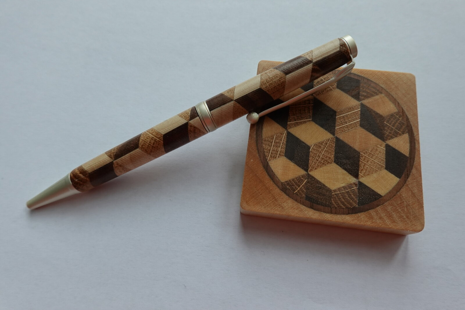

Here is another one with the pen in the open position (apologies for the bad focus at the ends):

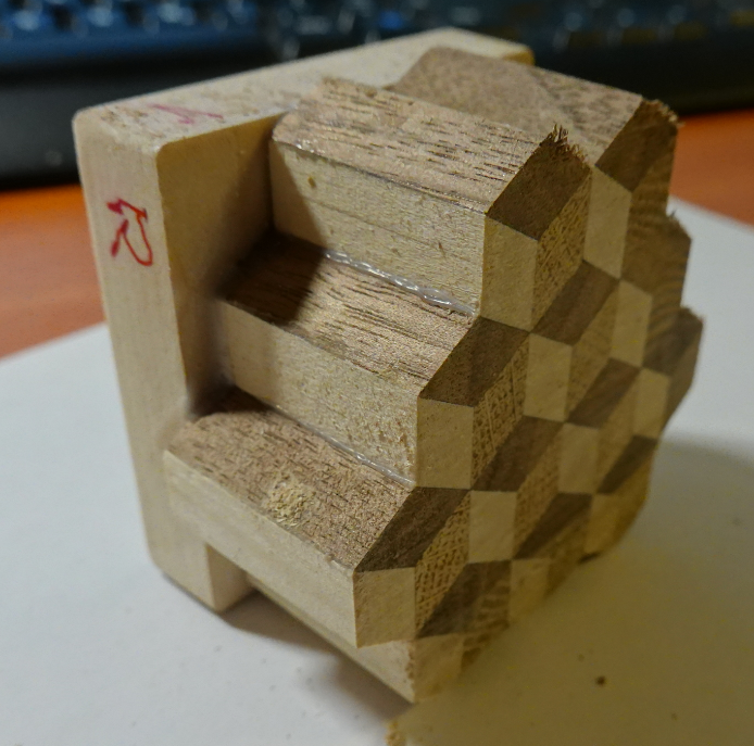

I have not taken any photos of the "blank" I used, but this is the block I cut it from:
It was originally about twice as thick as it is now (ignoring the base plate I used for glueing and workholding), and I cut off one slice for the box inlay, and a thicker one for the pen. I then cut the pen slice in two parts to make the two pieces for the pen from.
