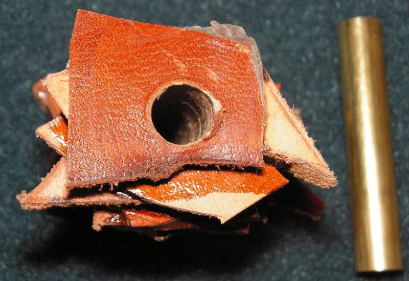

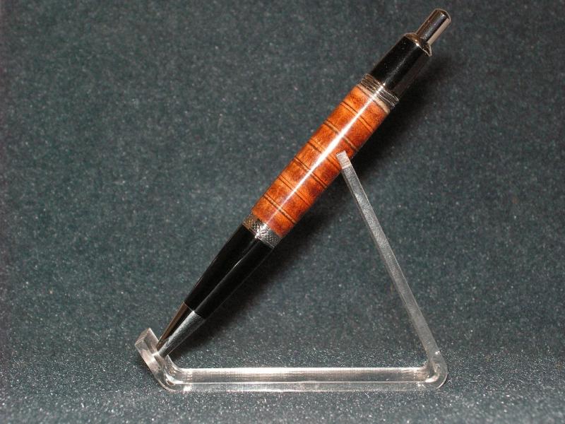

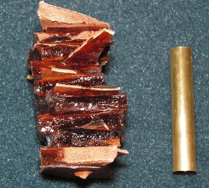

Here is the pen I promised Phillip I would finish and show the before and after of. I hope no one thought I was gonna start with a nice, pretty, and/or square blank. If so you are gonna be disapointed. :biggrin:

OK Landon, I'll bit.... I've worked with leather before, and your hole looks just about perfect through the blank... great job.... so... how'd you do it :)
an epoxy for glue?

I should have taken that pic as well, srry. I clamped it between 2 pieces of wood, put the whole thing in the PH vise. THe wood holds it square while also not allowing the bit to wander so much. That "gluey" mess is Med CA from Monty. (Lots of it) A SHARP bit also helps considerably. :wink:

Nice pen Landon!
I plan on trying one of those. I was thinking of taking a piece of pipe and sharpening it and figuring out a way to chuck it up on the DP and cut each piece individually.

Now, Landon, that's beautiful as well as amazing when you told me that you were going to do it I didn't think it would be this way. I was under the impression that you would wrap the leather around the tube then cast it and then turn it. This one looks very cool and thanks for contributing it to the chart i am sure you'll be getting lots of PMs about this one asking how you do it. it may not be a bad idea to prepare an tutorial for it. Of course, it would be all up to you. if you decide to do it then let me know and we put it under your pen in the chart (link).

That turned out very nice. We've made a number of leather pens in a similar fashion. We use a thinner leather simply because those were the scraps available to me. Rather than drilling out the blanks after gluing them up, I hammer out leather donuts using leather punches and glue them up on the tube using epoxy.
