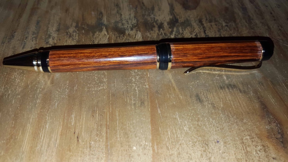

I'm still really novice at this, but I wanted to give CA finish a shot. This is both my first cigar pen as well as my first CA finish. It's a little messy (like at the far right, near the cap/clip), but it's a start. Went through a surprising amount of CA in making the pen, though.
I kind of did it trial and error style. I did a couple of coats of thin, sanded if I saw white mess, and repeated. Eventually I wet-micromeshed into oblivion. Anything I should try next time to improve things? Is it worth experimenting with activator when the thin CA dries so quickly?
I was really nervous to post this. Everybody else's pens look so professional, even people who are only posting their first pens! Also, I wasn't sure this shouldn't be in the finishing forum, since I fished for advice on CA.

A good CA finish does have a learning curve. Good job trying it. What type of wood is that?
When I first started doing CA finishes, I was going through it like crazy, gluing paper towels to myself, or to the piece. I've had to sand it off and back to bare wood a few times. But it does get easier the more you do it.
I no longer use paper towels to apply the CA, but use a 1" or so wide strip of 2mm thick white craft foam I got from Hobby Lobby. It almost acts like a little squeegee spreading the CA around on the pen. It always surprises me how much one little drop of thin CA can cover. The surface it leaves is a lot smoother than with paper towels and requires less sanding with 400.
I do use an aerosol activator, just a very quick blast maybe every 4 - 5 applications.
Don't hit yourself too hard. My first attempt at CA went surprisingly well, it was the next 10 that really went bad.:eek: It is a system that you have to figure out what works for you and the only way to do that is to keep doing it. My system works for me almost all the time now. I still have a hiccup every now and then. It looks like you may have sanded through the CA on the end there, hard to tell from the photo. Just keep doing it and it will come and improve over time. As for the craft foam someone else mentioned, I have it and have yet to use it, I need to try it.

Thanks for the response! I think the wood is cocobolo, but almost all of my blanks are hand-me down gifts from family to help get me started.

Your photo shows wicking effects on the ends of the tube. Which means the ends are not sealed and the 'wet' sanding you did put water into the blank. White spots is the results. It is how CA works in the presence of moisture. Use of a surface insensitive brand helps greatly with that and it is not from accelerator usage (providing you are using a real accelerator and not some garbage one)
White spots in CA is called BLOOM.
Q: What is blooming?
A: Blooming or frosting is a phenomenon that occurs when cyanoacrylate monomer volatilizes off a part, reacts with moisture in the surrounding environment, and falls back down on the part leaving a white powdery residue behind.
What should also be added is low odor or odorless is less likely to bloom as well. These are your higher quality CA types.
Answer to your accelerator question is yes get a good accelerator and use that; also yes it needs to be used on THIN as well. Consult the MSDS and if it contains acetone then toss it and move to another one. Acetone is very bad in the grand scheme of things when it comes to finishes. Also by using non-acetone based accelerators you are opening the door to more benefits, read added strength and flexibility. Remember the faster and hotter the polymerization happens the more brittle the end result will be. Also the faster the polymerization happens the more you will have uneven curing, which leads to the shattered glass effect.
The volume of CA required differs depending on what is needing to be done. The fail that most here engage in is the 'method' given only applies to thin layer protection and never sculpting or building up or filling in of low spots. In fact if you looked at most of the 'coat' methods you will quickly find it substantially sub-par for building up very low spots.
The second area that most fail to realize is that not all CA is equal. There are brand formula differences and then there are additives. This allows you to have better results in different areas that can be utilized to your benefit. Those benefits happen to be things like: not being forced to use the 'coat' method, using different techniques that brings out better performance or a longer lifespan. Consult the MSDS and call the manufacture and ask them directly and the first thing you will quickly see is what I stated is true.
