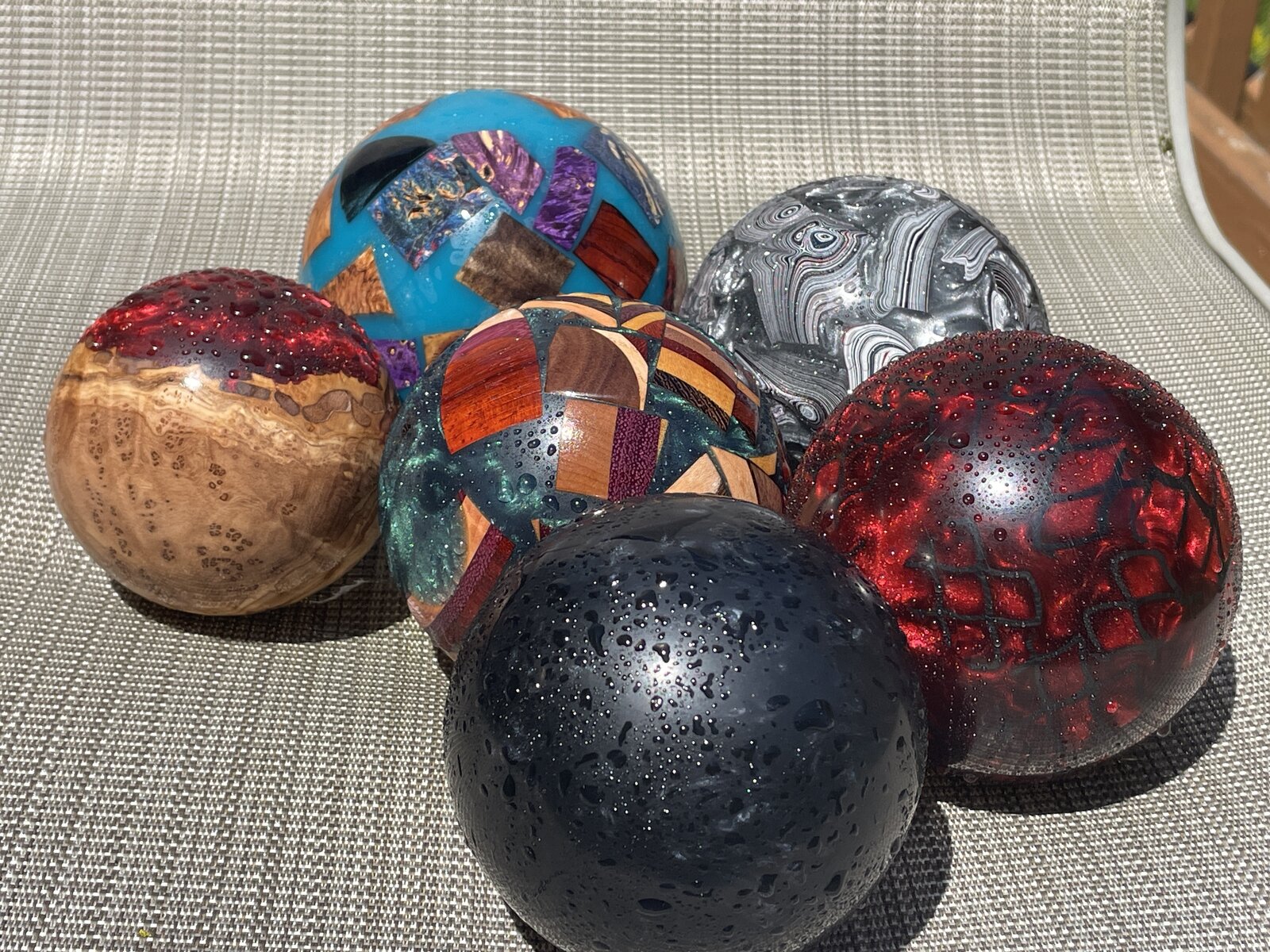

This has definitely been a learning experience and a refresher course in Math and spatial relationship. Started off with 4x4x4" cast hybrid blanks I made from various stuff around my shop (Olive Burl, Fordite, Cutting Board Scraps, Black 3d printed dragon scale, stabilized burl cutoffs). Then made a LOT of shavings with many mistakes and finally came up with these. Hardest part is sanding and finishing. I ended up sanding through as many grits as I could using self-made cup inserts in my headstock and tailstock. Then I used Zona paper and wet sanded them by hand while sitting on back deck in the sun with a beer!
Largest one is just under 4" in diameter and they weigh in at about 800 grams so are quite hefty.
Next, I will apply wax and buff them on my buffing wheels to get the final finish.
I learned that spheres are hard. Ovals - not so much.

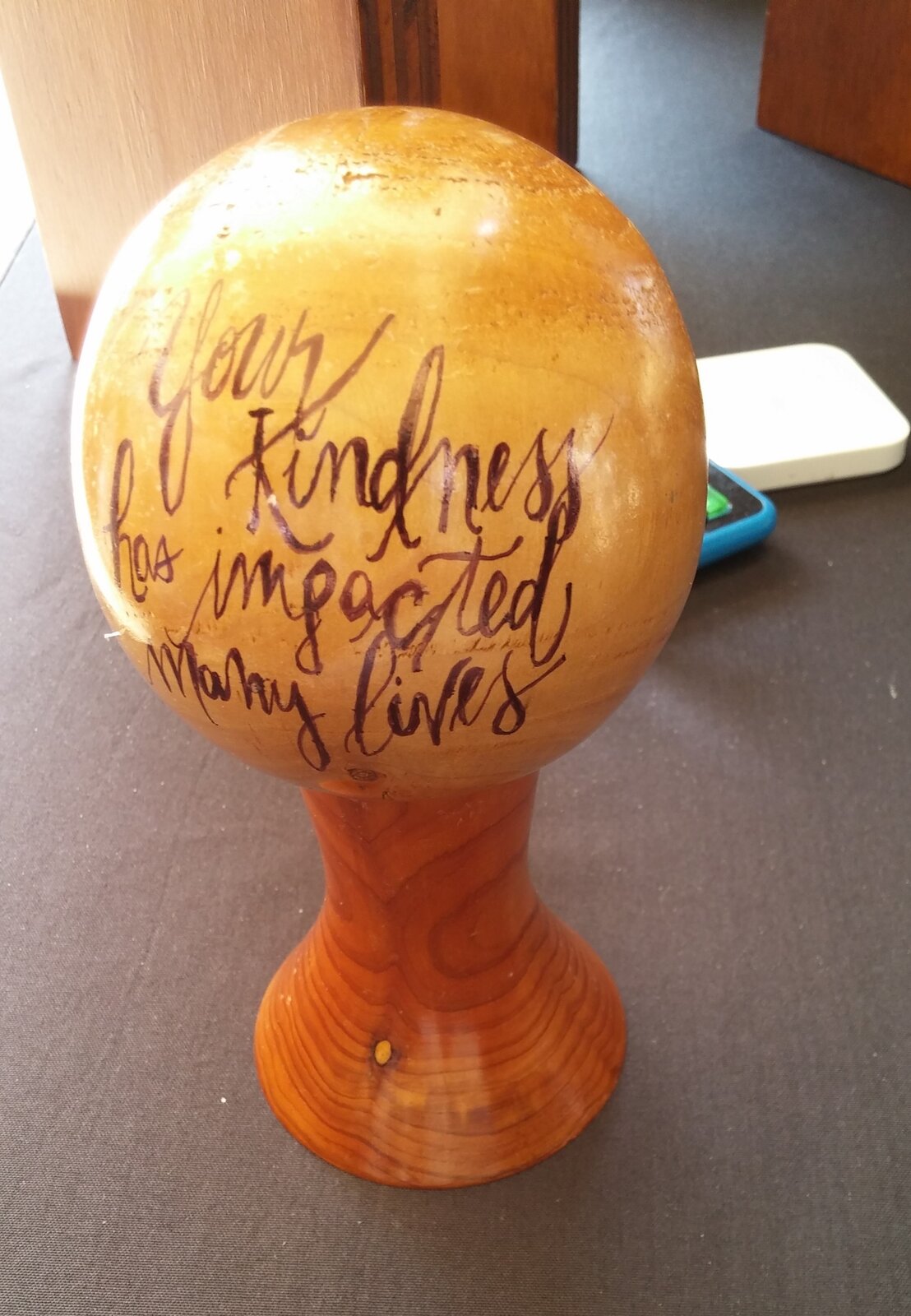

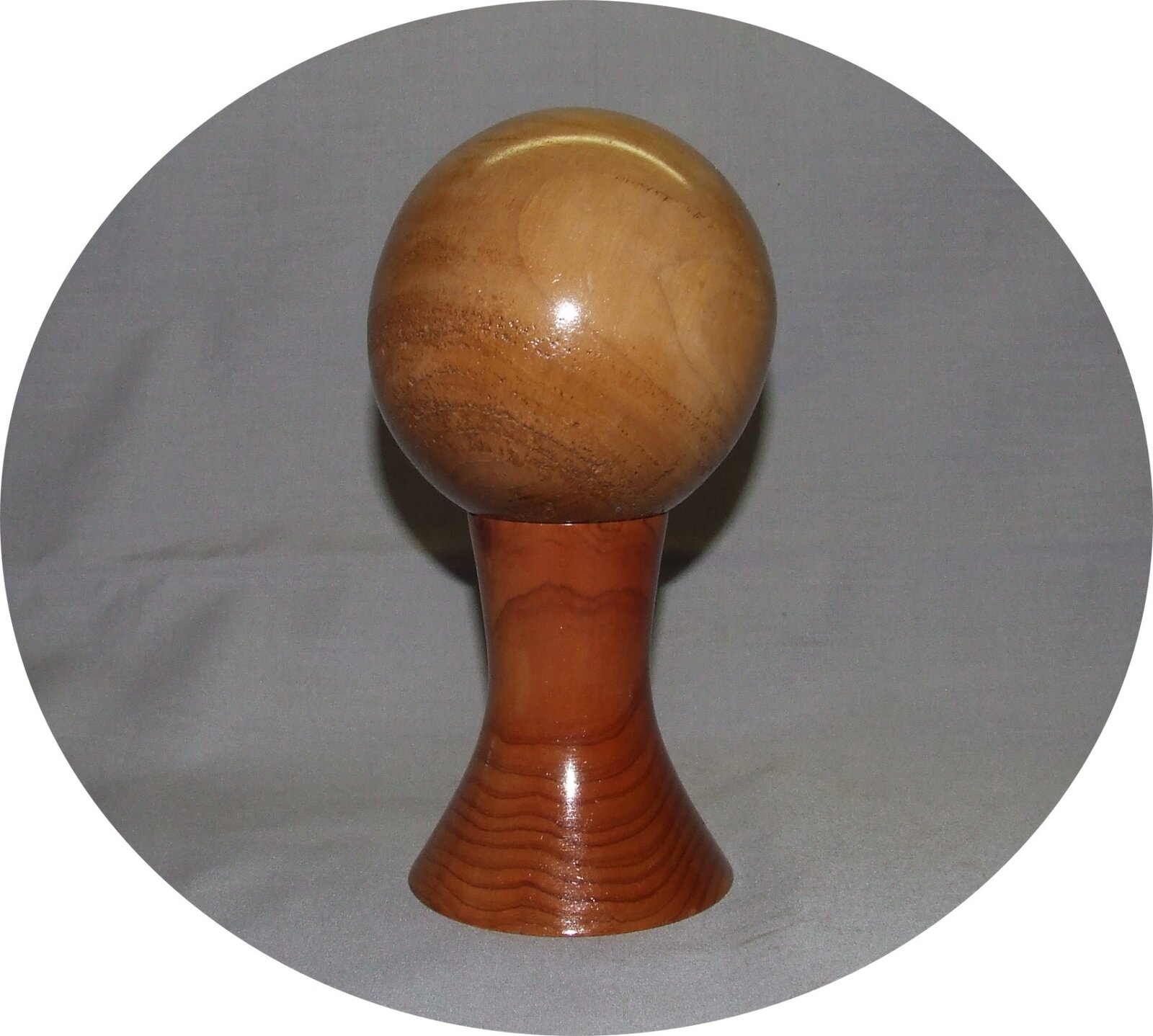

Great concept... I've only made one sphere and it was almost round... also turned a stand for it. A lady bought it and had it inked by another vendor who did pen and ink... she brought it back to me to show it off, where I took a picture of it.... I used Bradford Pear as the blank.
Not quite as impressive as your resin ones though.... was fun to make and got a number of good compliments at the market.
I used the same method you used, the turned cup at the headstock to hold it in place. Finish is my usual sanding sealer and wipe on poly.
This late date, don't remember exact dimensions, but think it was in range of 3 or 4 inches diameter.
Very, very nice work. I've turned ovals and " near balls" but as yet no spheres.
Differential sanding of resin vs timber would have been my worry but they look great.

Yes, the sanding is tricky. I did one day before last that was colored pencils in resin. That one is still kicking my butt. I used the cheap dollar store colored pencils and apparently the "lead" melts when you get it wet. So now I have a sphere with a bunch of little depressions after wet sanding. I may just try coating the entire thing in resin to finish it. Not sure yet.

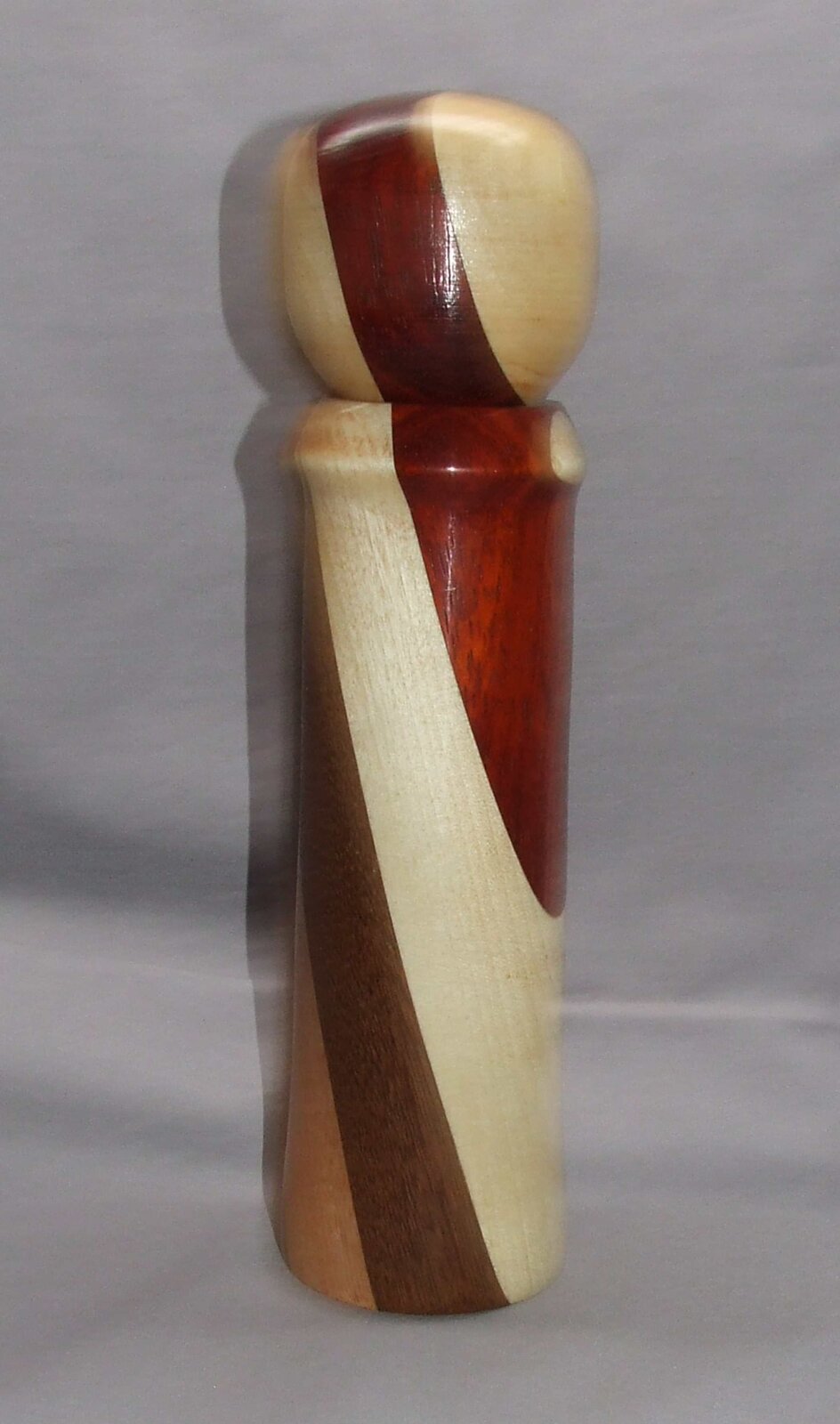

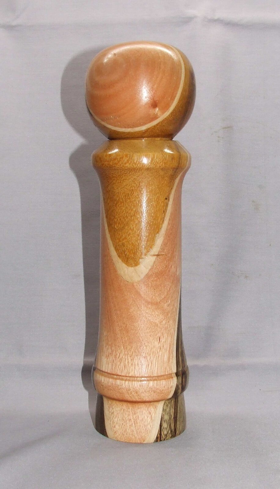

But I realized that I turn spheres a lot.... most of my pepper mill tops are spheres.
Sometimes they are actually round.
