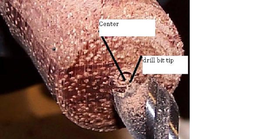

I have a Jet variable speed mini lathe and this is the problem I am having. I am wanting to drill using my lathe however I am having a problem with the drill bit centering up and when I start into the blanks it starts to wobble and and wants to drill out of center. I have tried three bits with the same results in the same place as well. The photo will explain more about what I am getting. I hope you masters can give me an answer on what to do. Its almost as if the machines tail stock was not machined right dropping it down on one side. Has anyone else had this issue and what in the world can i do? Thank you

All sorts of possibilities here. Pretty difficult to diagnose the problem from long distance.
Don't automatically eliminate the HS as a source of the problem. It might be that the scroll chuck (for any number of reasons) is not perfectly centering the blank.
I would check the TS quill to be sure it is absolutely clean before inserting the drill chuck. A tiny fragment of wood chip could cause the chuck to not seat accurately.
You might try drilling a centering hole in your blank using a small bit (maybe 1/8" dia.) to a depth of a half inch or a little less. Then install your brad point bit. With the lathe off, slide the TS up to the blank and align the tip of the bit as close as you can to the hole in the blank and then clamp the TS in position. The tip of the drill bit should be as close to the blank as possible without actually touching it. Turn on your lathe and set the speed to about 1500-2000 RPMs. Drill away and let us know what happens.

It sounds to me that you have two things going here. First, I'll bet the drill bits you're using are "jobber" length. These are the most common and they are fairly long. Because of their length they tend to "flex". The simplest way around this is first: Insert them ALL the way in the chuck to reduce their length and second: Get yourself a set of these http://tinyurl.com/6ccotu
I use center drills EVERY time I drill on the lathe.
After you drill a center hole, if you're drilling a hole any larger than 1/4", do it in stages. For a 1/2" hole I use 3/16", 5/16" or 3/8" and then 1/2".
I also highly recommend "screw machine" length drill bits. These are about 1/3 shorter than jobber length and I use them almost exclusively on the lathe. Cut your blank in two before you drill and you won't need a long bit.
I also use these (can you tell I don't like off center holes?:biggrin:) http://tinyurl.com/6lp2ut
I bought these for drilling casings but now I use them on everything. A set of four, 1/4", 5/16", 3/8" and 1/2" will serve you well for making pens and you can get all four for $20.
At the very least try some center drills before you go spending money on new lathe parts.:wink:
Also, 1500-2000 rpm's is WAY too fast. 500-750 rpm's is where you want to be.
I also agree that you should tighten your tailstock lock slightly. Not so tight that it's difficult to move but you'll be able to tell when you have a slight drag on it and the slop is removed.

Joe; I would not use a brad point bit. Tried them but didn't like the results.
The suggestion to drill in stages and use a centering bit are good ones for larger drill sizes. I would also mention that drill bits intended for metal tend to be better quality and more aggressive in cut. Drill bits also need to be sharpened from time to time.
The easiest way to check the lathe is to put a center in the headstock and bring the tail stock center up to it. When clamped, the two points should meet *EXACTLY* point to point. Then back off the tailstock and use the hand wheel to extend as far as possible. Bring the points together again. They should still meet EXACTLY point to point. This can also cause out of round mandrel alignment problems.
Metal lathes have a side to side adjustment on the tail stock so the tail stock is aligned with the head stock.

Looks like the tail stock is not centered and the deviation from the true center is 1/2 of the little hole where the brad point bit is making a donut.
While you want slack out of the tail stock lock so it does not rattle around, it needs to be loose enough that the drill bit point will move the tailstock to self center. My jet midi has a few 1/16th of play and I have not spent the time fitting shims to make it more true.
This is not intuitive -- and the assumption that the tailstock is aligned with the headstock is probably not true unless you have specifically made it so. Probably close enough for wood work, but not if you lever down on the tail stock so it cannot move to find center.
P.S. Vertical alignment is the tough one -- lateral will work out with the side to side movement of a snug but movable tailstock.

Joe: If you put a dead centre in the head stock and a live centre in the tail stock, then lock down the tail stock and advice the live centre, does it line up with the dead centre?
Snorton20
Jun 18, 2008
188
fredericksburg, va, USA.
Yes, they line up. Also I did shift the tailstock to one side and this helped a little. Thanks to all that gave there input. I hope I get to do my first seg soon. Believe you me, you all will be the first one to see. Thanks again
