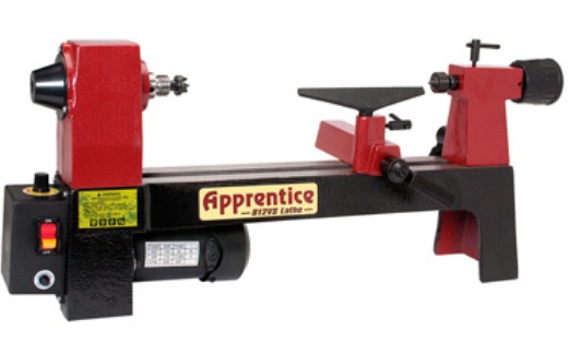

My daughter JUST bought me a new lathe yesterday. Got it at harborfreight, a discontinued "out of box" model called
central machinery 8 x 12 mini woodworking lathe.
Here's a picture I plucked off the web.
https://images-na.ssl-images-amazon.com/images/I/71zL5RqPKqL._SL1200_.jpg
Now… can't beat the price. Just over 30.00. But I quickly found out it's missing some parts.
Comes with the big 8" wheel as pictured here, but it's also suppose to come with a smaller one. I don't have that. Now I might not even need it for pen turning would I?????
It also was suppose to come with a flat wrench to tighten that wheel with. NO wrench I own will fit. A youtube video I found also showed some long rods with nice handles. (I used a screw driver to insert in one of the holes to hold the nut thing so you can tighten up the disk. but since we don't really have a tool to tighten it well, not even going to try to use that.
If anyone knows where I might pick up these parts please let me know.

To answer your questions we need to know a bit more about your lathe.
When you take off that big disc on the left (headstock side) there will be a threaded spindle.
We need to know the thread size on the spindle ... commonly 1" by 8 turns per inch (TPI).
When you look into the end of the spindle, there will be a tapered hole. We need to know the specifications of that taper ... commonly MT#1 or MT#2.
MT means Morse Taper and I would guess that your lathe has MT#1 taper both on the headstock end and the other end (tailstock).
If that is correct then the mandrel you referenced would fit in your headstock, but the taper size needs confirmation.
Did you get a manual with the lathe ?
Do you know the model number of the lathe ? (should be on a stick-on label on the side of the lathe or its motor).
I did a google search for SL1200 and did not come up with anything that looks like your picture.
Please give us some of this info and we can help you more.

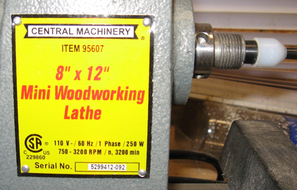

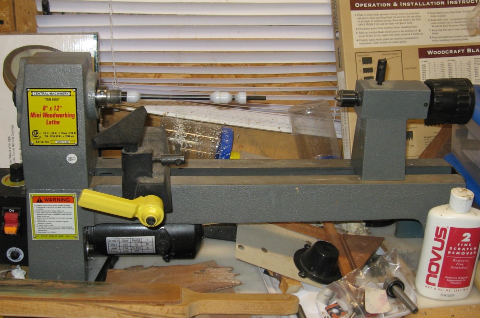

Hi Jen,
Welcome to the forum. If your lathe looks the attached picture it's a central Machinery Model #95607. Here's a link to the manual ->
http://manuals.harborfreight.com/manuals/95000-95999/95607.pdf
The round plate is called a faceplate and it is used to mount bowl blanks. Sounds like you'll need a knock out bar for a pen mandrel. This model uses a Morse Taper #1 for both head and tail stock.

I have that lathe ...
The spindle size is 3/4 x 16 (you can find 3/4" nuts with that thread size and pitch easily enough to make your own faceplates). (fixed, thx Mal!)
The small "wheel" you describe is a faceplate. As I just mentioned, making your own is fairly simple if you have the correct nut size to fit the spindle.
Countersink a nut into a block of wood or squared off section of a board, epoxy it in place, turn it true and you're good to go. You can use it as a glue block style mounting system or you can put screws through it to secure your blank like a traditional face plate. The missing small one won't cause you any issues in pen turning. It"s for small bowls, platters, goblets, and lidded boxes.
Other things of note ... headstock and tailstock have a #1 morse taper. Harbor Freight only has 1 #1 MT accessory of note that you might want ... it's a 3-jaw scrolling jaw mini chuck (uses tommy bars to tighten and loosen). It's fairly well made, but it's made for their METAL TURNING lathe, so it doesn't have a dovetail on the jaws. It still works extremely well for drilling already round stock, cutting to length, ect ... and for 30 dollars it's a steal of a deal. Second best I've seen was from PSI for over 55 dollars.
Doesn't come with any turning tools ... just a faceplate wrench to fit the faceplates and another wrench that you won't see any apparrent use for (fits the REVERSE THREADED NUT that is INSIDE THE HEADSTOCK). Don't worry about it, just save it someplace safe till you think you may need it someday. Also comes with #1MT dead center (spur center) and live center (cup center with a center spur). If you're missing the knockout bar, it's pretty simple to make one yourself out of 5/8" steel rod and any old chunk of wood turned between centers for the handle.
Drilling on this lathe works pretty well even without a drill chuck (I get mine from PSI ... great deal and they have them in #1MT), if you haven't got one you can grip your round blank in that 3-jaw chuck I mentioned earlier and hold your bit in a pair of vice grips or make a custom handle for your drill bit the same way you would for that knockout bar.
(I recently removed that nut and created a faceplate ... re-mounted it on the back of the headstock and turned it down. Makes a great handwheel.)
I hear that the tailstock and banjo (toolrest) lockdown arrangements can sometimes use some tweaking so that they don't slip around on you... Make sure you keep the lathe bed properly clean (it's not stainless steel, more like cast iron ... IT WILL RUST IF YOU LEAVE WATER ON IT). Waxing your lathe bed can help with rust prevention, especially if you do wet sanding for finishing work like I do.
The motor is directly under the lathe bed ... it seems to be a bad place on first examination, as shavings and dust will naturally fall right down past the air intake for cooling. Make sure you keep that intake clear by cleaning it off now and then ... there IS an internal filter to prevent shavings and dust from getting into the motor itself, but I doubt it will like anything liquid.
Make sure your lathe is sitting level. I've found that I do NOT have to bolt my lathe down, but I do have to be careful of how fast I'm spinning a blank that is out of balance because my lathe isn't secured .... it can walk around on my table top if I'm not careful.
All in all, I spend 108 dollars after tax, using a 25% off coupon to buy my lathe, and I'm very happy with it. Treat yours right and you should be quite happy with it too!
(Take a file and sandpaper to the top edge of the toolrests to make them smooth, by the way ... There should be 2 of them, one short and one long. Don't forget to wax them too, to give your tools smooth movement!)
Speaking of tools - Harbor Freight has an 8-pack of common lathe tools that does the job decently well. They are NOT SHARP out of the box ... get yourself a grinder setup or a sander to put a decent edge on these before you get down to business. Remember what I said about making your own faceplates? Do up several and attach different grits of sandpaper on them ... now you have a variable speed sanding station you can use to put a custom edge on your tools!
On the very END of the lathe (past the tailstock) there is a small piece of plastic held in place with 2 screws .... this is just a stopper to keep the tailstock and banjo from sliding off the ways. Perfectly safe to remove this thing so that you can take your tailstock and toolrest banjo off the lathe bed for cleaning, tweaking, ect... in fact, I lost mine somewhere and really don't care! :)

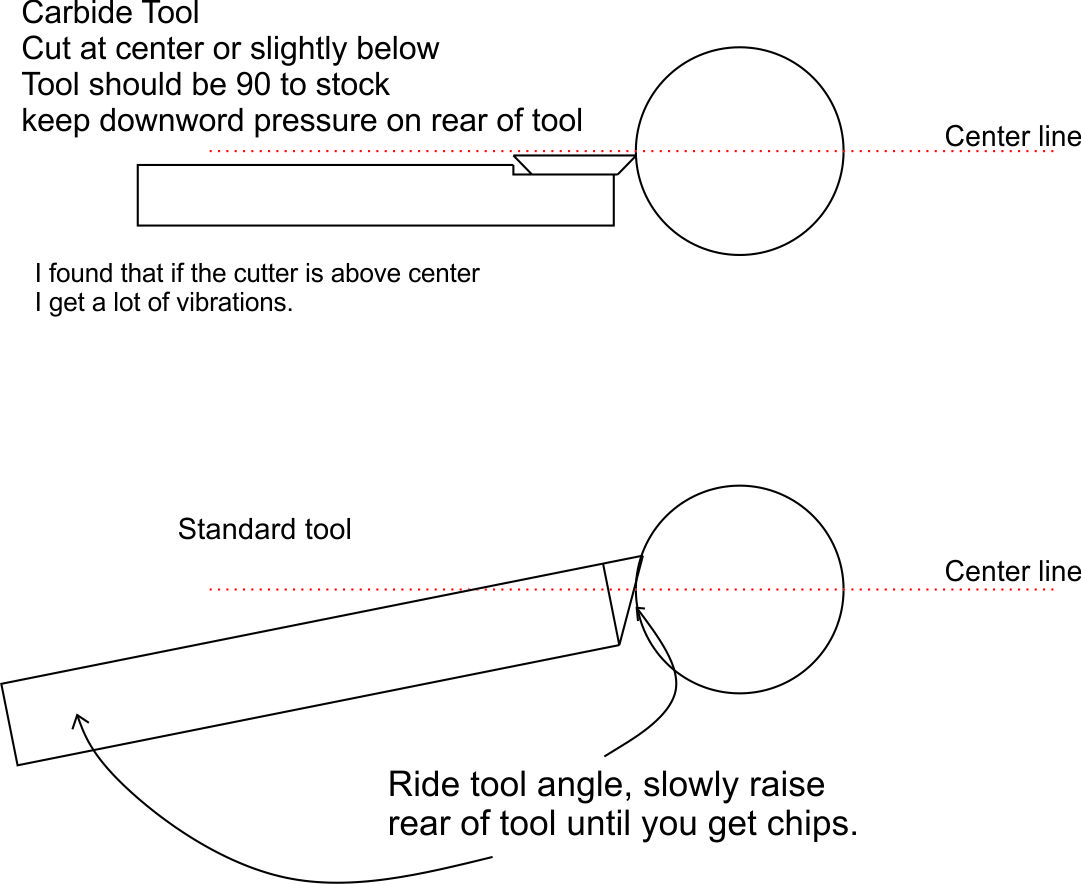

Anyone have tips on just what angle to hold the cutting tool? I'll go hit up youtube and see if I can find something. Or post a link if you have or know of a good one.
Maybe this will help, it is what I have figured out, may or may not be completely correct according to the masters, but it is what works for me, I get nice long strings off the plastic blanks so I think I'm doing something right :) but will be interesting to hear what works better for others, I'll try it. :smile-big:

OK ... this is pretty much our lathe. It's being marketed under a new name, same manufacturer, nearly 100% identical stats, and twice the price with a 5 year warranty.
The long black part on the bottom that includes the legs ... this is the ways, or lathe bed.
The red part on the left is the headstock, the black part on the back of it is where I have my handwheel, but that was custom made.
Sticking out the front of the headstock is the spindle shaft, you can see the threads on the spindle. The model shown has a 1" x 8 spindle thread, ours is a 3/4" x 16, and this is pretty much the major difference between ours and this new version. Installed in the headstock spindle is the spur center.
In the black cover on the back, there is a hole you use to place the knockout bar into the back side of the spindle to remove a morse taper accessory by tapping it out.
The toolrest banjo with wide toolrest on top of it is out in the middle of the lathe bed.
The red part on the right side is the tailstock. The part that's pointed and sticking out on the left side of it is the live center, which is inserted into the tailstock quill.
The black thing on top is the quill lock, which you can tighten down when you do not want the quill to move around. Leave this loose enough for easy movement when you are drilling or adjusting the tailstock pressure ...
The knob on the right is the tailstock "handwheel" ... which is a knob for this model. It's hollow, and has a hole running through it right up to the back of the live center. Use a knockout bar here as well to tap out morse taper accessories.
The handle attached to the toolrest banjo and the tailstock can be adjusted ... simply lock the item into position where desired or for convenience, and then PULL the handle directly away from it's attachment point about a half inch or so ... then you can freely rotate the handle to any desired position. Release the handle - it's spring loaded so it will return to a normal position.

Got another question, trying to get parts to drill blanks. woodturningz asked what the thread count is on my lathe. And suggested this part.
Spindle
Adapter, LA3418X
Here, direct link Internal Spindle Adapter - WoodTurningz
But he also sent me to another part using a #2 morse taper. I KNOW mine is a #1 because I already bought the mandrel and it's a #1. But he doesn't know and neither do I if I need this adapter or not. All he could find was a PDF file of the manual and wow, it's not even mentioned in there.
So before I order, then have to return, or not order than have to pay another shipping charge, thought I'd hit you folks up again. SOMEONE out there must have the same lathe as mine and know.
The Harbor Freight Mini Wood Lathe 8x12 has a #1 Morse Taper for headstock and tailstock, and a 3/4" x 16 tpi threaded spindle.
If you have an accessory (like a chuck for your lathe) that takes a 1" x 8 tpi threaded connection, then the spindle adapter would be a good idea so that you can attach it to your lathe. (Personally, while you really only NEED to have one of them ... they're reasonably cheap, get one for each accessory!)
