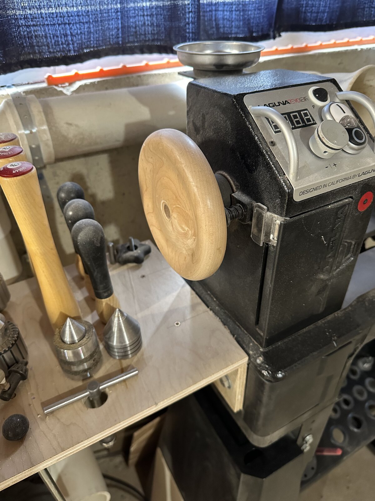

Yes the Laguna handwheel sucks, I made my own.
