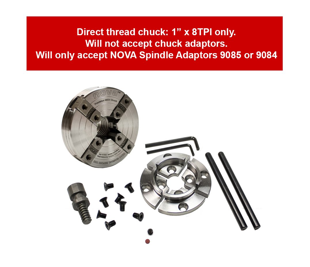

Hi All,
Since I'm getting back in to turning abit on a budget, I was looking at pricing for the chuck for the lathe, I usually always buy a Nova G3, However I see they now have this one.
Nova Select Precision Midi DIRECT THREAD 1″ X 8TPI.
Its a smaller in thickness but takes all the same jaws, they say recommended for up to a 12" swing. I will be putting this on a Nova Comet II and doing mostly pens, rings and trying to learn small bowl turning.
ANYONE have exp with this chuck? Its close to 60 less then the g3 lite once I figure in the Spindle adapter as well.

I have 2 of the Nova Select Precision Midi chucks they work but the Nova G3 (I have several) work better. It is simpler to attach stock & I think it has a stronger grip ... just my opinion. Every now & then someone is selling a G3 on the market place.

Looking at it, noticed it uses the 2 handle method of their original chucks, I am just going to go with the tried and true G3 :Lite.

I don't have this particular one but I have one that is similar.
It has the two handles to loosen or tighten the chuck but this can be challenging when the part being turned needs to be held as well - you sometimes need three hands. Or bring up the tailstock to help hold it.
Other chucks that have the single hex or star handle are much nicer in my opinion.
