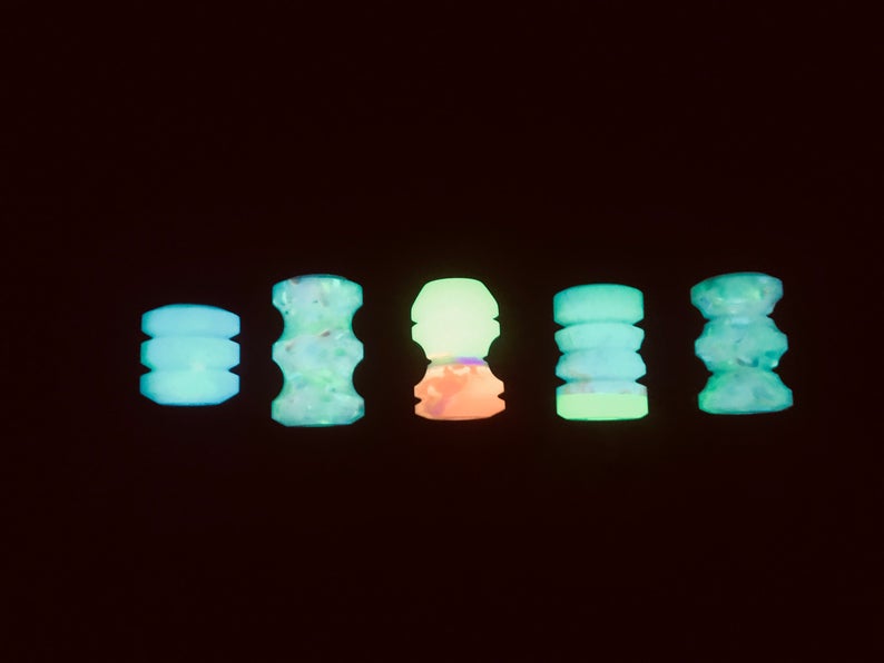

While I'm not new to woodworking, I have never tried turning. My other big hobby is knives, and a lot of guys have lanyard beads and pulls. Many are made from metal, but occasionally you see them in other materials. I'd like to make some in natural materials such as wood and bone. As I'm new to turning, and I would appreciate input on what beginner lathe you would recommend, and what cutting tools you would recommend I buy.
I've attached some reference pictures for anyone who hasn't seen these before, they are typically about 1" long and 1/2" in diameter.

Any lathe will make the small beads in your photos. That is also true for making pens. Any lathe at all.
The decision of which lathe to buy depends on what else you may want to make with it. Bowls, pepper grinders, handles for kitchen tools (ice cream scoops, bottle openers, etc.) are other popular objects that people make on lathes. That's the tip of the iceberg to get your thinking started. There are so many other things you can make with a lathe. Do a web search and you will be amazed at what woodturners do.
