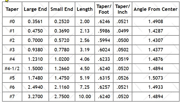

Morse tapers were originally developed in the mid-19th century at a machine shop in New Bedford, Massachusetts. Subsequently, they have been incorporated into international standards (ISO 296) and should therefore be universal. So I don't think that you need to worry about compatibility of Morse tapers between brands of lathes as long as the manufacturers clearly state that the headstock and tailstock are Morse tapers.
Here is a table that shows the dimensions of the various Morse tapers.
There are several other taper schemes used in the machine tool industry. The one that turners are most likely to encounter is the Jacobs taper - it is commonly used to attach chucks on drill presses, and is also frequently used to attach a Jacobs chuck body to an arbor, where the arbor has a Morse taper at the opposite end for mounting on a lathe.
