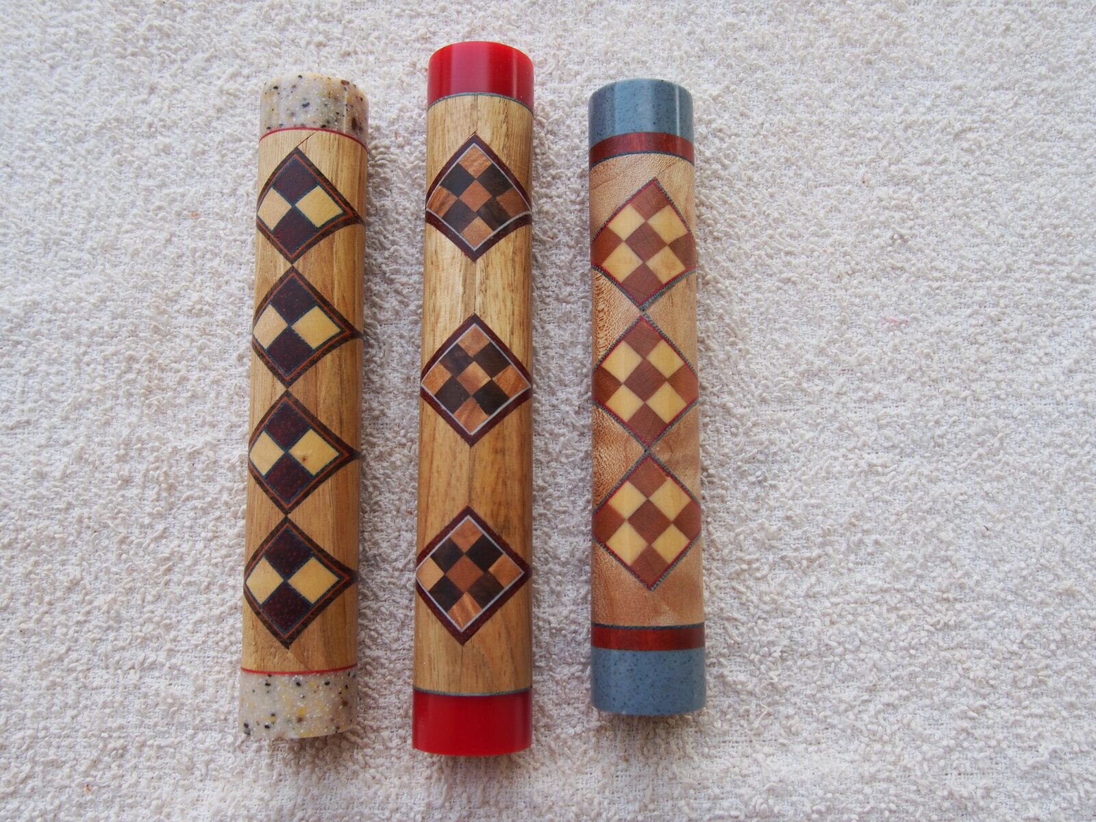

Here are ten of my latest segmented pen blanks that I have constructed in the past few months during the virus stay at home time. They are made of wood, veneer and acrylic material. The patterns are brick, herringbone, celtic knot, square inserts , reversed spiral and two unnamed others. Comments are welcome.

I made 3 blanks with the square inserts , one blank with four piece square inserts and two blanks with 9 piece square inserts. The most difficult part for me was cutting those small sticks and gluing them together maintaining squareness.
Also constructed 6 , all a little different , of scalloped blanks . The scallops are cut/glued on both ends of a square blank , then the blank is cut in half , rotated end to end and glued back together with different center configurations . I am using wood and the beautiful acrylic material , which cuts/sands easy and polishes with steelwool. One of the blanks is made with drilling two circles , turning the same size dowels
and then gluing together.

Thanks Mark. The window pane blank has about seven layers of different colored veneer around the pane ....I think it kind of makes the pane jump out !!! Fun Fun Fun !!!!!!!!
