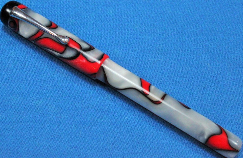

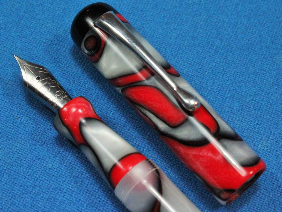

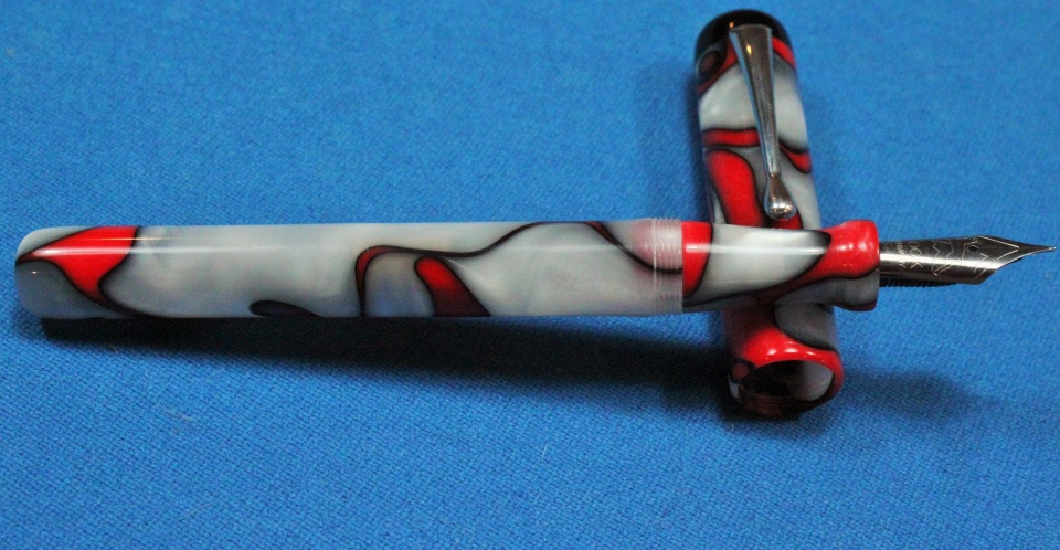

Here is another kitless pen. I tried using a plain color on the cap to hopefully calm down an otherwise wild blank. I'd be interested to know if anyone thinks it did or didn't work. Pen is 6 1/2" long closed and pen body is around 5 1/2" long alone. Body to cap has 14mm threads and section to body has 9mm X .75 threads. Has a fine bock nib. Comments always welcome.
Jeff.

Personally, I would have matched the cap to the body. Then again, if the front section was black I might have used a black cap. Just my 2 cents :biggrin:
Personally I think a matching cap finial would look better and then use a black section. Or if you did the same black end on the body of the pen. I totally agree the blank needed a break. 6 1/2" is pretty long. Does the cap post? I like your shape and how well it flows. The recessed clip is perfect. Well done.
I'm in the matching cap and section crowd. I see your point in doing the cap...looks good, but it seems a little lost. Over all...well done!!
Thank you everyone for your feedback. I have a confession. In the middle of making the pen I thought "I should add some solid black somewere". At that point I was already done turning the body, section, and all but the top of the cap. So the only thing I could add black to was the top of the cap. Now for the next pen I will definitely make some of those plans a little sooner. Thanks again for the feedback and listening to an airheaded penturner:glasses-nerdy:
The cap doesn't post. I got a little too carried away on letting the metal lathe make the body straight. When I went to clean up the back and finish it the body was already too small to hold the cap on the back.... live and learn. I gotta learn how to plan my pen builds a little better. This is getting ridiculous. Thanks for the feedback.

What a Pen, Jeff, That is one that will really "Stand Out from the Crowd"
Considering where you were at, when you decided to "Tone it Down".
I don't think you could have done any better.
You have Great Lines, Terrific Proportions, which have given you a Magnificent Profile.
Excellent Fit and Finish.
Congratulations,
Brian.
