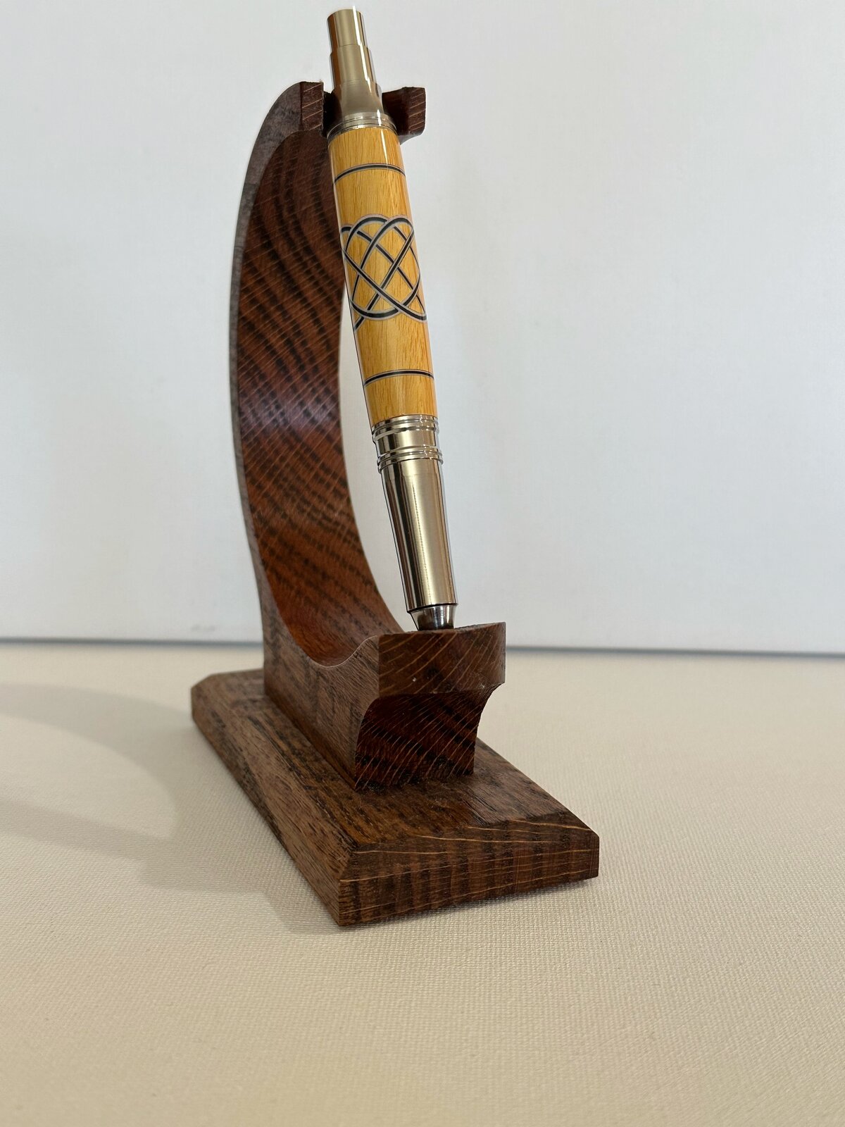

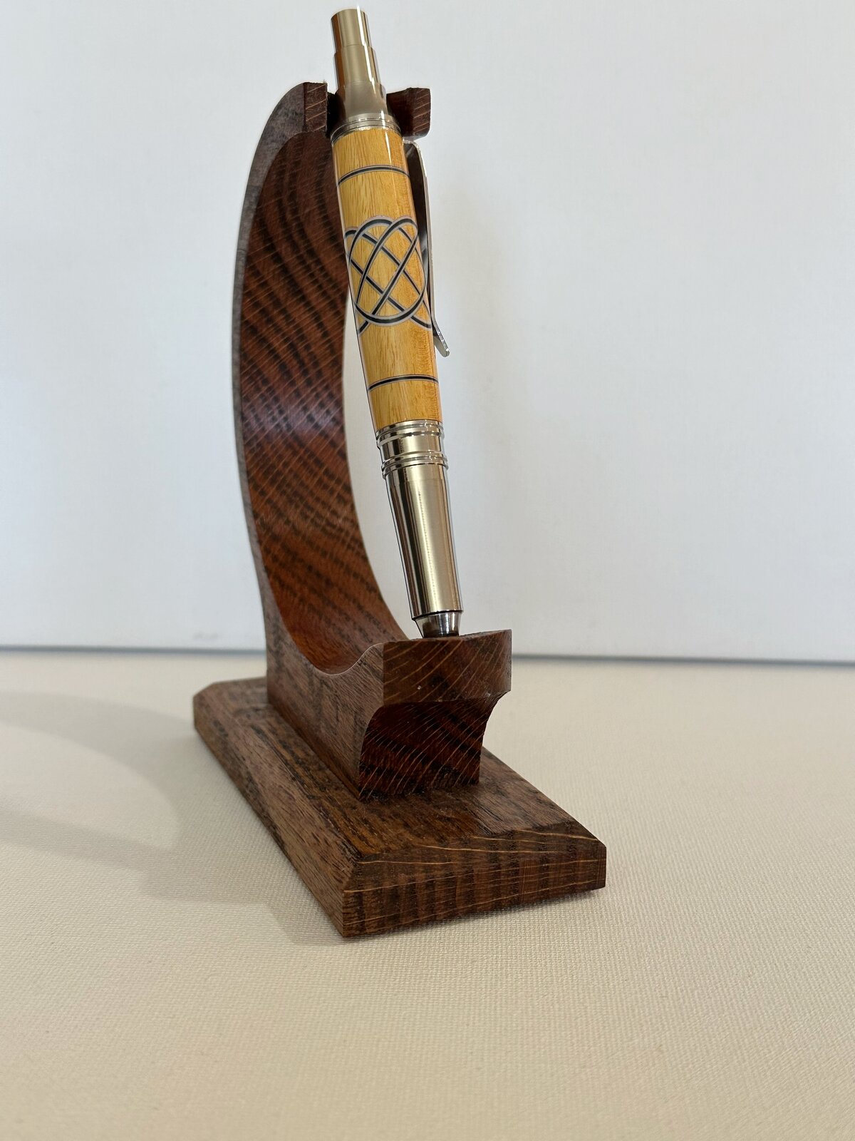

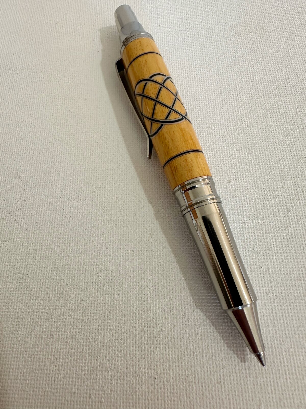

Made a small tweak to my 6 sided knot jig. As I've posted before I cut these based on locator holes. I drilled this blank and measured each location. The total variance was only .006. These are now very easy to make. Wood is Osage Orange, Three layer vulcanized fiber paper infill. Infill is .044, knot angle is 55°. Pen is a Liberty click.

the precise nature of that really catches the eye Ken. Great work

nice knot! I appreciate you told us the cut angle. That is way to often left out of descriptions. Pens are usually 45, unless they aren't 😖 Bottle stoppers are rarely 45...I don't want to make tiny knots.
I've never been a fan of the knots cut at 45°. I have settled in at 55°.
