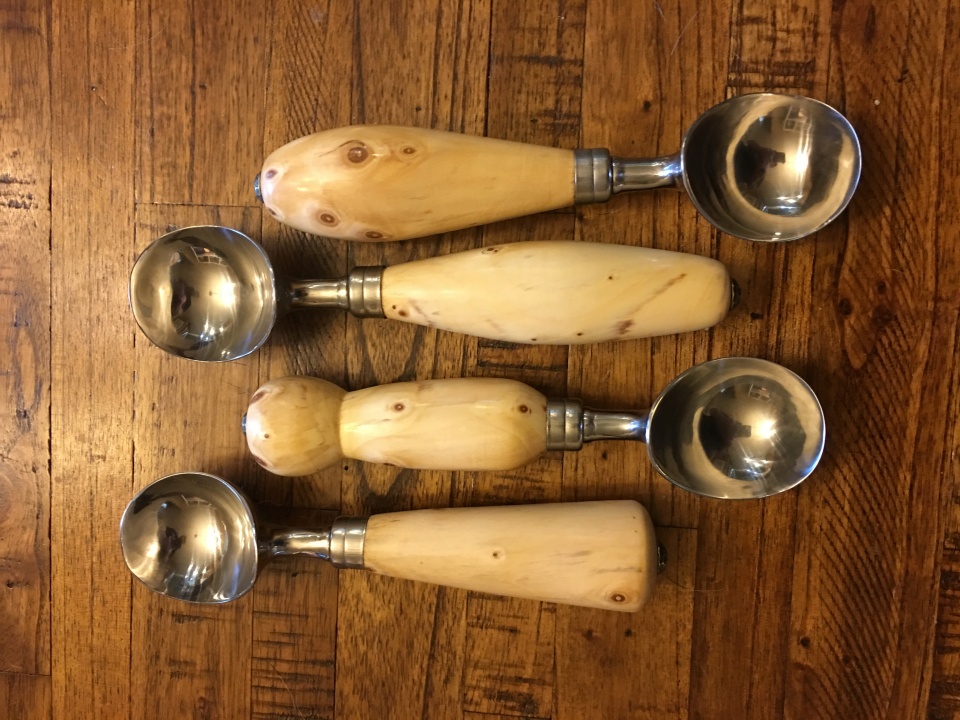

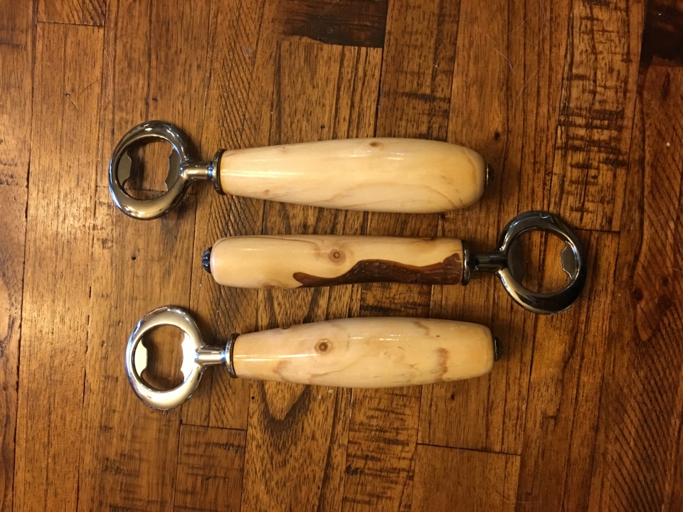

Unless you happen to have a Christmas tree from last year laying around, it's too late to make these for this year.
I went around the neighborhood after Christmas last year and collected several trees, trimmed off the branches and laced the trunk in the rafters of my garage to dry over summer.
These have been a big hit again this year.

Not as much of a problem with the sap as when I first trim off the branches. What little sap I get hit with is while turning off the bark.
These are not end grain turnings. I drill a hole in one end for the scoop or opener, place the hole over the drive center and the dead center in the center of the other end and turn between centers. Because pine usually dose not turn off smooth, I turn close to the final size and shape and finish with an 80 grit gouge and then progressively sand to 400. I finish with CA and buff with tripoli and white diamond. I finish off the back end with a decorative upholstery tack to cover the hole made by the dead center. All the little eyes on the handles are from the branches.
