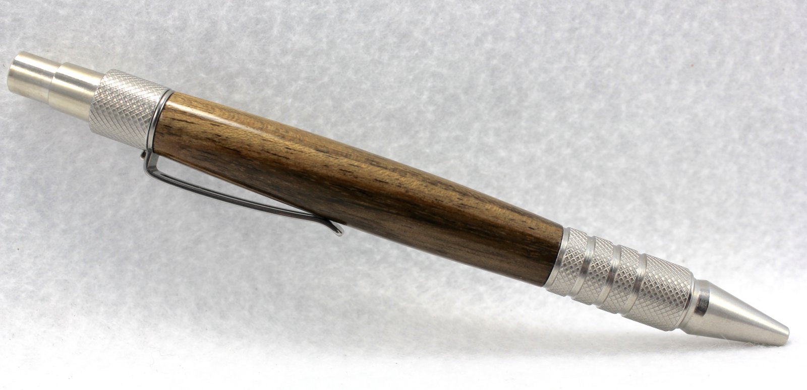

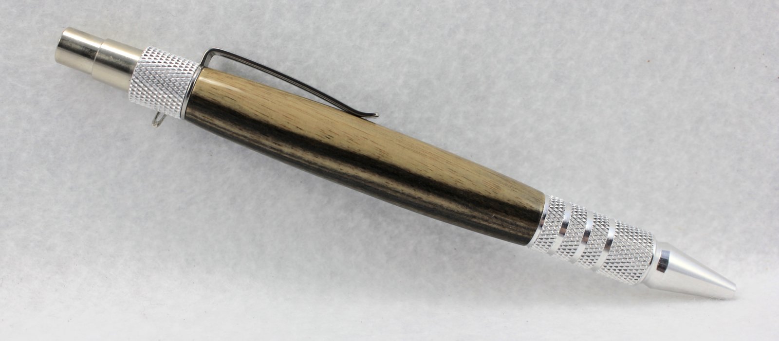

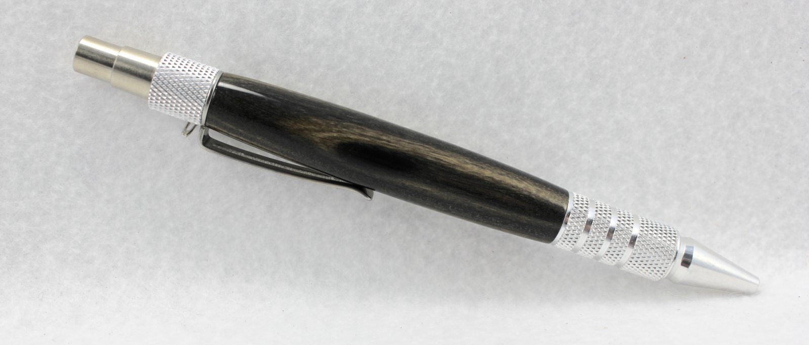

These will complete the order of 15 to be delivered tomorrow. Then onto an order of 15 in Caribbean Wood combinations (Mango, Royal Poinciana and red and black palm).
First is Faviera, second/third is black and white Ebony.
