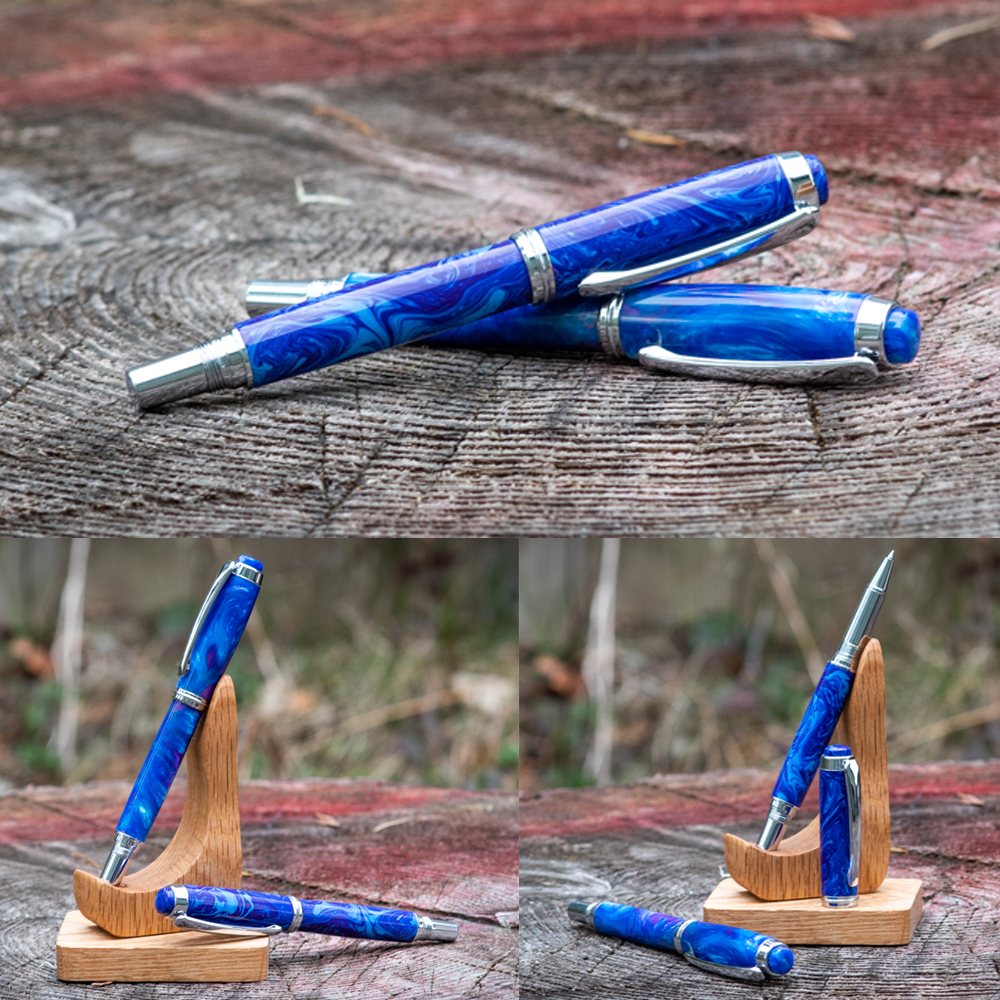

My girls wanted to give their teachers pens for teacher appreciation week. I let them pick out the blanks, and I used up what will be the last Caballeros kits I order. Never mind the slightly different sized bushings for the body that really don't change the proportions all that much - these had some less than great plating on the threads. I didn't realize how bad it was until I assembled one and ended up with a plating sliver in my thumb. I was able to clean them up with some fine files and high grit paper. But I don't think I'll be ordering these again. I do think the girls picked out really nice blanks.

Love the blanks. The colors are really vibrant. I also really like the matching finial. Very nice!

Thanks for showing!! Those are BEAUTIFUL pens!! And the pen kits were under $10 each.

Those look great, and I especially like the matching finial! That is one of the things I really enjoy about the Caballero kits. I have many bins of Smitty kits including probably over a hundred Caballeros. I need to make some more, especially after remembering that one of mine is the photo used for the listing on exoticblanks.com
