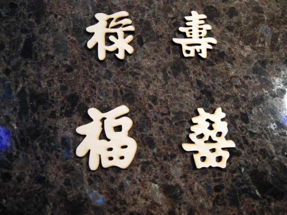

Thanks Guys. Richard came over and I got him squared away.
But wouldn't you know it. We decided to try a piece first (1/4 inch). It was slow but cut cleanly and popped right out. So we set up to do 16 pieces, cut and only two pieces pop out. He can get others but some just wouldn't cut through.
Anyway, I cut his pieces in 1/8" and he was happy.
Real
Here are the characters Real did for me.
Starting top left Prosperity, Long Life, bottom left Good Fortune and Double Happiness usually reserved for couples being married. But hey we can all use any type of luck whenever we can get it.
Thanks again to Real for all the help.
BTW he makes some really nice signs and I found out he also engrave pens
Richard
