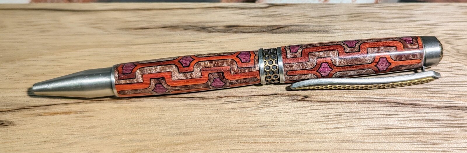

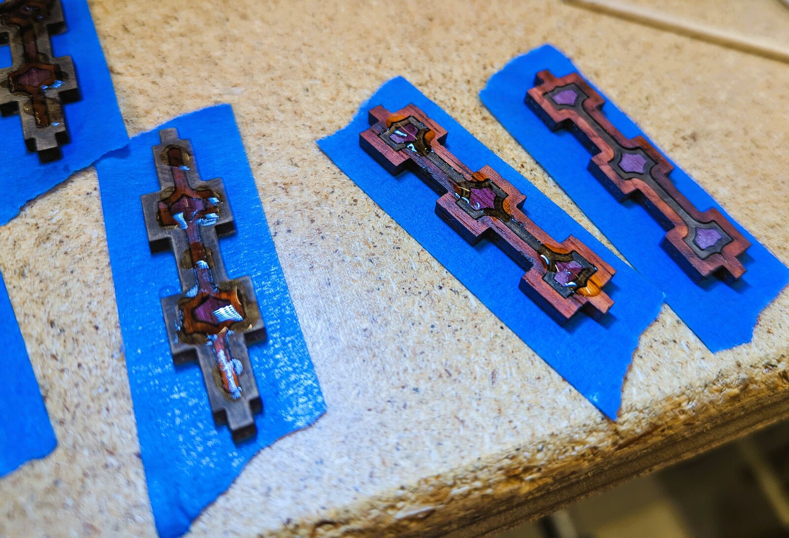

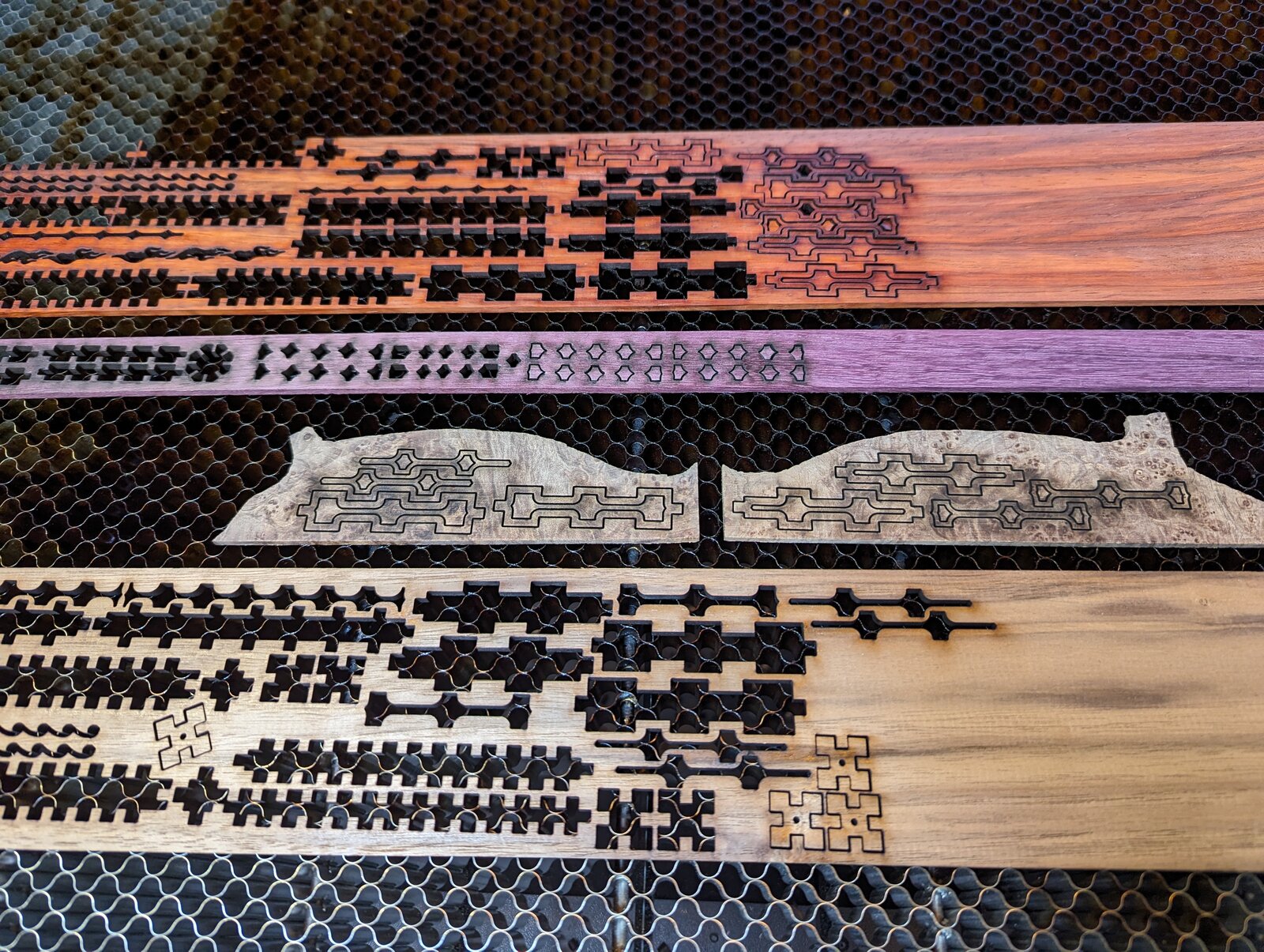

As mentioned and described in my introduction post, here is one of my laser segmented blank/box projects. Woods are Padauk, Purpleheart and maple burl that I stabilized. Sorry my pictures are pretty poor!

I see that you laser cut the entire blank, and assemble it like a puzzle? I thought about doing a different process, with turning a round base blank, then laser marking the desired shape, and later laser cutting the same shape from a different wood veneer and inserting it.
I guess that will require some rotary attachment? May I also ask what laser do you use? Thanks for any information!

Thanks! Hope this helps you along. Yes, basically making a laser cut box, sort of like a puzzle. Check out my introduction post for more details. Happy to answer any other questions! My laser is an Omtech 100W CO2 laser, which is much bigger than needed. I do think the process you mentioned attempting would require a rotary. Good luck!

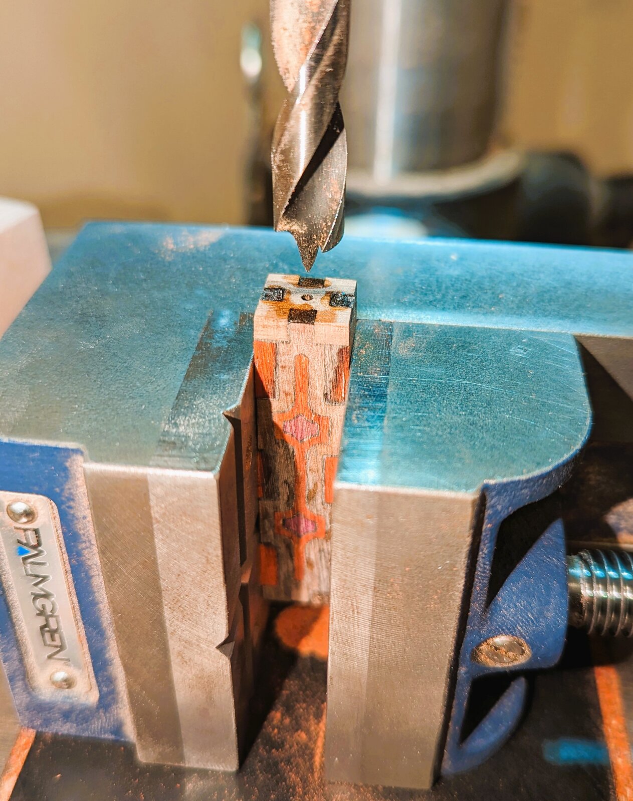

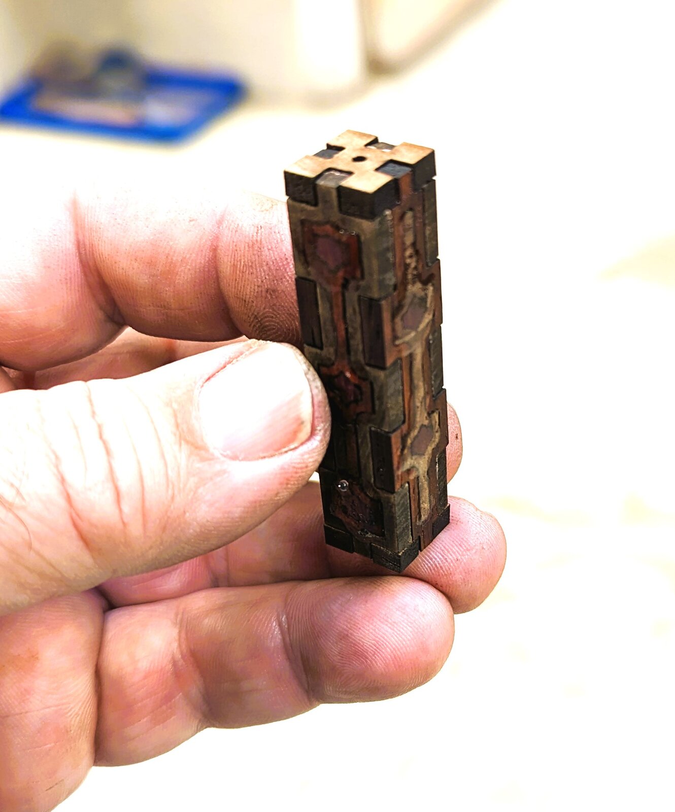

Hi Darios! The method I've used here is much simpler than the only other laser cut blanks, sold as kits, which are cut using a rotary holder. Those can be far more intricate and are very cool looking. I've been laser cutting different boxes using the website I mention in my intro for some time. Just recently realized I can probably turn a box as a blank. I'm going to experiment with incorporating epoxy as well, maybe other types of inlays? Assembling the four sided boxes (not counting the ends) is fairly easy. It takes a little time to dab the CA into the joints to wick in. Then some cleanup sanding of the CA to make the blank square again to hold in the vice to drill.
