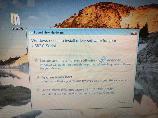

So I recently ordered the laser below.
DIY Violet Laser Engraver-254.60 Online Shopping| GearBest.com
It arrived and I assembled it with no issues.
I watched and followed this video to try and setup the software.
https://www.youtube.com/watch?v=9PijjOQbtZo

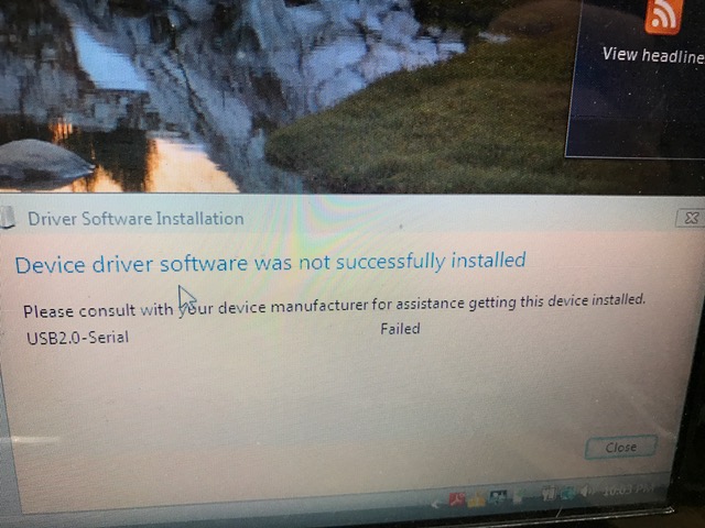

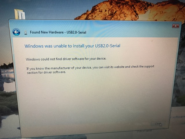

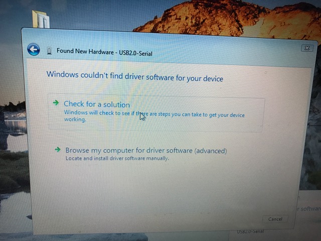

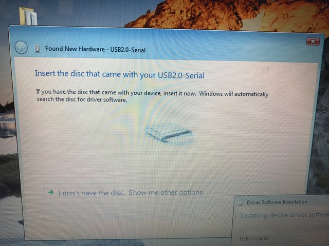

However the issue I'm currently having before I can get very far is that the USB isn't being recognized. I've swapped it out and having the same issue. Below are pictures of the messages I'm getting. I'm not a techie, which was my concern about getting the laser, however I can usually figure this sort of thing out. Any help or advice would be greatly appreciated, thanks! No installation CD came with the laser. There is software available from the Gearbest website but it seems like the Benbox software hasn't had too many favorable reviews.
attachment.php
attachment.php
attachment.php
attachment.php
attachment.php

Go to the GearBest website and get their software ...
Go back into the driver installation and select browse your folders to get to the GearBest installation directory ...
Find the Drivers folder or the driver INF files that you need and install.
After that, you can delete the actual SOFTWARE but don't move the drivers ... alternatively you can pull the driver files themselves out of that directory and stick them in a new directory in your hard drive so that they are out of the way, and install them from the new directory, and delete the entire software package from GearBest. Don't forget to uninstall the GearBest software as well.
Install the software package of your choice, after this, and the computer should still recognize the hardware.

Check this video out concerning setting your machine up to use LaswerWeb3, which you can get for free ... it's software you can use to control the engraver.
Try plugging your USB cable into a different USB port ... sometimes the USB controller is not properly connected or compatible.
That's the same video I posted as well. I've tried to USB cords and two different ports. Both ports work with a mouse.
