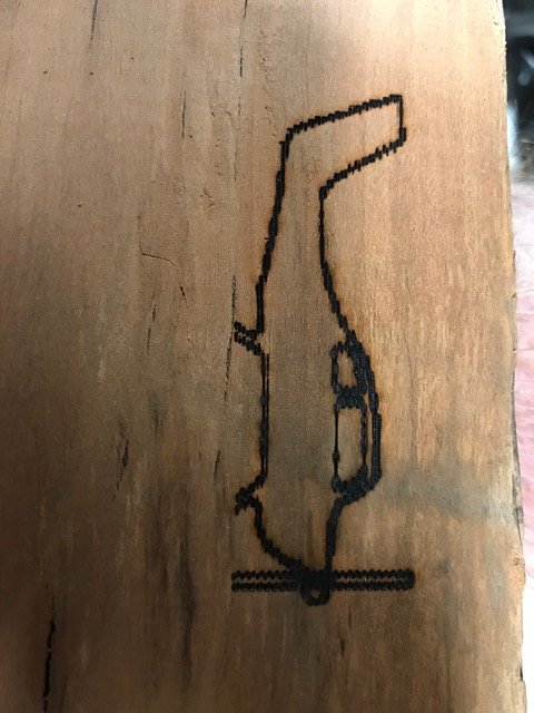

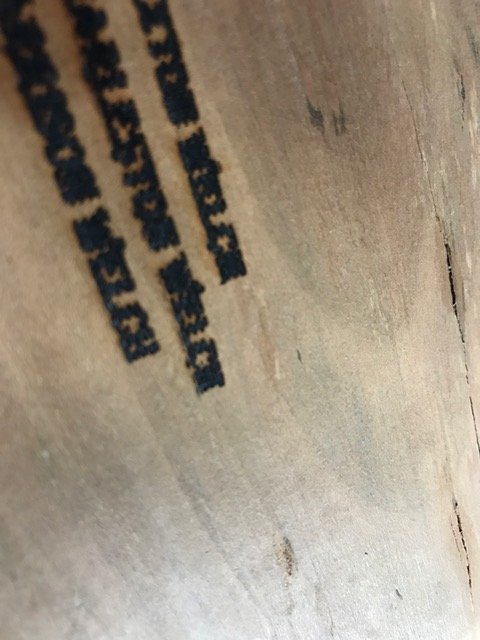

After the bash I'm getting back to playing around with the laser. I've downloaded paint.net as well as inkscape and gimp. I found paint.net very easy for me to learn for basic designs which is all I'm after currently. However after thinking I had figured it out I've learned about Raster vs Vector images.
It seems paint.net doesn't do vector images and the raster images are pixelated as seen in the pictures. I found a couple of raster to vector converters online but they seemed to change the image size to much larger than usual.
Long story short, is anyone using paint.net and then converting to vector? If so any tips or programs (free is of course preferred). Thanks for all of the help!

You already downloaded the inkscape. Inkscape has a very powerful trace command (under Path/Trace bitmap).
Here is a short tutorial (many more on the web): https://inkscape.org/en/doc/tracing/tutorial-tracing.html
Also, check the Laser engraver extension for inkscape.
Also inkscape can resize any vector file.

Good to know on resizing too, I didn't think about using the two together although I'm sure if I learn Inkscape paint.net wouldn't be needed much if at all.
I use Inkscape as well. It does a great job converting files for the laser. I've engraved up to 18" x 18" with no issues as long as the export resolution is correct.
