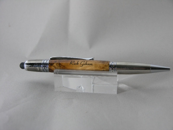

I do a CA finish on nearly all my pens. I put 2 coats of thin CA on then do the burn and put the blank back on the lathe and complete my CA finish. I have the NEJE 1000 and found if I set the burn time to 65 - 70 for all my wood pens it comes out ok. I finished this on in 2009 and have carried it since, engraved it with the above settings after I got my engraver.

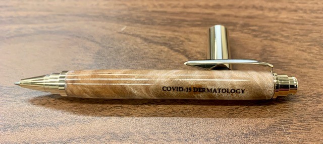

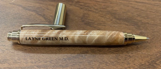

I had no problems with lasering over star bond or PSI CA finish, but 2p-10 CA finish before NEJE 1500mw laser at 70 ms caused a smoky white discoloration between the lamination layers, melting finish and not legible. so now I sand to 800 -1200 grit, laser the pen, then 2p-10 CA finish, and AAA polish at the end. It looks like the names are floating in glass above the wood and I really like the look. Maple Burl on Rollester kit, the ca layering caused the fit to be less than perfect, but as I was not going to sell it I didn't mind the imperfections.
