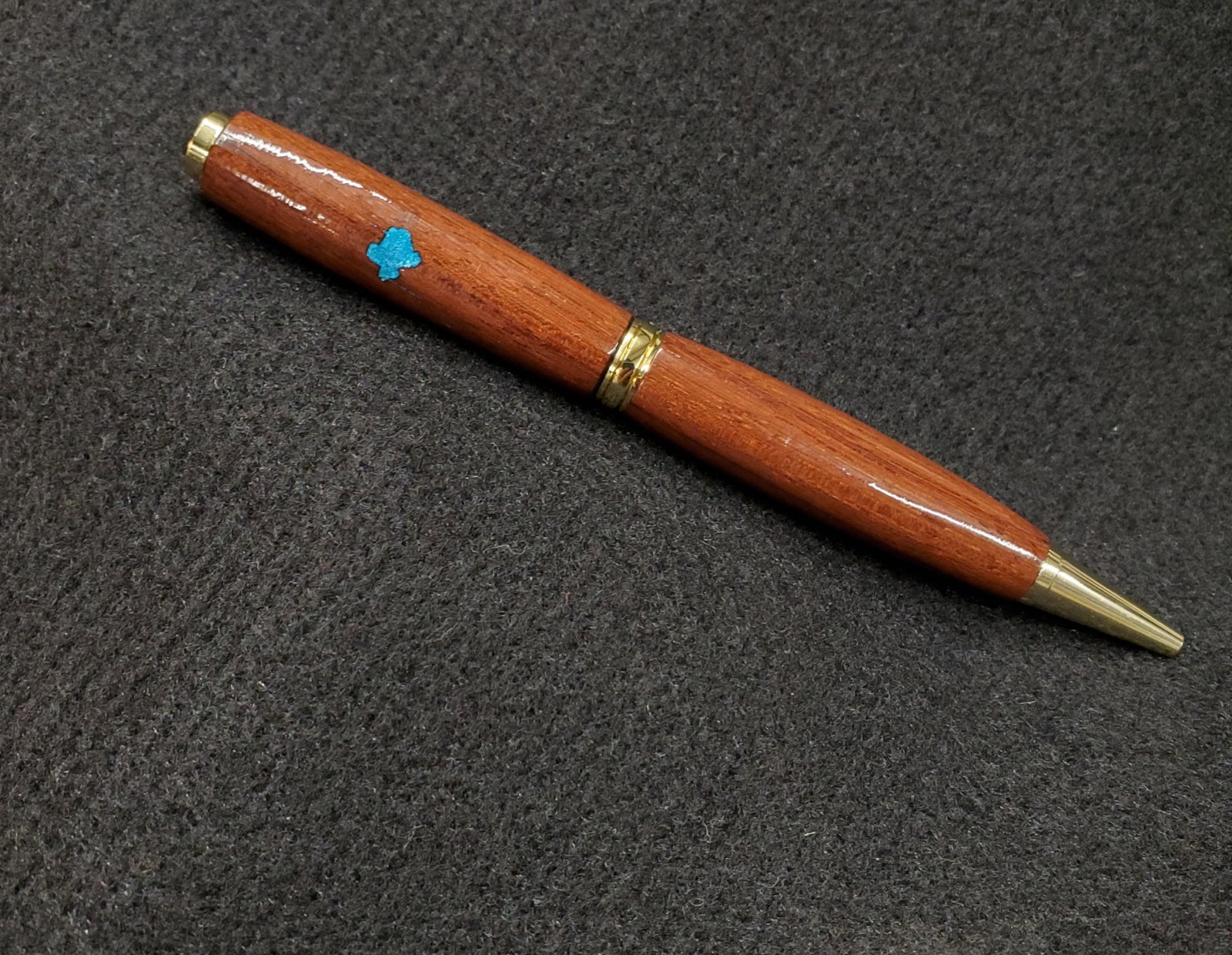

So I engraved a small Texas symbol a few years back into a pen. For one thing, the laser is burning the wood, not engraving. I had to laser the pen a couple times, take a toothbrush and brush out the charcoaled ashes until I was happy with the depth of the cut.
As for coloring, the only way I could color was to use mica powder. I put some of it in the lasered spot and then put thin CA over it and then sanded smooth.
