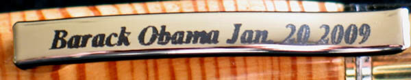

This is the first picture I have uploaded. Hopefully it will show up.
Here is a clip that Constant (lazerlinez.com) engraved for me.
It is on an Elegant Beauty from Aaron Lau. It did turn out better than the photo shows.
The flat surface of that pen clip makes it easier on an engraver, I'm sure.
Constant does a great job!

The pen is advertised as a Gold-Titanium plating. I believe the clip is Rhodium plated.
I bought it from laulauwood.com. It is also available at thegoldennib.com.
