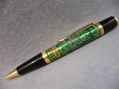

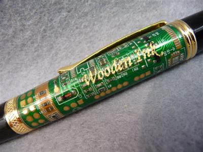

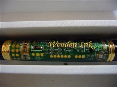

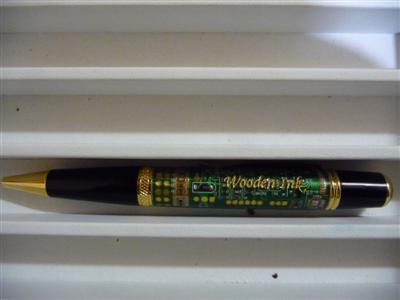

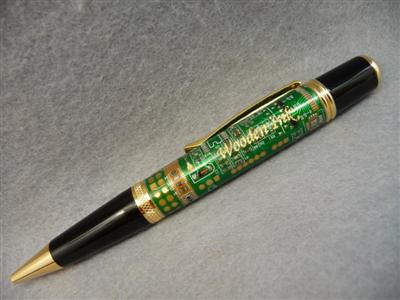

Jamie, you can Laser engrave them, the laser power can be adjusted to cut at the correct depth, HOWEVER, on the Circuit Board pens, the engraving would be hard to see on the clear resin, SO, we use a "filler" of the colour of your choice and it will look really great, I have just done one. The First two pictures you can barely see the engraving the last two is with Pro Color Fill. Amos
PS the light in the photography doesn't allow the true picture, in person they look much better, Amos

JTT don't worry, you are not alone in been proven wrong, I won't even try to count the times I have been proven wrong, meanwhile, you will find that you can sometimes use different colours for better results, for example if the pen kit was silver I would have used a silver fill; sometimes a Maple box is best just left as is, but a darker colour fill can help match the inside pen etc, etc,. Amos
