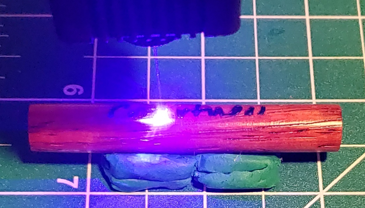

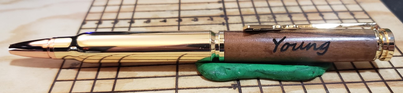

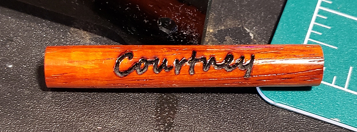

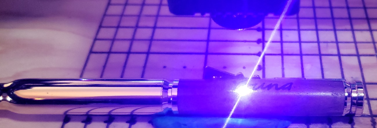

I have a NEJE Master 2 7watt. Still learning how to u
se it.

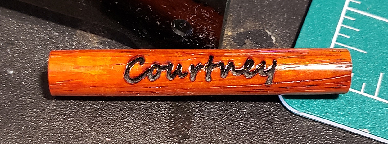

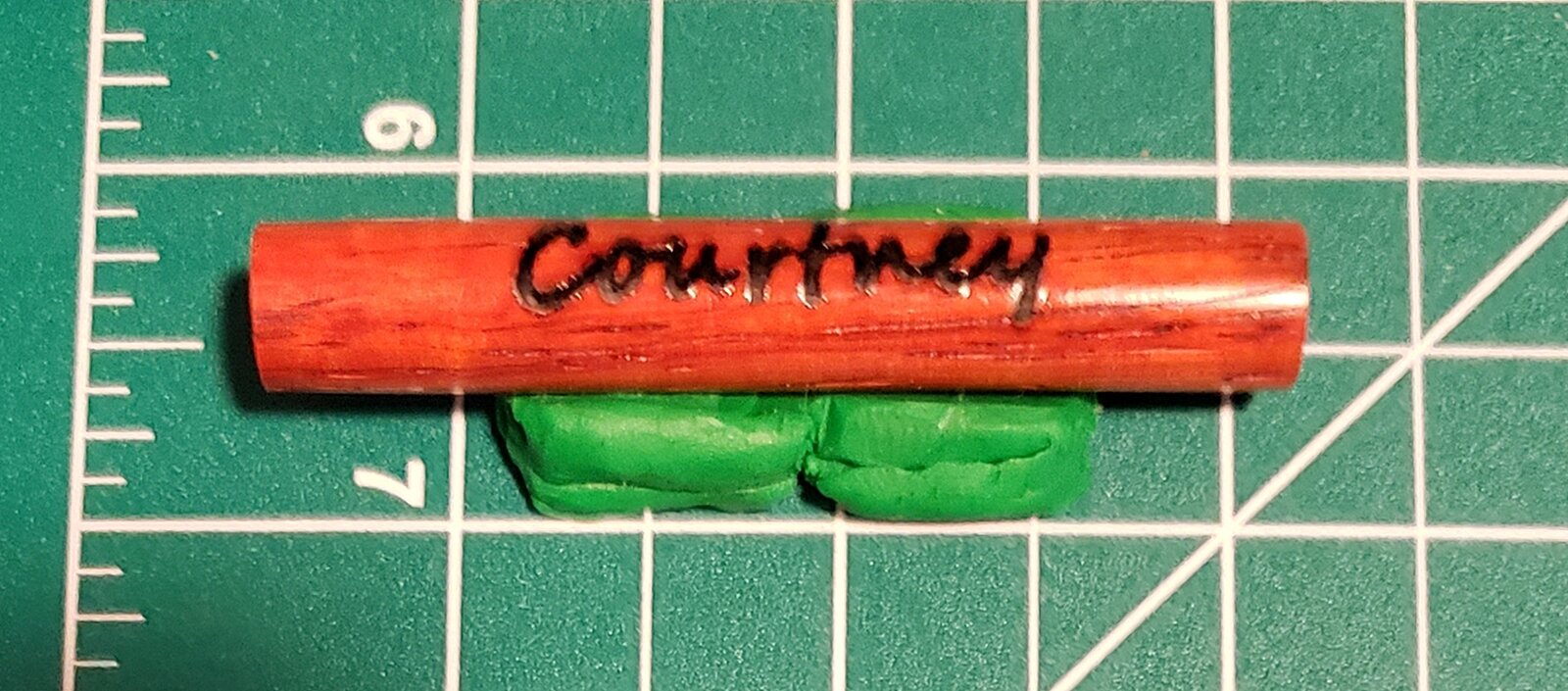

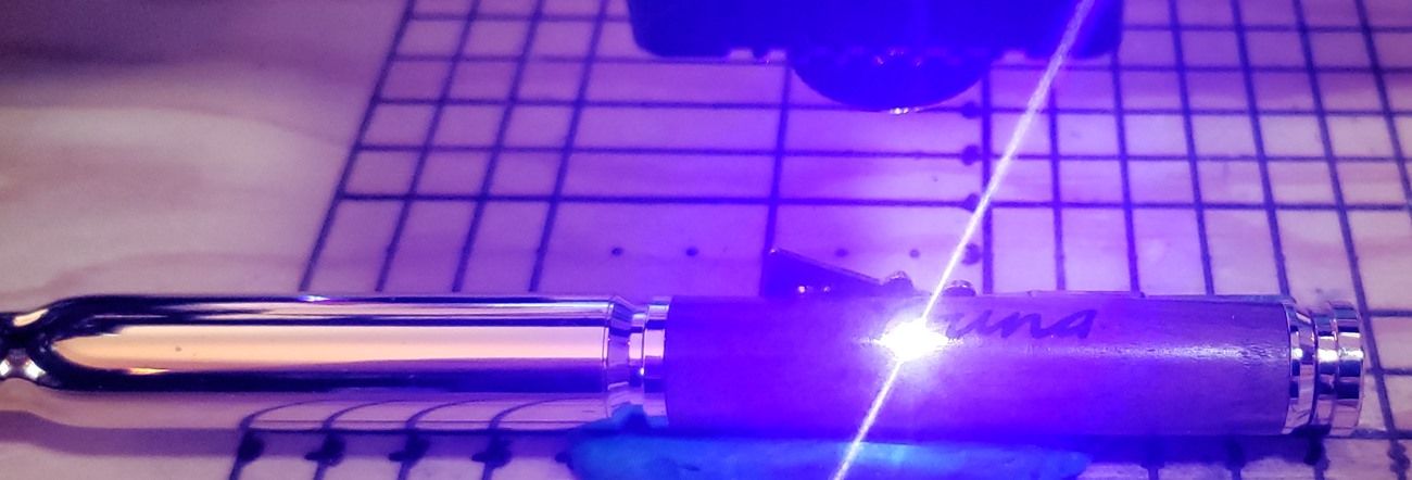

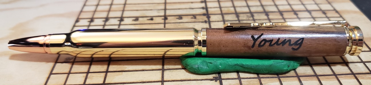

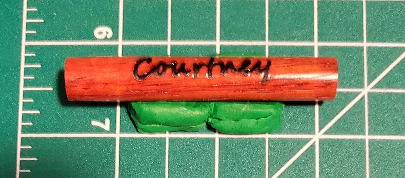

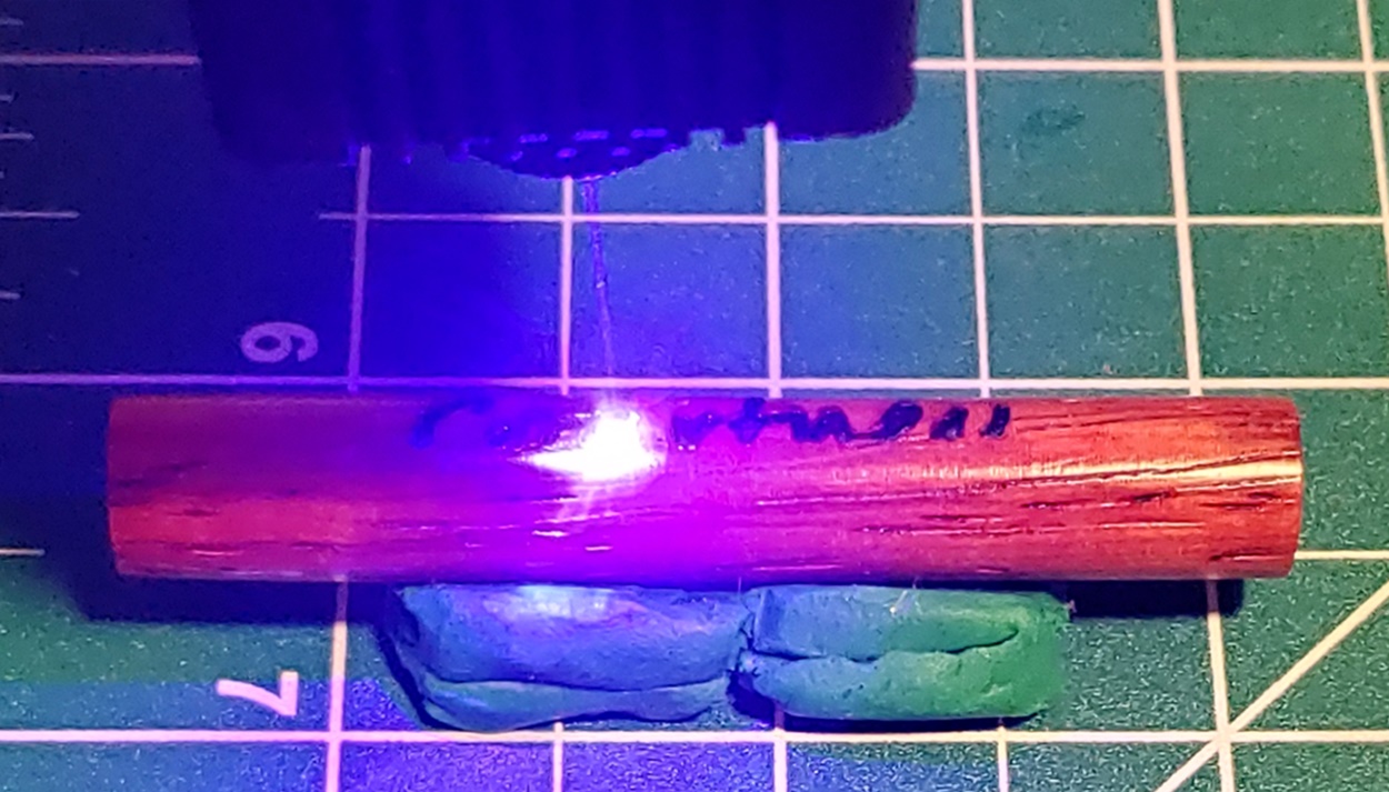

I burn through Pens Plus all the time. I can see where a thick CA finish might be an issue. One trick I was told about is to use a black white board marker on reflective surfaces. It wipes right off. The finish would have to be completely smooth, though.
