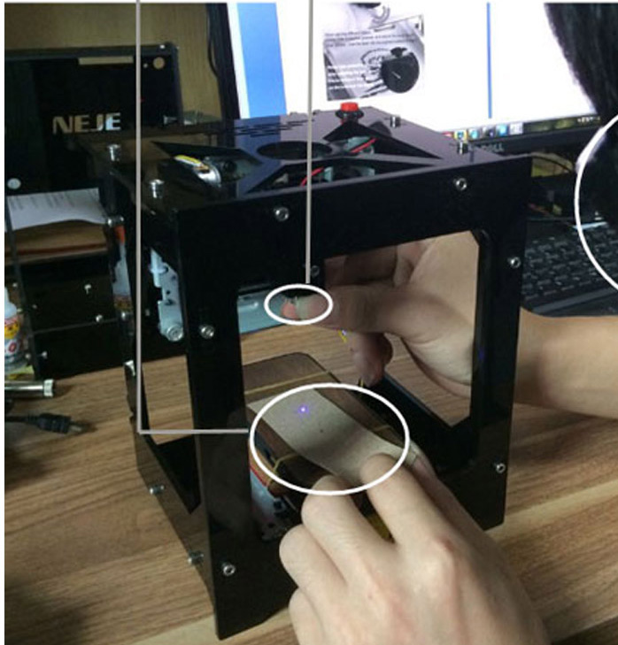

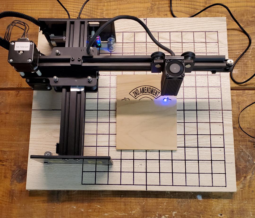

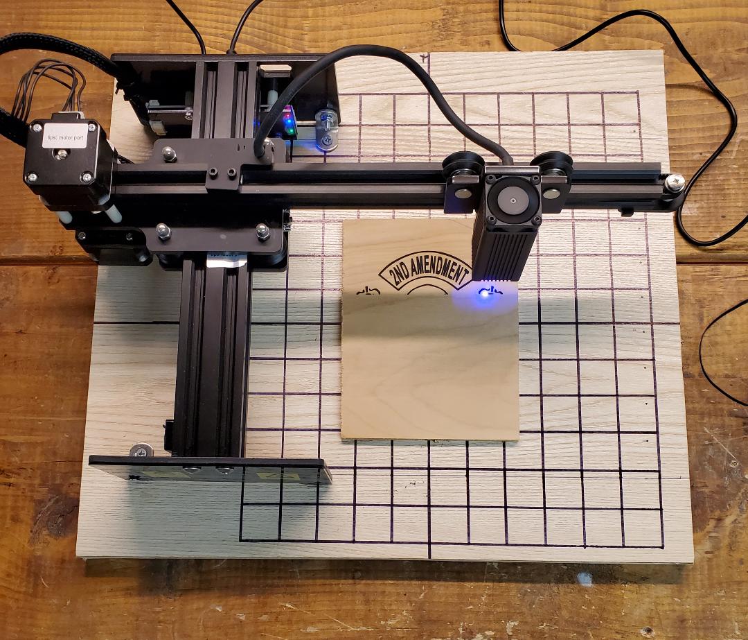

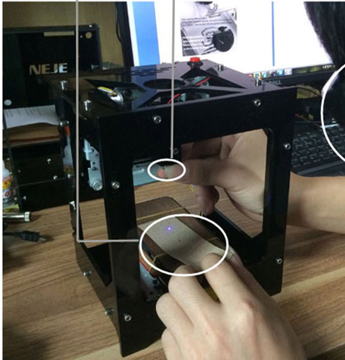

The 1500 has a very small platform that you can engrave on. The 3500 has and arm that the laser moves on and gives you a larger platform for engraving. The first pic is a 1500 I stole off the web. I have one of these also and it's very limited for engraving. The 2nd pic is my 3500. I like it much better. Larger area to work with. Btw, It's not the 3000. Look up NEJE 3500 Master.

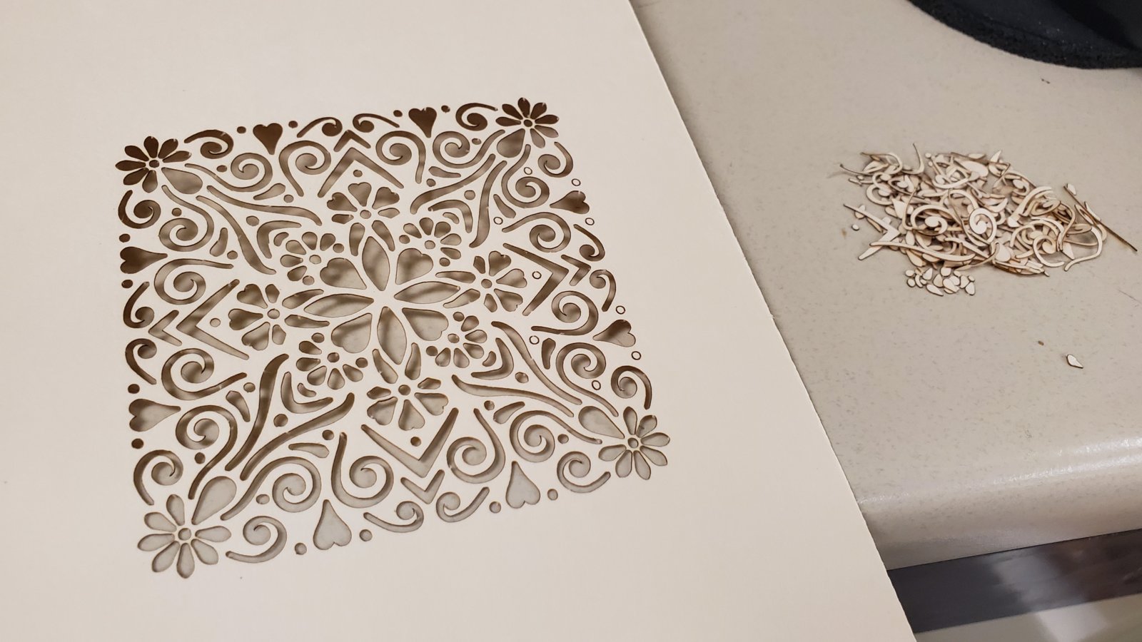

I have both and my neje 1000 is more like a toy to me. My master 3500 is like a real laser burner.

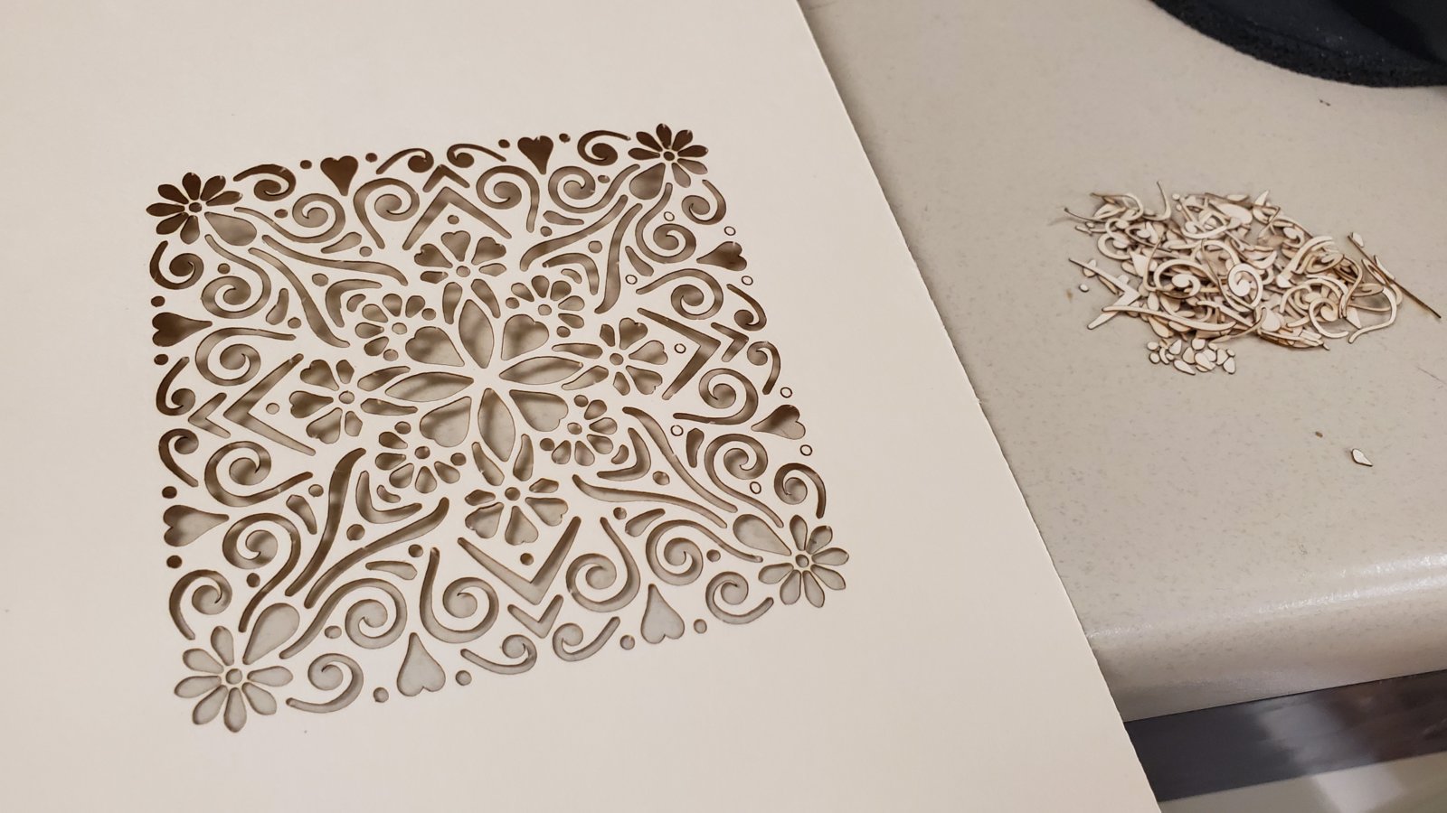

I wish I had better pics on my phone but I cut this manilla folder material with it.
