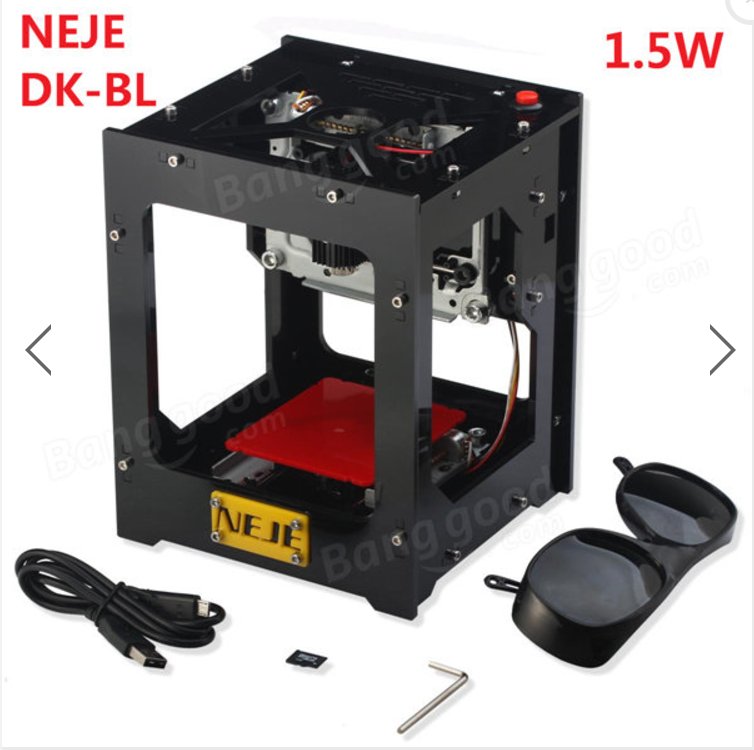

Hi all,
I've read a lot, and then found on this website mention of the 1500 mW laser engraver - I guess NEJE found here:
https://www.banggood.com/NEJE-DK-BL...Engraving-Machine-p-1137183.html?rmmds=search
Is this a recommended low cost engraver for items like pens and pencils (and in my case batons, reed cases, etc.)?
Can you purchase a mandrel jig rather than the home made one I saw up on one of the threads?
Pros and cons?
Thanks.
Roger Garrett

I'm glad you ask those questions because I'm confused about these lasers. On one hand, I see lots and lots of people buying these because they are so cheap but on the other hand, I read a few too many complaints about these type lasers and in particular the NEJE brand so I wonder, are different models better or worse...?? for about $150.00 investment, is this a tool that people should have in their workshop...?
I may not have a specific use/justification for one of these right now but for the money, I wouldn't mind buying one to play with, it shouldn't be any worse to work with than the 6040 CNC, right...?
What do you guys think...?
Cheers
George
Keep your "cool". Most problems I have read about concerns the laser tube burning out. They do get "warm" but as long as don't do a production line engraving, and let the laser rest about 10 minutes between burns (i.e. one pen every 1/2 hour) your laser should last. And have a spare tube on hand. The tube will ONLY burn out in the middle of a "has to be done by tomorrow pen." :-)
I've got the 1500 mW laser, Metrek brand which from what I can tell is exactly the same as the NEJE. It wasn't something I needed per say, but I got an order for 20 pens from an engineering company who wanted their name on the pen to give to customers.
It has done quite well for me, I have not had any problems due to overheating, it actually seems to stay completely cool, even when trying to burn large images. Maybe the built in fan helps? Or maybe I have just been lucky.
As far as the rotary mandrel jig goes, I built one, then discovered that a. I did a poor job building it, and b. I did not actually need it to put the line of text I needed on the pen.
All in all, I am impressed with it.
