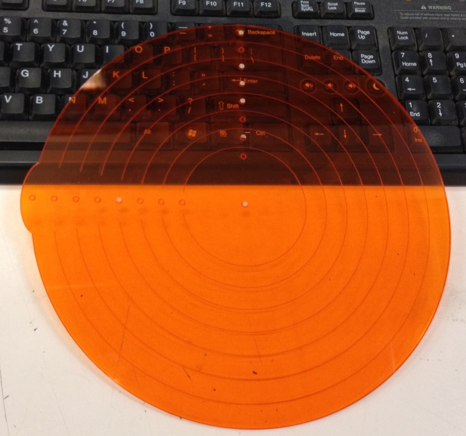

I whipped up a bowl layout gauge a couple years ago…just a bunch of concentric circles with a hole in the center and at specific increments outwards towards the rim (see enclosed photo). Takes a few minutes to draw and if cut from scrap, its materials cost is literally about two bucks (the commercial versions sell for $12-$15).
The first version took about 22 minutes of laser time. The concentric rings were raster-engraved and the text ran at a 45 degree angle from the center.
I tweaked the design to make the concentric rings "hairline" thickness and moved the text so it was horizontal. Ran the raster portion to quickly engrave the text, then the low-power vector portion to make the rings, then boosted the power to cut the tiny holes plus outer rim.
That version takes about 5 minutes total! If I were trying to make some for sale at a craft show, that's a huge difference in my productivity as well as a big reduction in the wear/tear on the laser!
The hi-viz orange turned out to be a poor choice…too dark. There's a florescent yellow that's much lighter…but still has enough color that it doesn't vanish in the clutter on my workbench like the clear version did.
