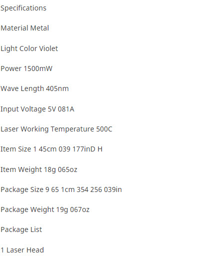

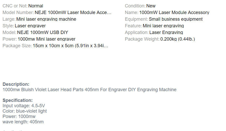

I see that these are the 1500mW varieties. So, you are using these in your 1000mW engraver, with no issues? I think I remember someone else stating that they COULD be used in my machine, but I just want to make sure I am remembering that, correctly.
the 1500 and 1000 can be switched out. I'm using the 1500 on mine. if you don't feel comfortable then get the 1000.
I have an NEJE clone per say - Meterk.. they are all the same guts..
Here are thee 1000mw and 1500mw lasers, same peak voltage 5v.
