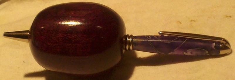

Or you could always do something like this-LOL.
