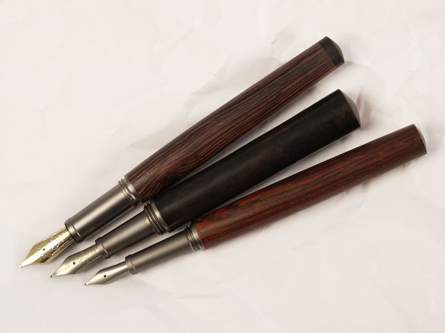

Hello Gary,
one of my friends make realy big FP´s
I have the pic from his WEB Side
Norbert Zeplien - Schreibgeräte mit Stil (sorry german, but he talk english)
Nib/Inksystem sizze from below
5 mm (jun. Gentlemen´s sizze)
6 mm ( Statesman sizze)
8 mm
regards from sunny Germany
Gerhard
