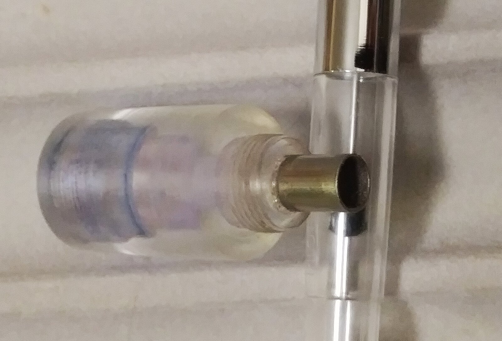

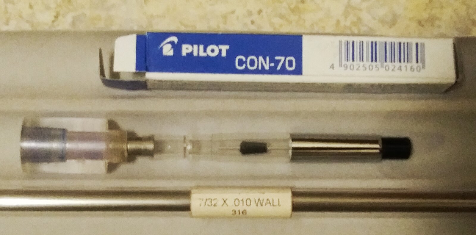

Here's how I made a section to match the CON-70: it is not the only way, and next time I make another I will try an alternate approach.
Start by purchasing a couple of converters, and figure out the diameter of the aperture. I used a transfer punch set to get in the vicinity really fast, then fine tuned it by trial and error. The ones I have are really close to 7/32" - so I bought some 7/32" stainless tubing from McMaster-Carr or Grainger or Enco, I forget which.
Then I made a section to take the nib unit I was going to use, and glued a length of the stainless tube into the other end. 7/32 was just a little too tight for my liking, so I used fine grit papers to polish it down just a smidge for a tight-but-not-too-tight fit, and used a little silicone grease to make sure there was still a good seal.
Pix of my prototype follow.
My next one will be the reverse - the converter will push into a hole in the section (which is how the Pilot fountain pens are made) rather than pushing onto a tube.
