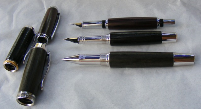

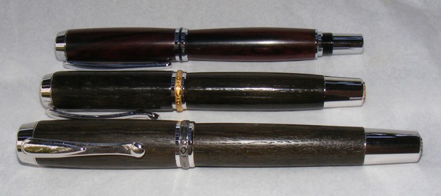

Here is a pic. Top is a Baron, Middle is a Jr. Statesmen, and bottom a Full Sized Statesmen
