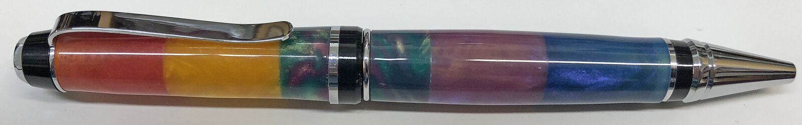

I am new to acrylic. My local Wood Craft has bags of acrylic cutoffs fairly cheap. Half of them are big enough for pens but the other half are too thin. Will regular epoxy glue or CA be good enough to laminate some of them together to make blanks?

I have been successful using 2-Part epoxy. Here is the first test I did with cutoffs just to see if it could be done - Dave
