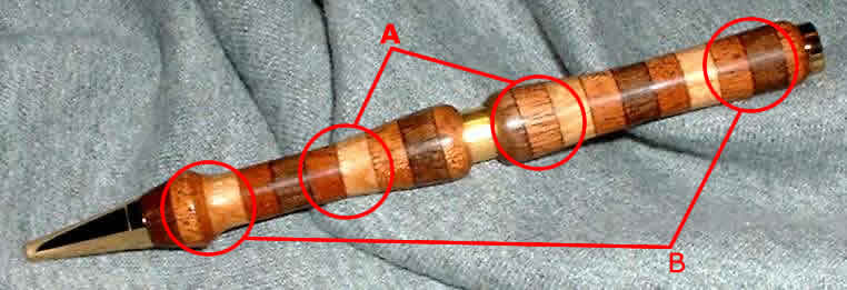

In spite of our best efforts we sometimes foul up. This pen is one of those situations. I had a few small pieces (3/4" - 1" square) of walnut, mahogony and birch left over from various woodworking projects so I decided to cut them up for laminations. Not wanting to waste much wood I decided to use my BS. Besides, cutting stock this small on a big TS can be very hazardous, even when using a sled. I even have a high dollar thin kerf blade, but with stock this small I wouldn't be left with much. The problem with BSs is that you sometimes get a little more drift than you expect. I used my BS sled with the stop block in place and the blade still drifted on me and I had the blade tension set almost at resaw point. The problem is that I didn't notice any of this until I got the blanks turned. They all glued up dead square. You can see what I mean by looking at the joints at circles labeled "A". You can also see that the blanks are square toward the nib side of "A" and return to square at or before the circles labeled "B".
The distortion on each laminate can't be more than 1/32", but it certainly shows up after turning. Such is life. We can't all afford INCRA jigs and fences, but I'd sure like to be able to. In the mean time it's try, try again.
