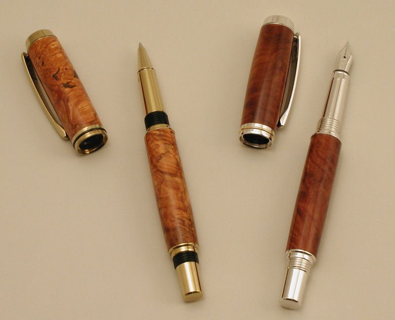

The first pic is of (2) Jr Gents pens the Titanium Roller ball on the left is Cherry Burl and Platinum Fountain pen on the right is Red Malee Burl.

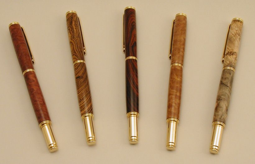

The next is of (5) 10K Roller ball pens
From left to right:Red Malee Burl, Bocote, Cocobolo, Brown Malee, Maple Burl

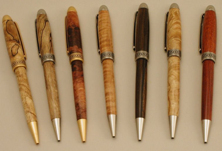

The last (7) are Satin Nickle and Satin Gold Plated European pens
From left to right:
Figured/Spalted Maple, Spalted Beech, Cherry Burl, Curly maple Zircote, Maple Burl and Bloodwood
