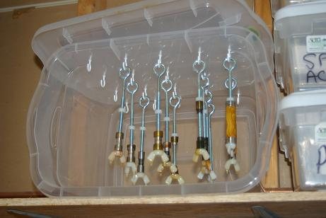

tried Billy's dip method, and I am in love....here's my booth...I use the wingnuts on the bottom, easier to break loose after the lacquer dries/cures/catalyzes/hardens...I use old bushings and after the first two dips, slide the whole assembly off the eyebolt, flip it over, put the wingnut back on and dip away....

Jon, very clever set up you have there. I like it. Do you put the lid on that container to keep the dust out when drying blanks? Maybe you live where you don't have to worry about dust.
I leave it open for air circulation unless I am doing anything that raises dust in the shop. The "booth" is on the oposite end of the shop from the air cleaner and vac and about 7' off the floor, so stays pretty clean.
