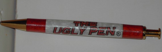

here are a couple of castings I have done . The first one was just picture glued to tube and then clear cast over it last one is decal just stuck on over casting .haven't done any thing else to it.

on the one that I casted I just roll the picture so the seam just overlaps ( you can still see the seam a little) I like the casting better because it looks deeper. Just started using decals seamsto be perty easy. Haven't tryed to seal decal yet they say ca will work and the heat will remove edges so you don't see them.

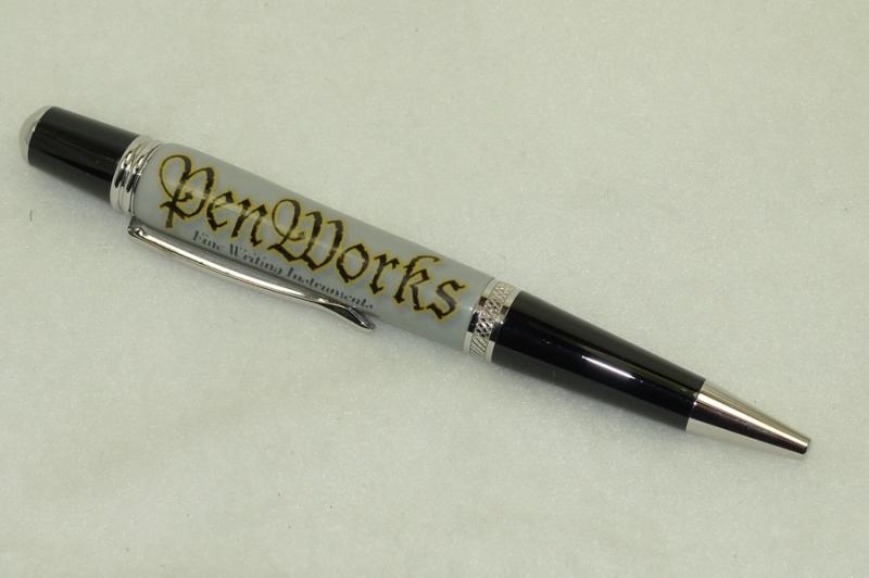

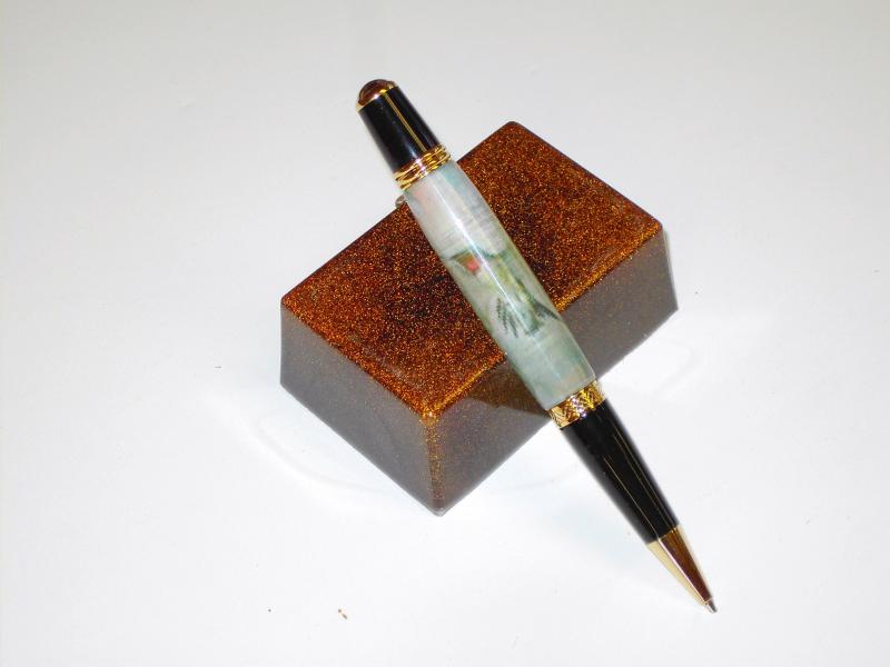

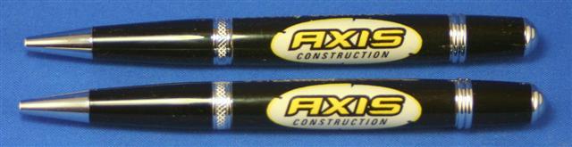

Here is a picture of a pen I did for Anthony. Also a label I made for myself and a couple of pens made using it.
Do a good turn daily!
Don
Does anyone have examples of your castings??? Like to see the border you all talk about and also the seams you talk about. Thanks alot.

What I am interested in is how are disguising the seams??? In the ones you shown what part is the decal??? Does the decal go all the way around the tube??? Did you paint the tubes on those??? Thanks.

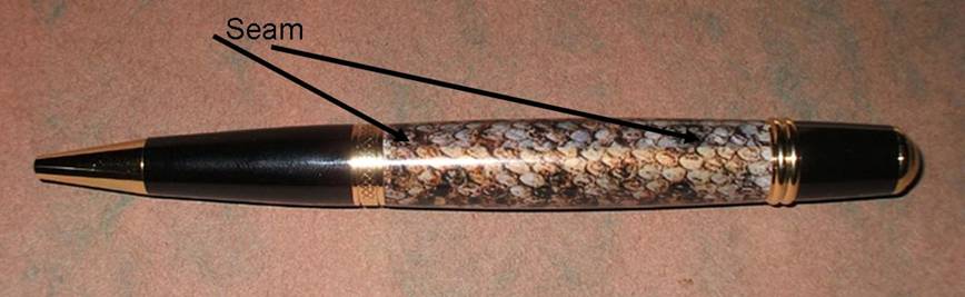

Usually you can hide a seam under a clip on a pen with a cap or a sierra, but if you're careful with the graphics and have them either busy like the one below or dark they're really not much of a problem. This one is a snake skin that Don scanned on his scanner, sent me the file, I printed and we made a few faux snake pens. If there is a lot of white on the label, its a good idea to paint the tube; otherwise it's not necessary. I've done many photos and other labels and no one has even mentioned anything about a seam. They're usually more impressed with the customization. The labels go all the way around and overlap 1/16 to 1/32". A small seam is expected with this process. Go for it.

I think the black is simple enough, but it might be a bit more difficult with other colors.
When you wrap the tube and leave overlap, the black wraps onto the black.
Notice how his label has blank black space at the top and bottom. You don't
want your graphics to be edge to edge, because you need that empty
space for the overlap. That allows the label to adhere to the label as well
as to the tube.
The edge of the paper label is white, and that shows up against the black.
So touching up with a Sharpie marker hides that seam.
You can do the same with other colors, provided your Sharpie is a close
enough color match.
Hint: Don't use a sharpie if you're going to put anything over the label
such as CA, lacquer, fixative etc. It makes the Sharpie color leech out and
it doesn't stay it's original color. DAMHIKT.
Disguising the seam is harder with lighter colored backgrounds. I try to keep the backgrounds dark and black is my favorite. I overlap the seam just a little and paint the edge of the overlap with black sharpie to hide the white line caused when the label is cut. Other color backgrounds I do similar. I have a pkg of sharpies with lots of color choices. Other markers have colors also. But, getting a color(marker) the exact same as the color background is difficult. I sometimnes try to scan a color made by a marker and see if I can use the eyedropper color picker to duplicate it. But, I plan to stay with black backgrounds.
No decals at all. The label/logo is totally printed on computer labels that are white...address labels. I gave the numbers I use in a previous post in this thread. Are you asking about decals...real decals..or using decal to mean the printed mailing labels.
The label goes all the way around but the actual art work does not. I suppose it could. I try to center the artwork and that places the seam on the back side 180 degrees from the artwork.
The axis logo/label was painted white because the white field around the work "axis" darkened when I didn't paint the tube...because of the brass tube "bleeded" through the white.
The penworks label was painted white. So, yes, I do paint and mostly paint white. You can decide what color to paint on each individual label.
I did two label/logo blanks for Arizona Silhouette (for Bill and Kathy as a gift) and used their website colors. The background was turquoise and the other artwork was black. It looked terrible on a not painted tube to I recast and painted the tubes white. The seam was not toatlly invisible. Black is what I will do if I possibly can.

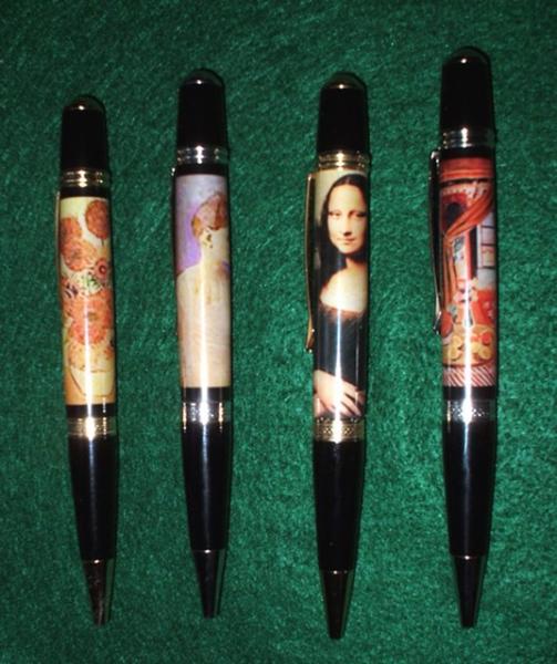

Here's some more photos that needed a black border on three of them. Just used a graphics program to create a black box and then pasted the picture over it. Just another way to deal with aspect ratio. None of these tubes were painted, but then again there isn't much white space.

Those are really excellent. Thanks for showing. I now get what you are talking about black border. It did not sink in at first but I see it now. Thanks and also see about the extra. I just some label paper yesterday and no it was not what was mentioned but will try it and if it does not work I will get what was recomended.
