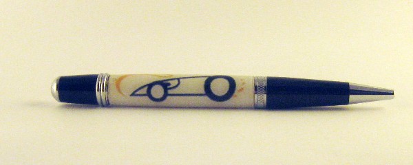

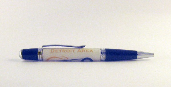

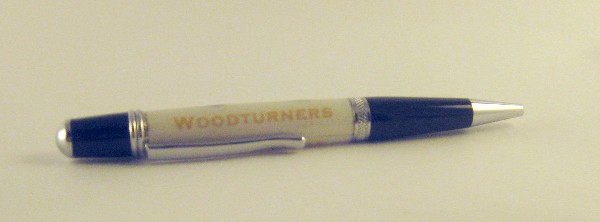

I finally got this first label cast done after several tries. I really learned alot! and thank Don Ward for his experience and advice.This is the logo for our local woodturning group (DAW>>>Detroit Area Woodturners). Perhaps the local IAP chaper will be next.

Looks good Glen. I have tried to do this using a few types of labels with no luck. What type of label do you use and do you cover the label before you cast it.

Lovely work Glenn, did you use a pressure pot?
No pressure pot, I just mixed and poured, but am getting the 2.5 Liter Ultrasonic Cleaner from HF to get rid of the bubbles.
I used Avery 5264 white shipping labels. I did have issues with the first couple, one being the edges lifting, so I glued them down on this one, with med. CA. I just probably didnt let the label dry long enough.

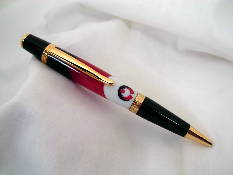

I haven't gotten into the casting part of this hobby yet but I have done a few "decal logo" pens that I guess are similar. I use clear decal film, print the logo on my inkjet, let dry for a day, coat with decal set, let dry and apply the logo to my finish turned pen. Let that dry for a day and then apply a couple of quick coats of thick CA at slow speed to make sure all the edges are covered. Then turn up the speed and apply another 6 coats of medium CA. Plastic polish and done.
I've attached a photo of my first attempt. Since this one I have received an order from a local charity for 12 pens
