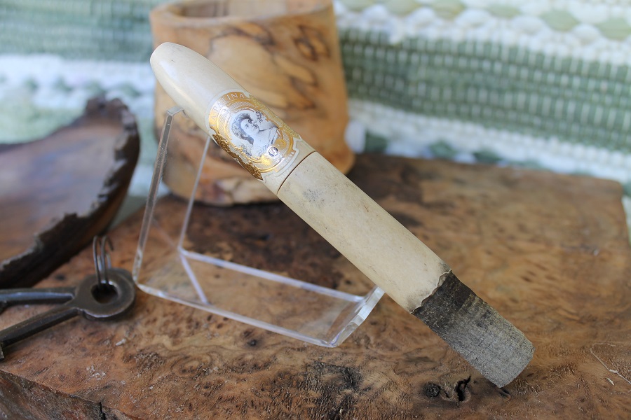

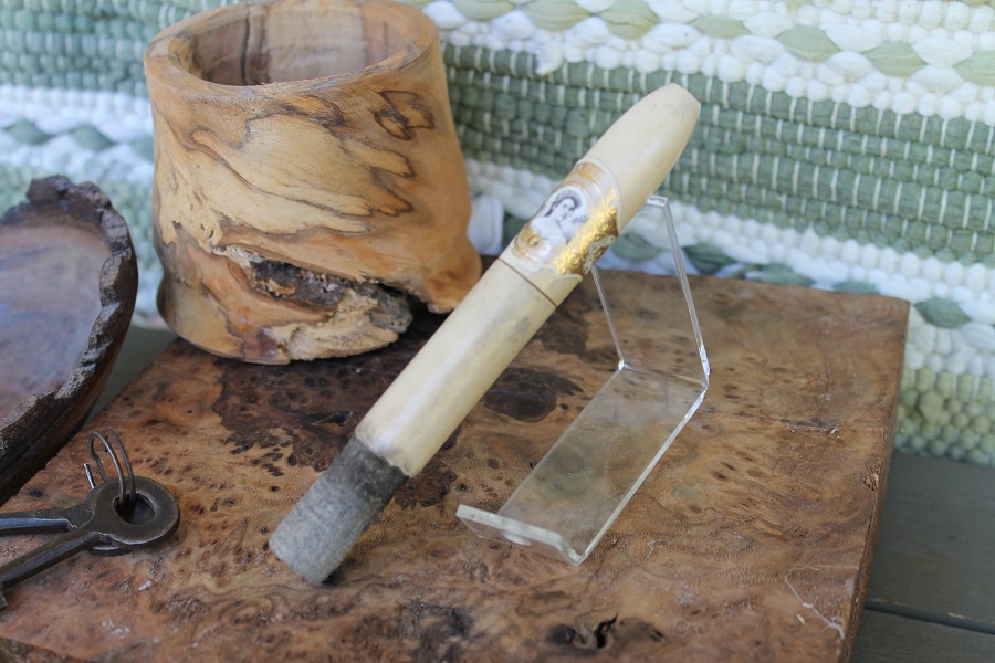

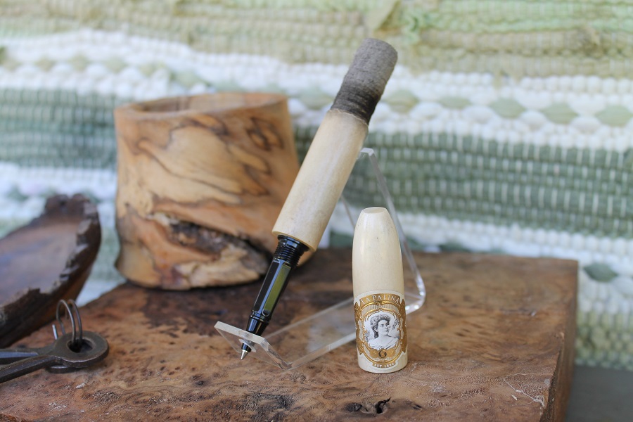

Instead of the usual wooden cigar replica pens, I've decided to try a cigar replica made from antler. Too bad antler didn't smell as good as real cigars.
La Palina label, and black enamel kit from Beartoothwoods.

Very nice, looks like a vertex nib. Did you recess the coupler(I think that what it's called). Nice job, I have some elk that's big enough to do that.
Mtassie, that's a Baron kit I used, Sedona would also work, and yes, the coupler is recessed. The Virage kit might also work as well for this, I think they may be the same size tubes in diameter. You could actually use probably just about any rollerball/fountain kit as long as you have the correct mandrel. I'm in the process of making my own pin chucks so I can use different kits.
