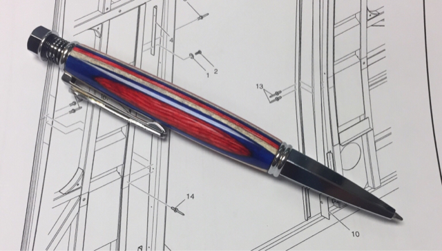

Turned a Woodcraft Wrench Click Pen last night. Dressed it with R-W-B Spectra Ply and finished it with GluBoost. My first time working with this finish and have nothing but good to say about it. Great product. Well, I would change one thing and that would be the size of the hole in the tip on the thin bottle. Woo boy, that first application was like a flood! IMG_8281.JPG

That turned out nice!
