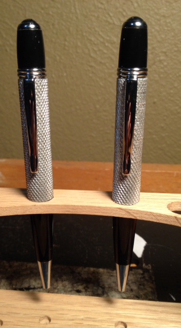

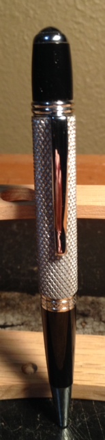

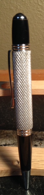

This is a pair of knurled aluminum body pens I made. These will be a gift to my machining instructor and the lab assistant at the end of the semister. The pen guts are a wallstreet 2 pen. The pen body is 6061 aluminum with the hold drilled to 25/64" which eliminates the need for a tube.

Very nice. Would you care to share how you did the knurling???:usflag:

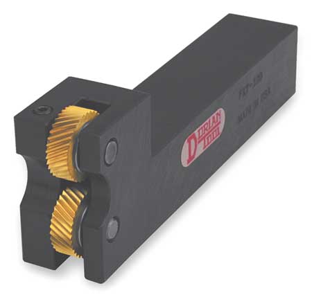

It was a knurling tool on a metal lathe. size, knurl, drill thru hole, part off, assemble.
Thanks. Was there anything special you needed to do to get that done??? I have wood knurling tools and wonder if they would produce the same results??? May have to give it a try some time.

Nice Pens, Nick.
The Knurled Pen Body, gives quite a Distinctive Appearance.
Did you have to Polish or Sand the Aluminium after you used your Knurl Tool, to remove any sharp edges of Aluminium lifted by the Knurl Tool?

no i simply cleaned it with a toothbrush and some acetone. lots of silver flakes came off but after that it was good.
