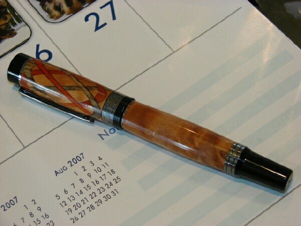

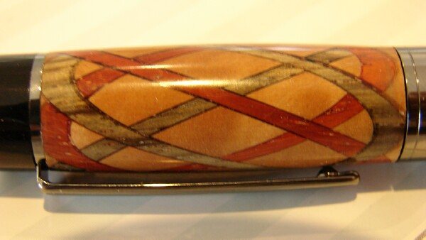

Everyone is doing knots, so here is mine,It has 6 cut with 2 different wood in the segment
The photo sucks

Looks like a really good job!!
You don't make it easy on yourself, running the pattern from top to centerband - any deviation from horizontal will be visible, in fact, accentuated by the hardware.
I would suggest you reduce your angle (as little as 10 degrees should do), so that you leave a little wood between the end of the pattern and the hardware. This will also make it look more difficult (in spite of the fact that it is really more forgiving) in the eyes of the potential customers.

I really like the color combo of the knot - plays into the celtic theme very well!
(So Ed, I can look forward to you making a knot pen sometime soon, then??? [}:)][}:)][:p])
