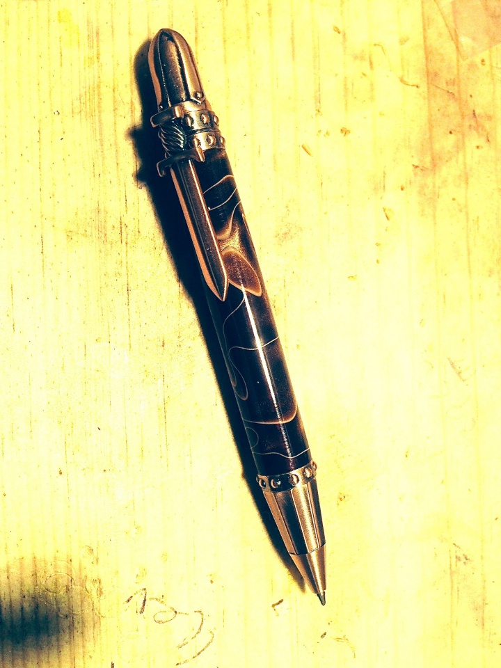

I put 2 together is AM. Both worked out well. I think they are constructed nicely. No issue at all. They seem to be well made kits.
