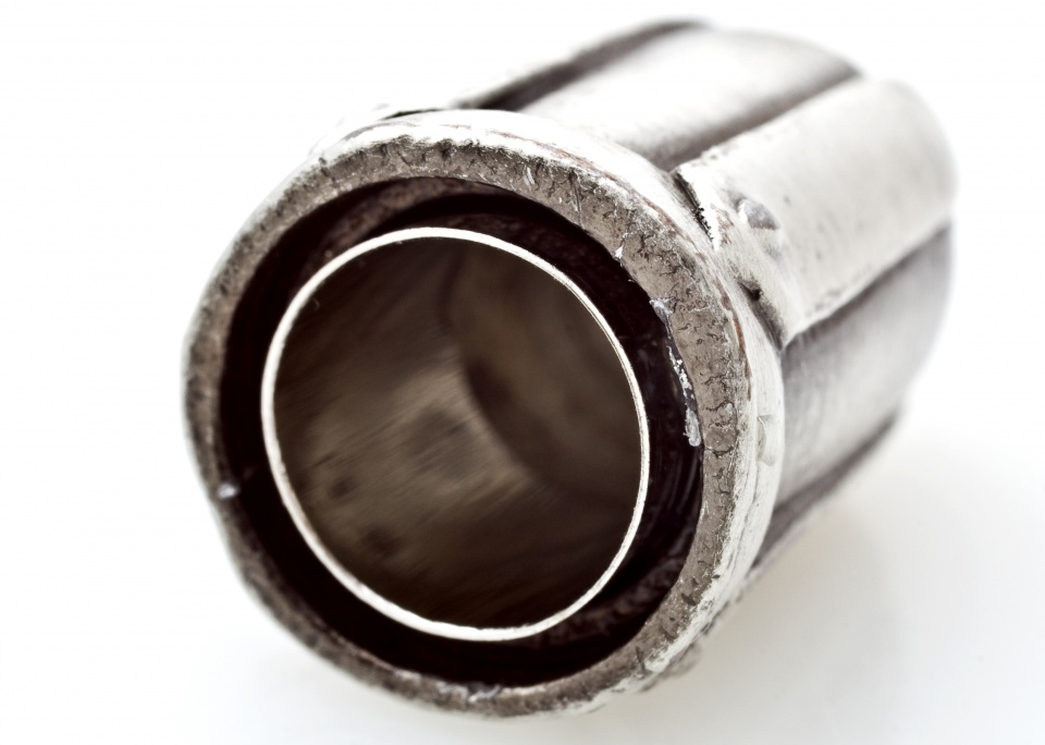

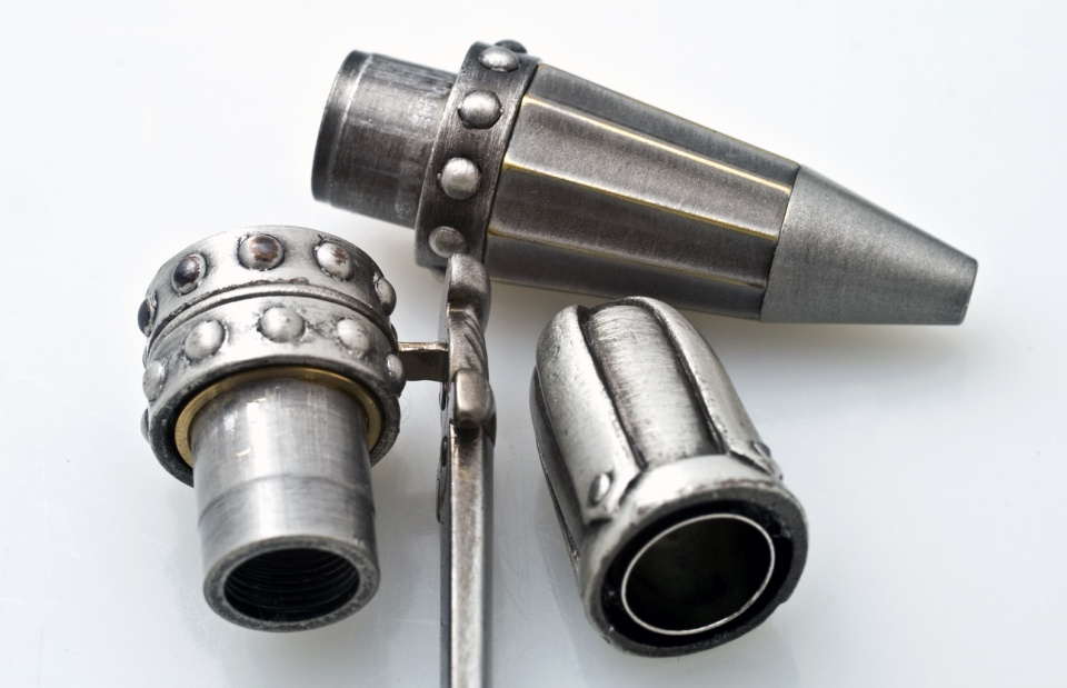

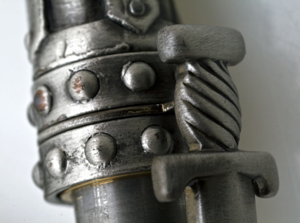

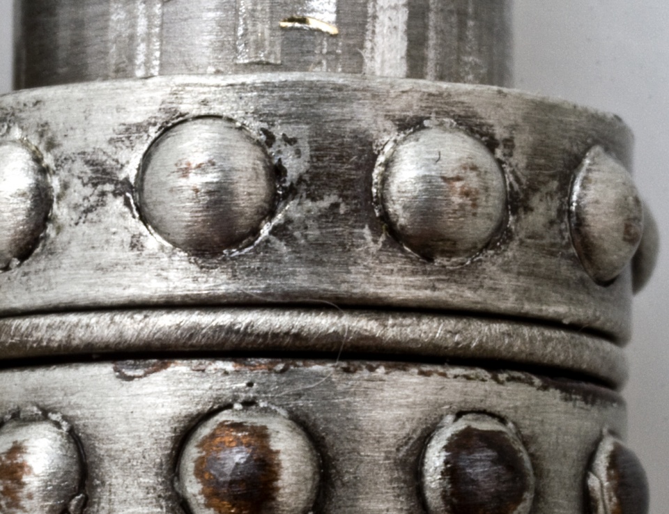

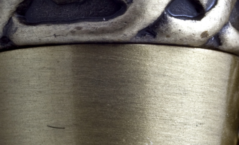

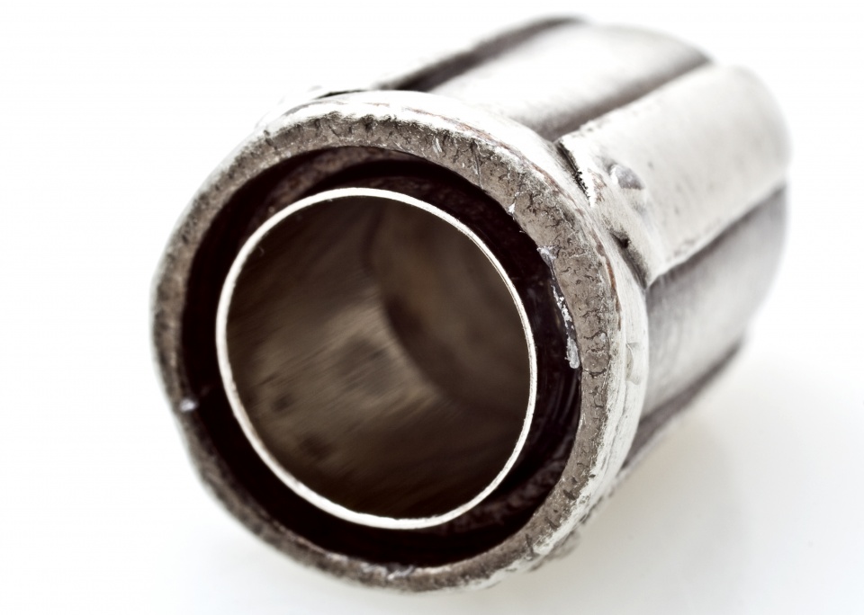

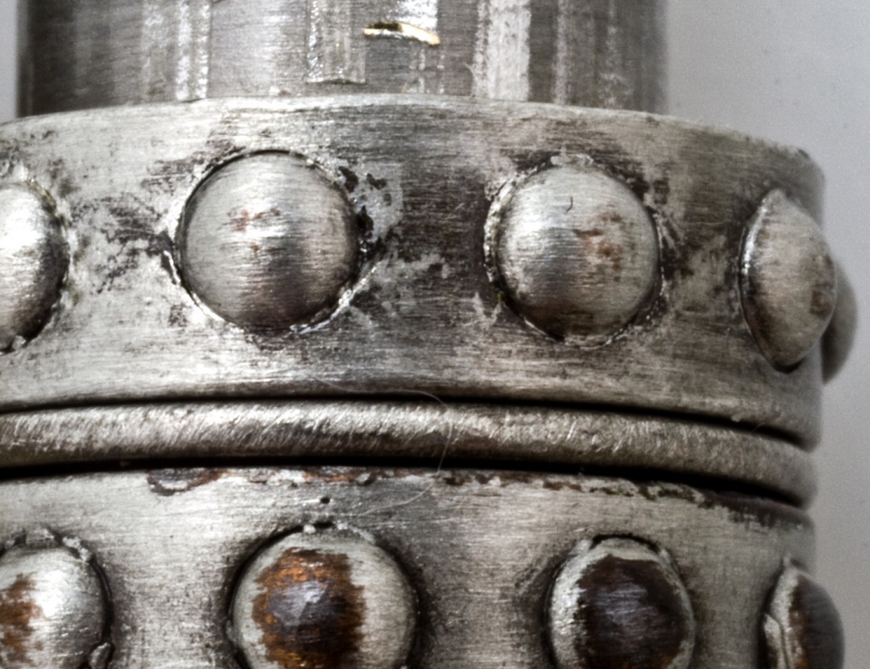

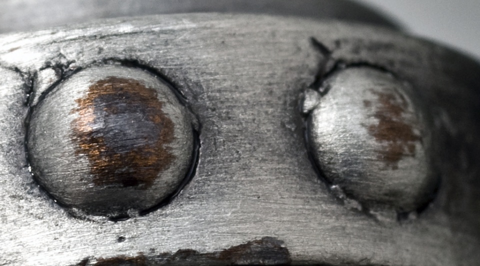

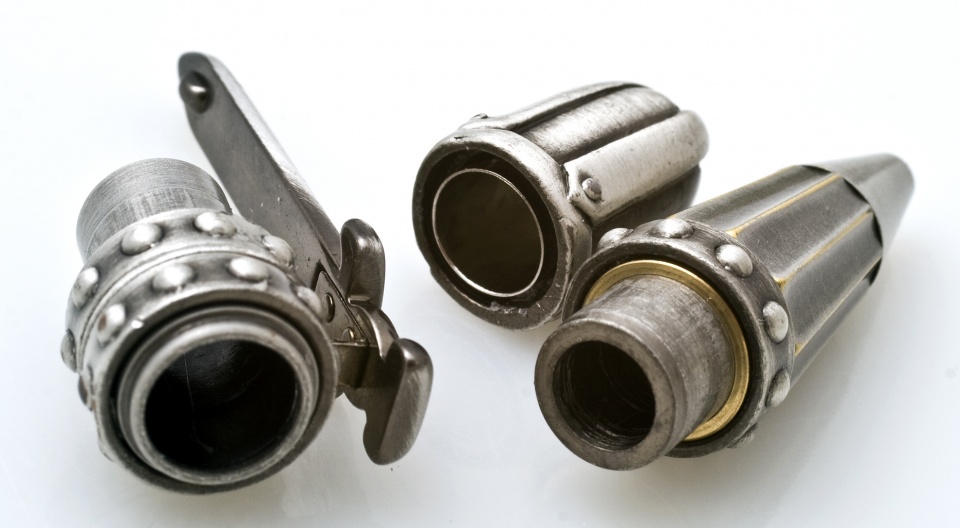

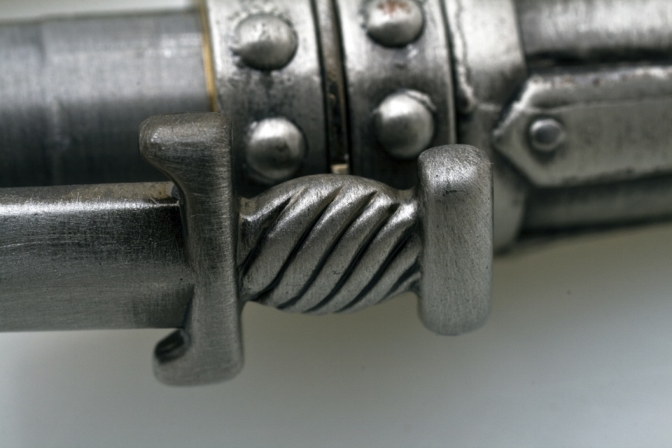

This is a Knights armor pen kit that I bought in Antique pewter.
I love me some macro work. We get to see a whole new level of details, viewpoints, advantage points and a good insight into things like health, structure, status and projections of an item.

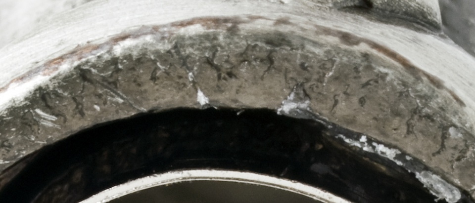

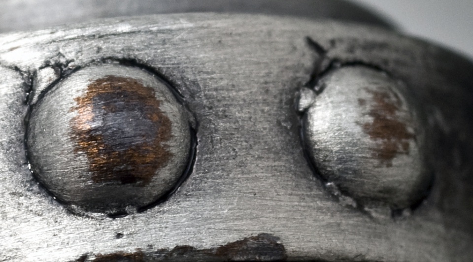

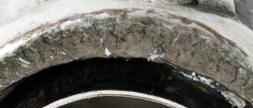

On this kit, the celtic kit and the victorian kit I have heard numerous people ask about the plating with very little answers. So this may help greatly.

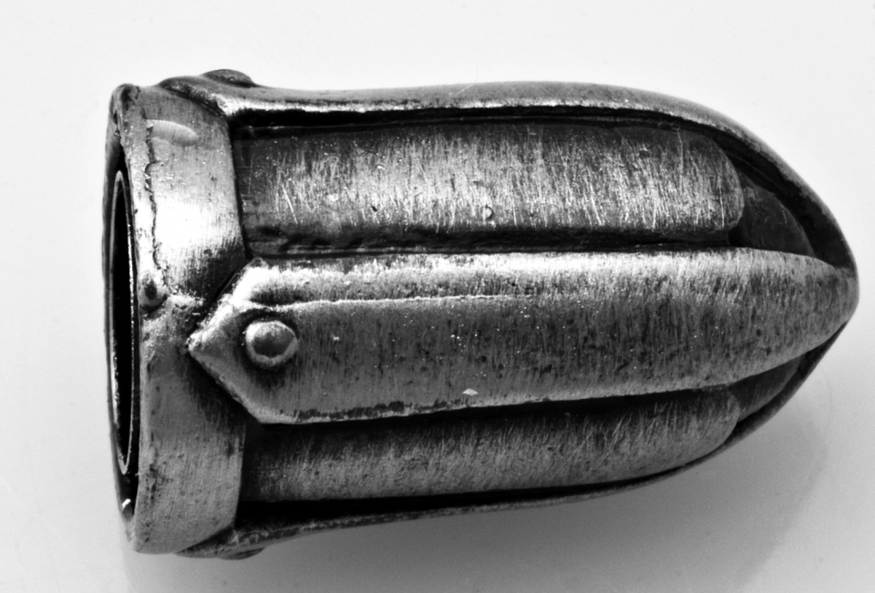

This first image I shot at ISO 100, F/29 and 1/100 shutter. Yes it is black and white.

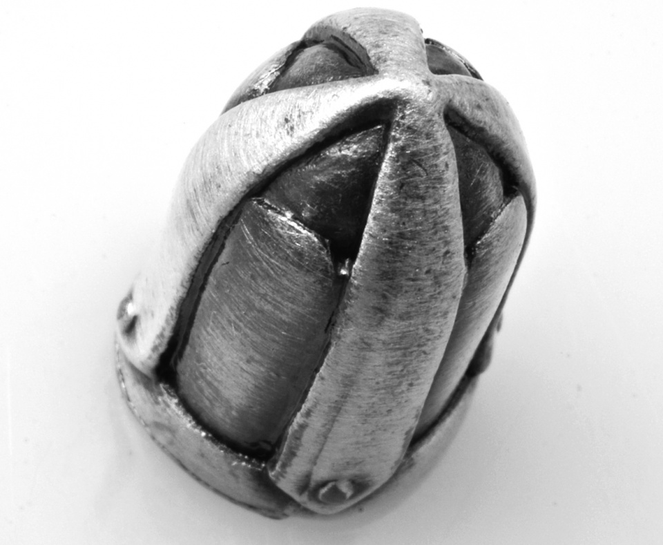

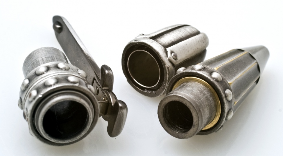

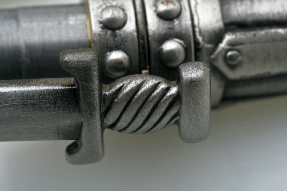

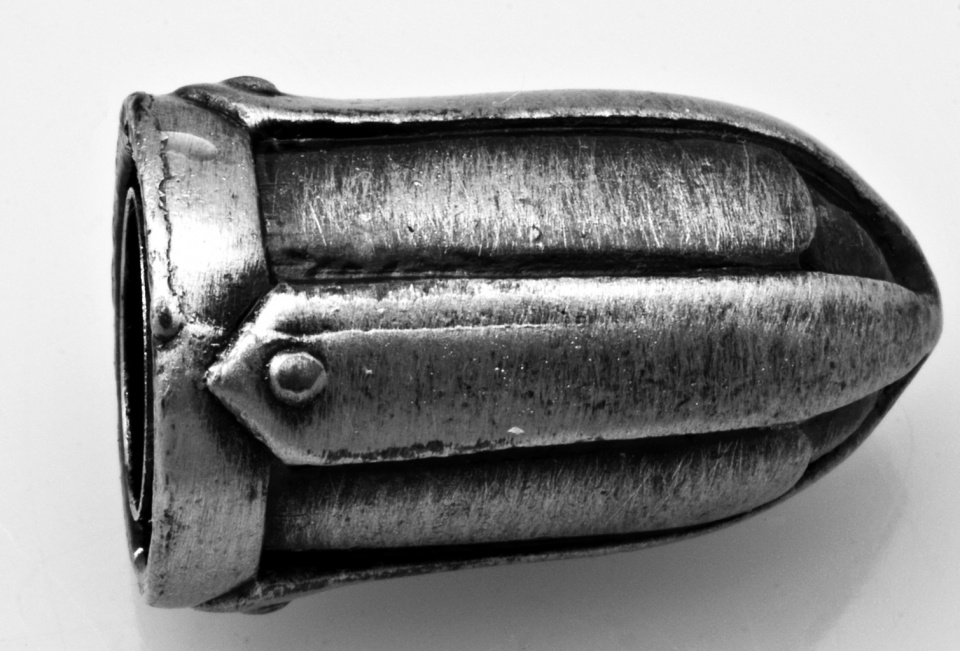

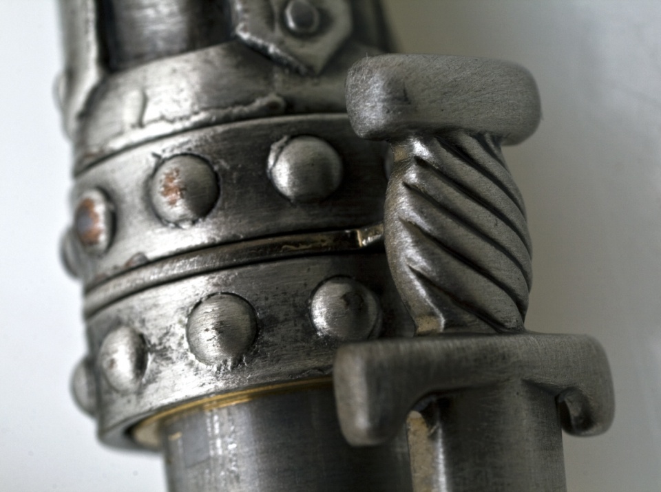

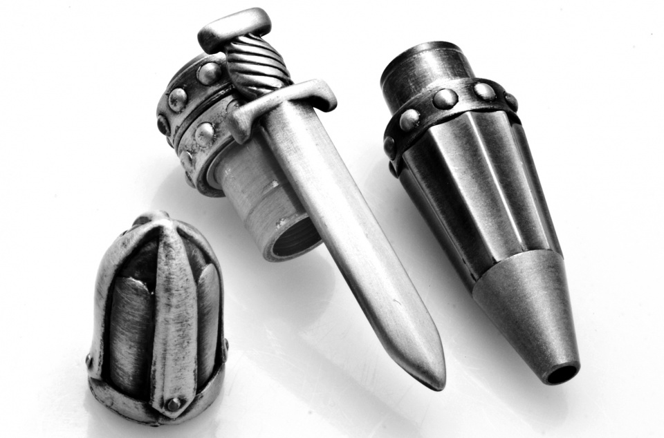

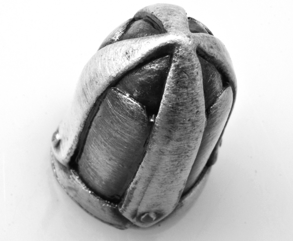

Some more.
Shot this one at F/29
attachment.php
This one is B/W also at F/29
attachment.php
attachment.php
attachment.php

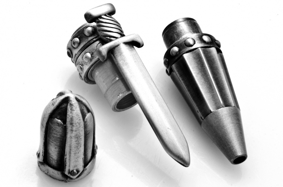

B/W
attachment.php
and lastly.
attachment.php

Thanks Ed for your brilliant Photographs, that show the manufactured detail, and finish of these Kit components.
I have heard mixed comments regarding the quality, Fit and Finish of these kits.
My thoughts are that in spite of the Finish and Fit problems experienced by some members, it is never the less inspiring that such classic styled items are being manufactured for the benefit of today's Pen Makers.
I have no doubt that the Casting, Welding, and Fabrication of their original era, would have presented them in a similar manner to those we are seeing today.
As such, I don't mind the "Agricultural" manufacture and finish appearance used, as I believe it is indicative of that era.
That is not to excuse the fitting and assembly problems that some members have experienced.
Undoubtedly they should have been adequately QA'd and Tested prior to release to the market.
All that being said I intend to give them a try.
Brian.

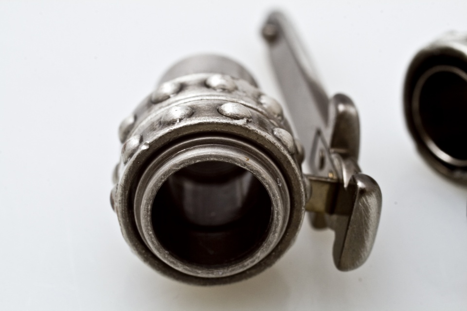

Any way that you can take pics of the inside of the cap,where the fitting problems have been? Where we are supposed to use an 8mm barrel triimmer shaft to deburr it?
I'm curious if it's just the antique brass ones that are bad,or both models.
The pair I ordered is about 2 delivery days away.I hope they fit right.

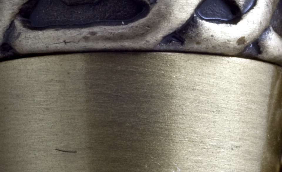

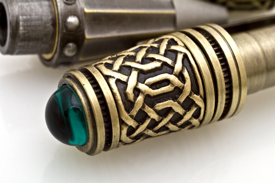

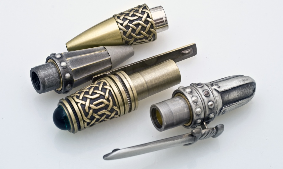

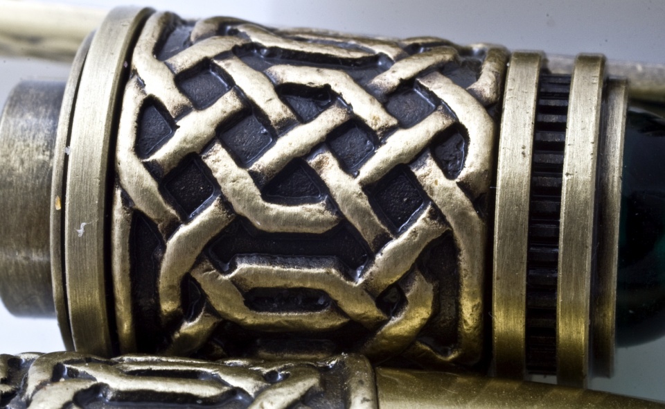

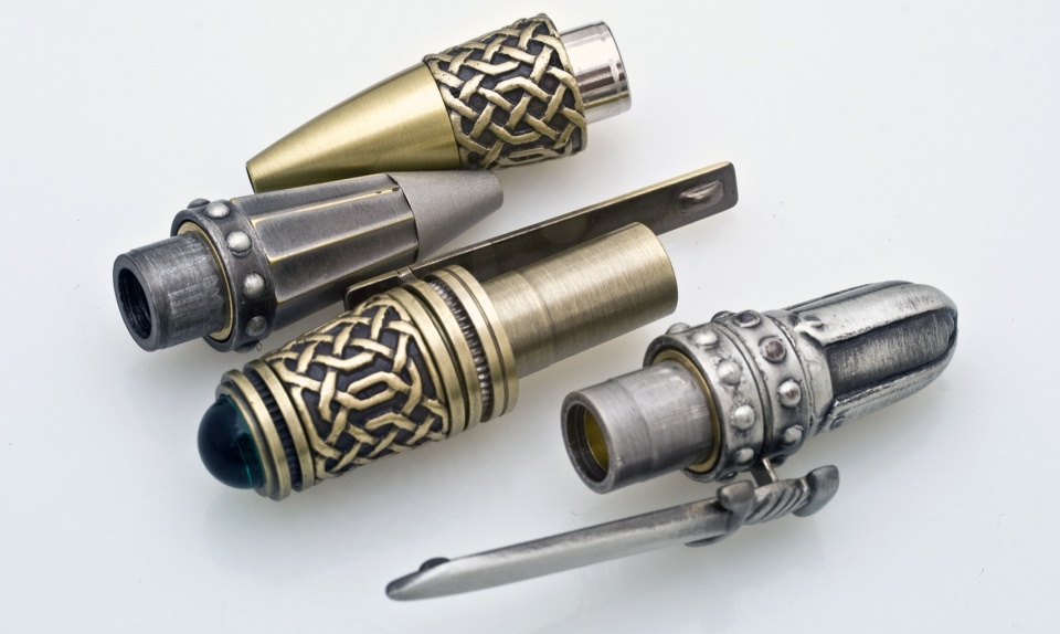

As fortune would have it I have 3x kits. I opened 2 so far and one of those has the obstruction in the cap that prevents it from going on. Mr Levy posted on a solution in another thread about that and I should be able to get details on the inside of that cap :) I also do plan on doing just that. We can also see on the end of the cap here.
There is the same type build up going on. It is non-obstructive but it is still there. Note the white blob on the right side of the photo.

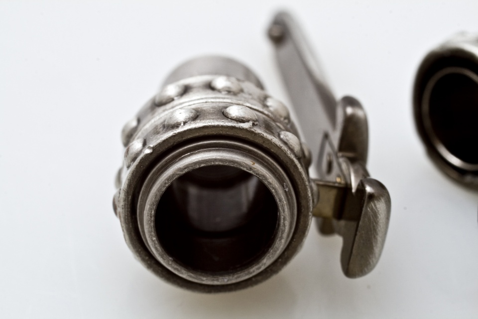

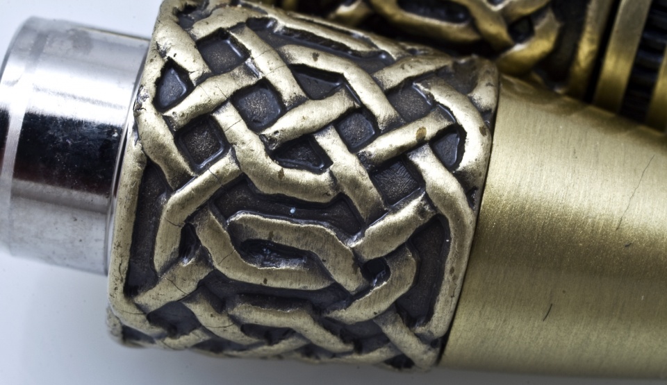

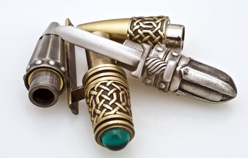

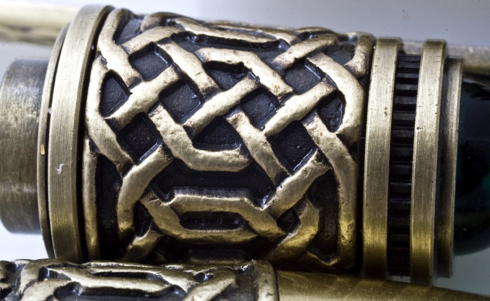

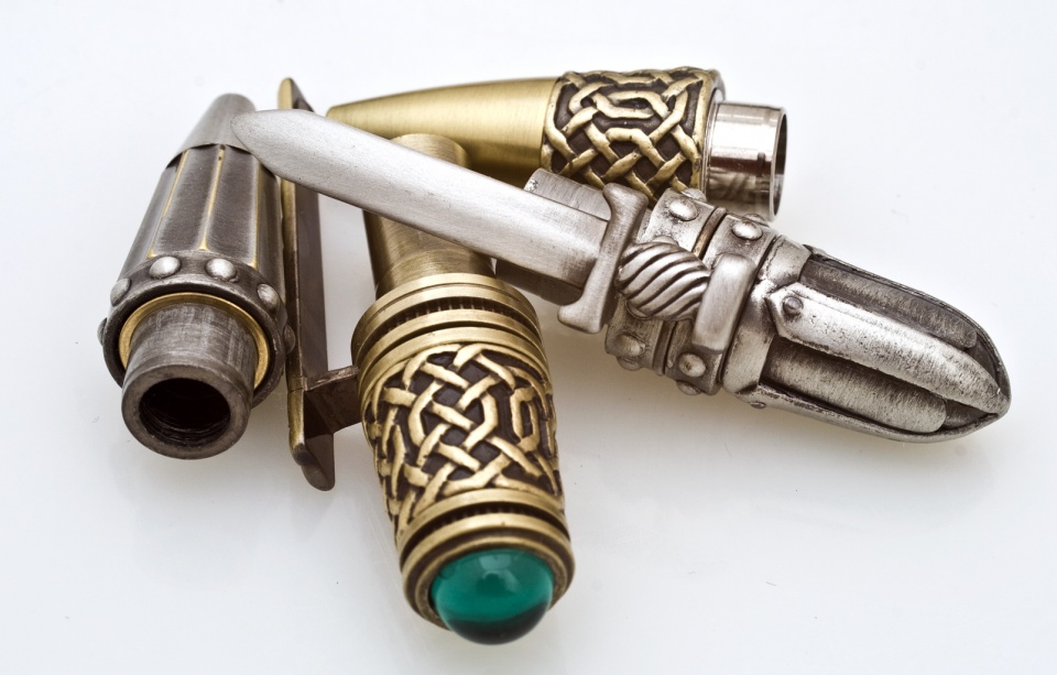

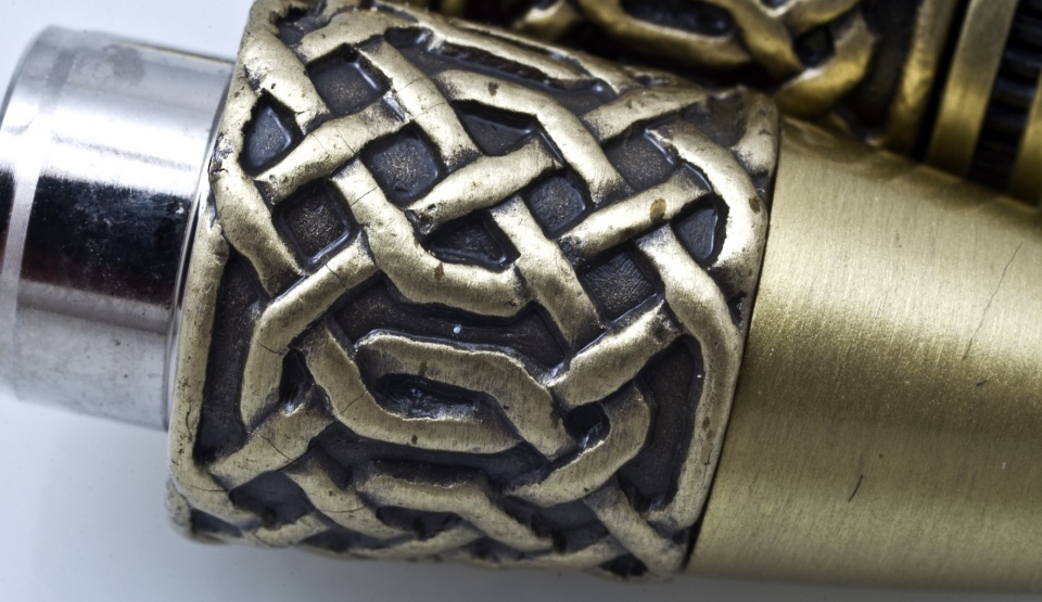

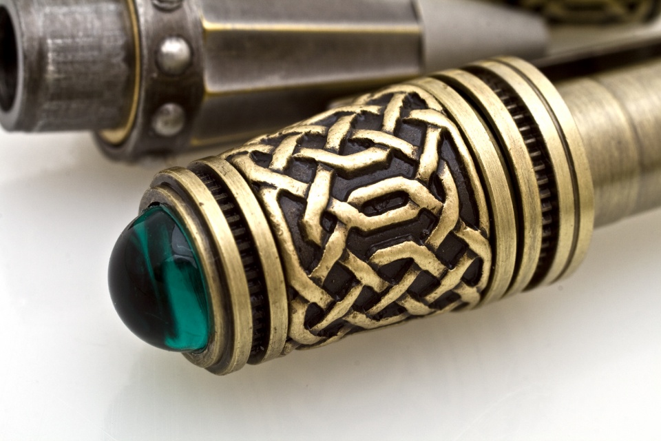

The kits look really 'rough' which I suppose is purposeful. Is the Celtic kit more refined then the knights armor?
As previous stated the rough look is indeed intended, hence 'antique'.
As for the celtic goes. ....

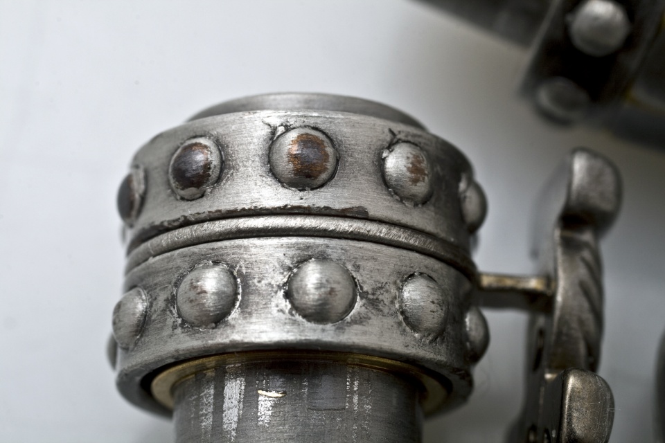

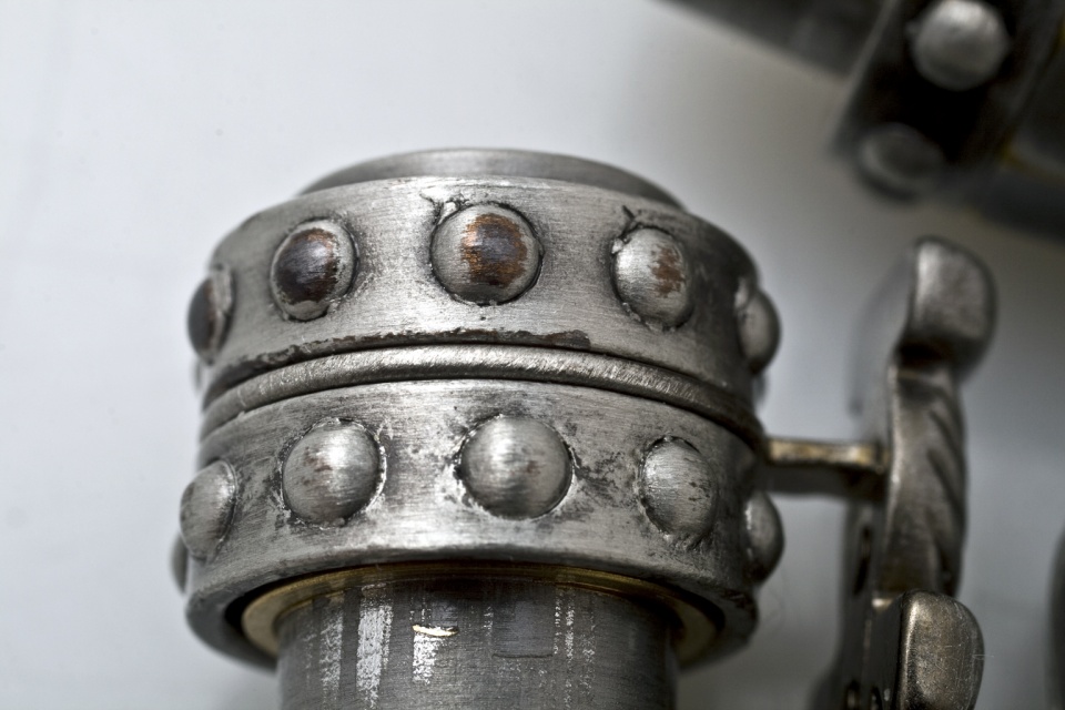

Well mabe i,m totally in the left feild here but due to the nature of that kit every plating issue i saw are totally normal and expected. It wll look even better with some wear to it i,m sure. Ordering some right now as there is a customer base for these!!. Any D&D role player will be trilled with these and there is a league of them not far from here !! ;)

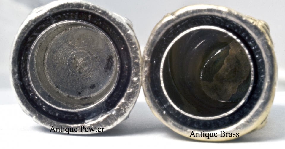

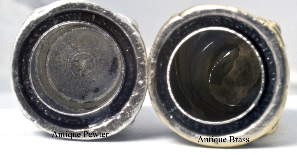

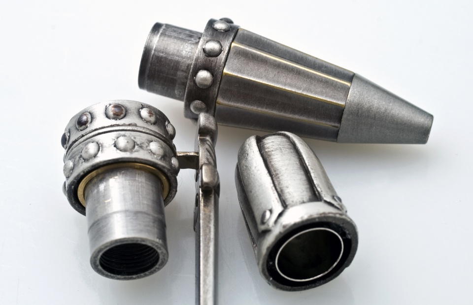

I spoke with someone at PSI about these kits today. It turns out the fit problem is only with the antique brass plating. There also is a clear epoxy coating over the plating for added protection, which is the shiny reflective coating that is notable in my photo's. They were unsure if it was ceramic based, enamel based or something else entirely.
Also with the cap problems on the antique brass they were hoping to get a redesign and remove the lip entirely because when the plating is done it pools up on that lip. With the close tolerance of the parts in that area it causes the cap to not seat properly.

No need for buyers remorse at all, not only is the solution simple and easy to do but it should be a routine practice of checking and testing parts before they are assembled. The person at PSI that I spoke with said they are indeed going to be making changes and we have Ed himself posting here on IAP to verify that fact.

The temp fix is likely going to be another Q/A pass on the assembly line as they are made. The problem with the cap is the clear epoxy coating they used is sprayed on and it pools up on the lip inside the cap and prevents it from seating fully. The lip itself is not needed for the design and can be eliminated entirely.
Here we see the difference between the inside cap on the pewter and brass. The antique brass has build up which needs to be cleaned out for good smooth operation.

Thanks for the picture,Ed.
I finished mine up, & posted it in SOYP.
I did use the 8mm barrel trimmer shaft as a end reamer like Ed said,and it worked great.It had a lot of glue in it!
The pewter one had more problems than the brass one,that I talked about in the SOYP thread.
So I'm going to wait a few months before ordering the kits,but will finish up the tubes now,while I'm able to.maybe by then the kinks will be worked out....
