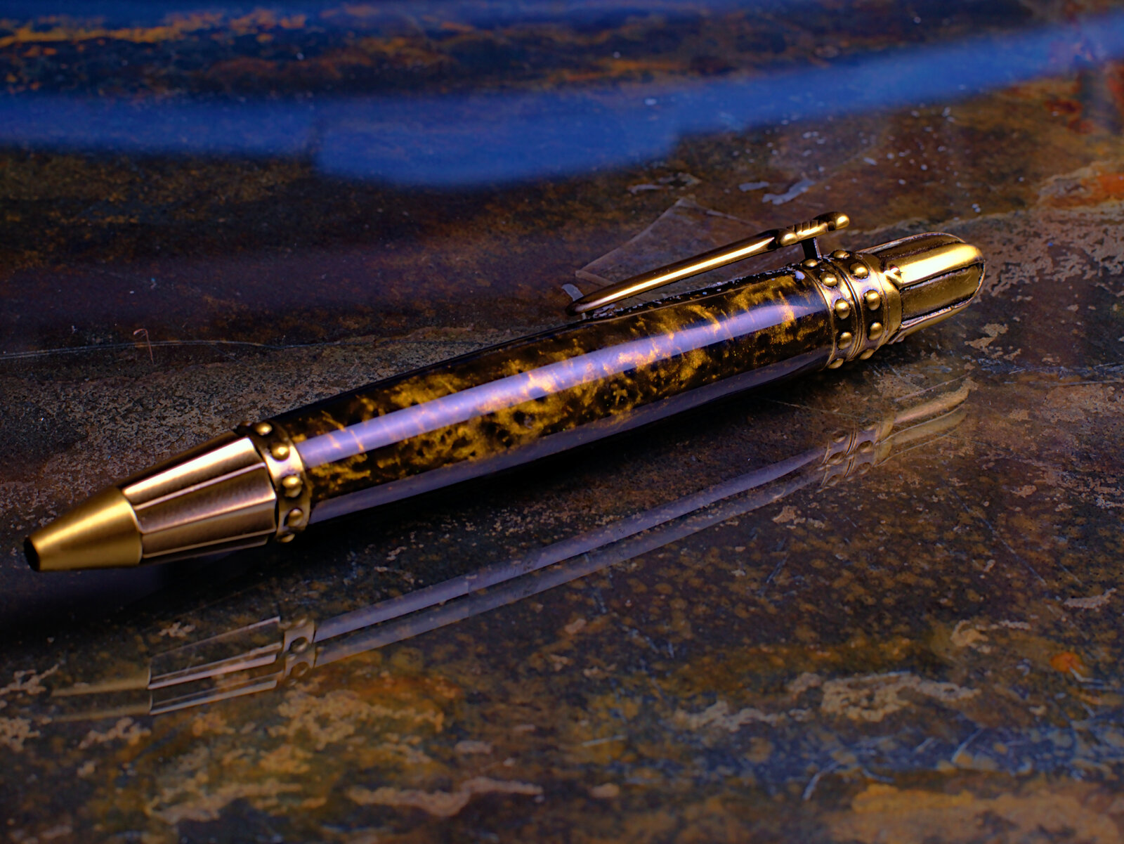

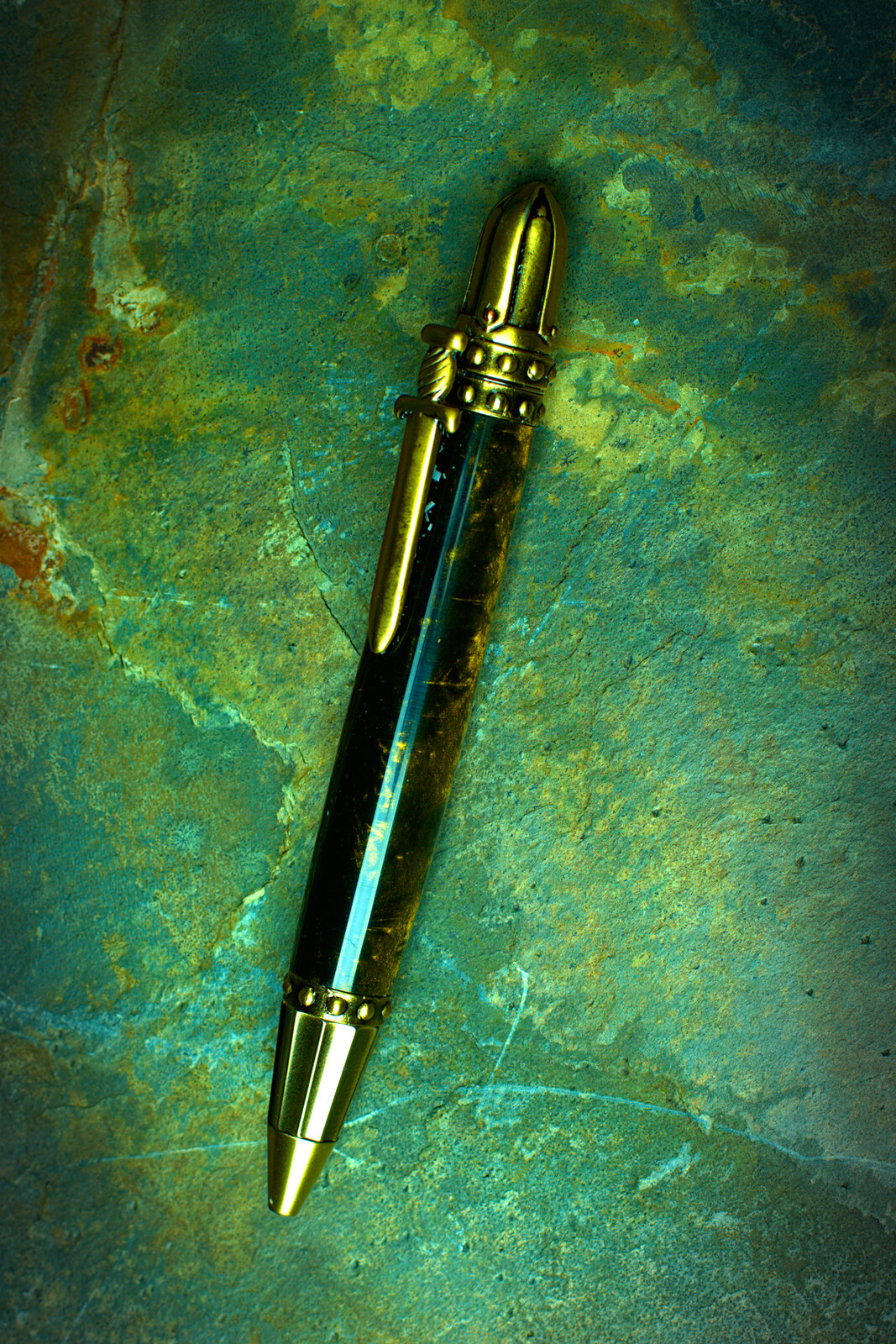

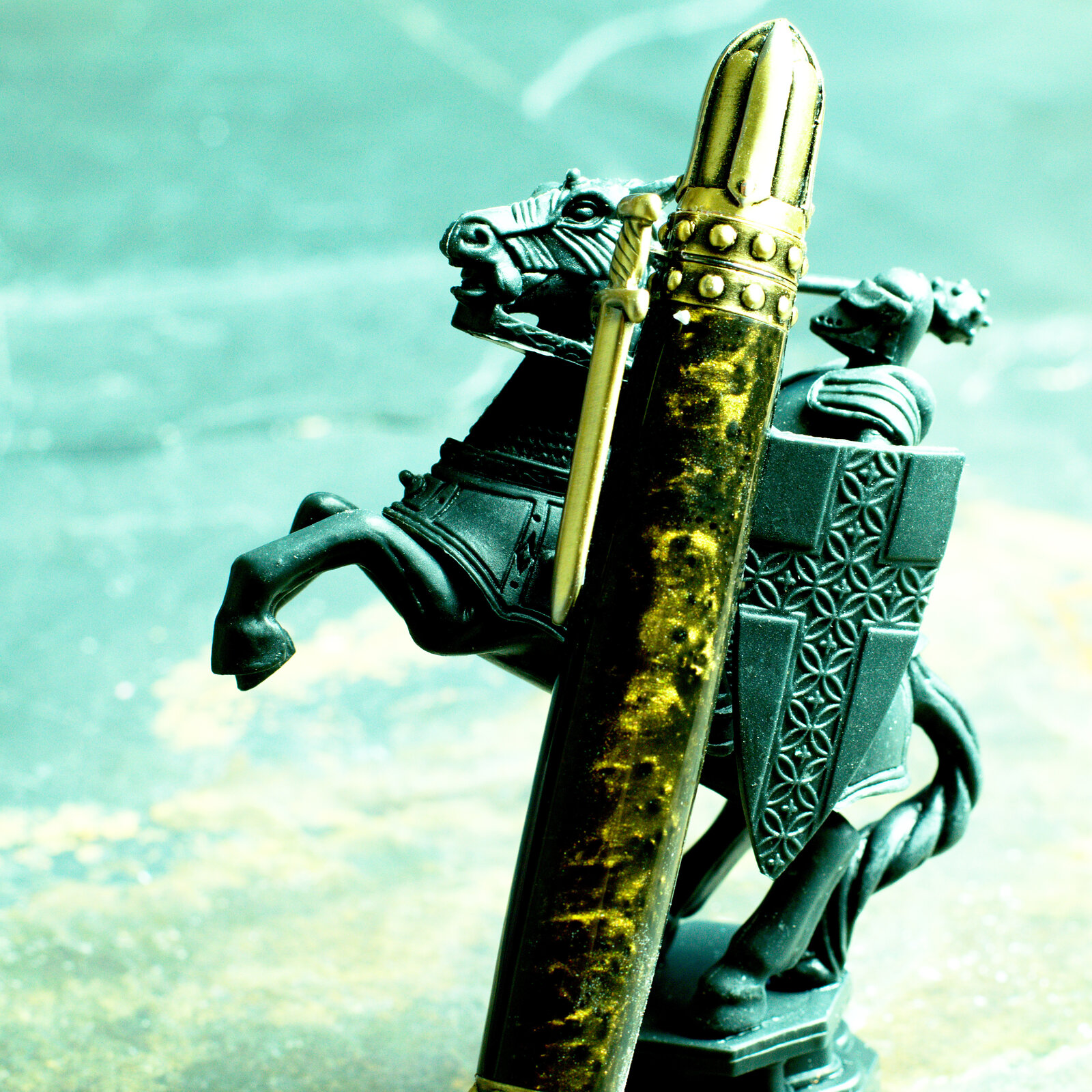

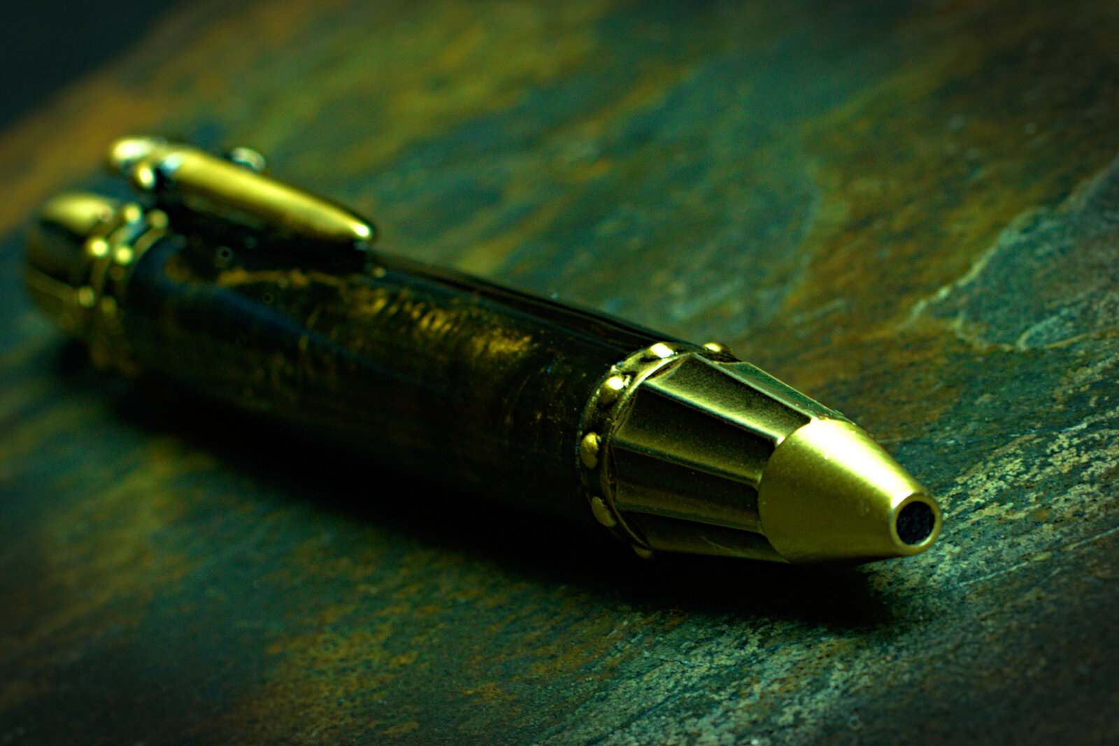

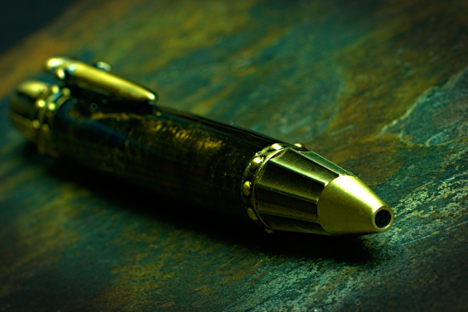

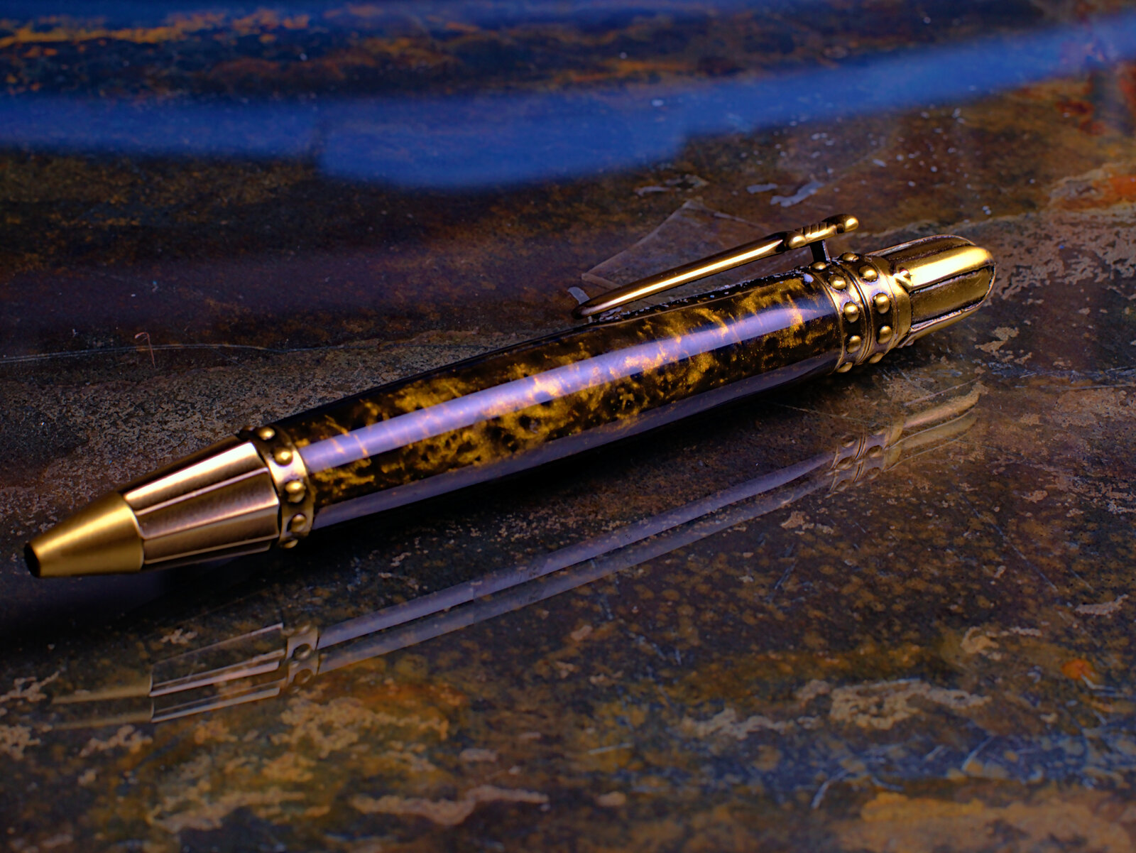

This is my first post here, my first pen from WoodTurningz, and my first Inlace Acrylester (Golden Black) and I have to say I've enjoyed both.
In my vast pen turning experience (maybe 30 pens) the Knight pen kit is well made and assembles easily.
I read several posts about Inlace and wondered if I made a mistake. I drilled the blank on the drill press with a self centering pen vise, took short cuts (¼") cleared my chips and gave the drill and blank a few seconds to cool between cuts. No problems at all. I turned the blank at my highest speed (3200 RPM) starting with a negative rake finisher. I experimented with different tools, a roughing gouge, skew, and a scrapper. All of them worked well. I finished the barrel with a micro mesh pads up to 12,000 then polished it.
Lessons Learned:
  • Don't be afraid to try new things, pay attention to the basics.
  • Paint the inside of the blank and tube. I always look at the blank and think, to dark the paint won't show through. But when I get the blank turned to size, I should have painted the tube.
  • Don't go by the bushings, measure the tip and cap and turn to those dimensions.
  • Carefully exam the blank for scratches and bad spots before assembly
Next pen is a Fountain Pen, haven't made one yet.

Good job on the pen. Fit and finish look real good. Those are truely good rules to live by when making pens. They will serve you well. Good luck as you go forward.
