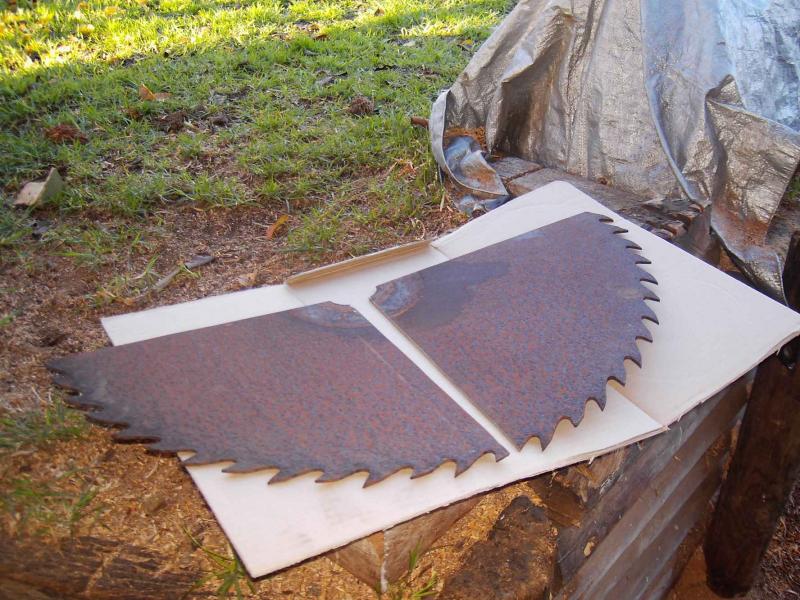

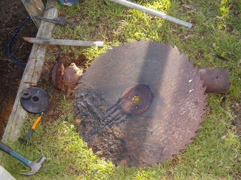

Probably one of the materials that will allow the easiest, quickest and very efficient knife making blade is the old blades from the circular saws once used to cut wood (mainly firewood) in many of the properties all over the world.
Australia has a long history on these and certainly a good supply of these blades that one can find in many property farms and old sheds. Most are discarded and put among the "junk" yard, other are dumped and many are left where they where last used. I remember to have seen many of these old rusty blades on dozens of properties I visited or worked on and never gave it a second though, they were of no use to me and many were still attached to their old motors, shafts, etc, which would require some heavy duty equipment to get them out or in worse possible scenario a gas torch to cut them out, none of that equipment was at my disposal so I ignored them.
Many years later I met an old retired fellow "Barry" that loves making knifes using nothing else than a 4" grinder and a drill and a belt sander, all he can afford...!:frown: He found me and wanted some of my She/Bull-Oak and Olive wood for some handles, these here his 2 preferred woods but something he hadn't seen for sale or able to afford for a long time so we got talking and I send him (Brisbane) some of these 2 woods for him to work on.
He has also his own "signature" or should I say "personal touch" on all the knifes he makes as he puts lots of little Opal and other stones as part of the handle making. Barry has a lady friend at one of the major Opal mines that sells him these bags of little left-overs from the Opal processing plant.
Anyway, last year Barry asked me if I knew where to get one of these old circular saw blades, one of his preferred materials also but unable to find one of those blades for many, many years so, and without thinking I said, yes mate no problems I will get you one...! Was only after I said this that I realise that all the places I knew where to find them are/were, are thousand a miles away...!:eek::mad:
Anyway, I though to myself, sure this is an area where people have been using firewood for ever so, I should find some soon, somewhere...!
Amazing what one can find when looking for, and sure in one of the places close to town where I have been before, I spotted a metal frame on the tall green grass, not far from an old shed and at closer examination, there it was, the blade still attached to its shaft, as part of a frame from a tractor power supplying source, commonly used in those old says...!
Lukely for me the shaft was already detached from the metal frame and I needed to take the whole thing home as the large size nut was very rusted out, requiring some elbow grease and heavy tools to get it undone or cut off, which end-up what I had to do...!
Cut the blade in half, kept one half and send the other half also cut in half again for easy posting and said nothing until I've heard from Barry.:biggrin:

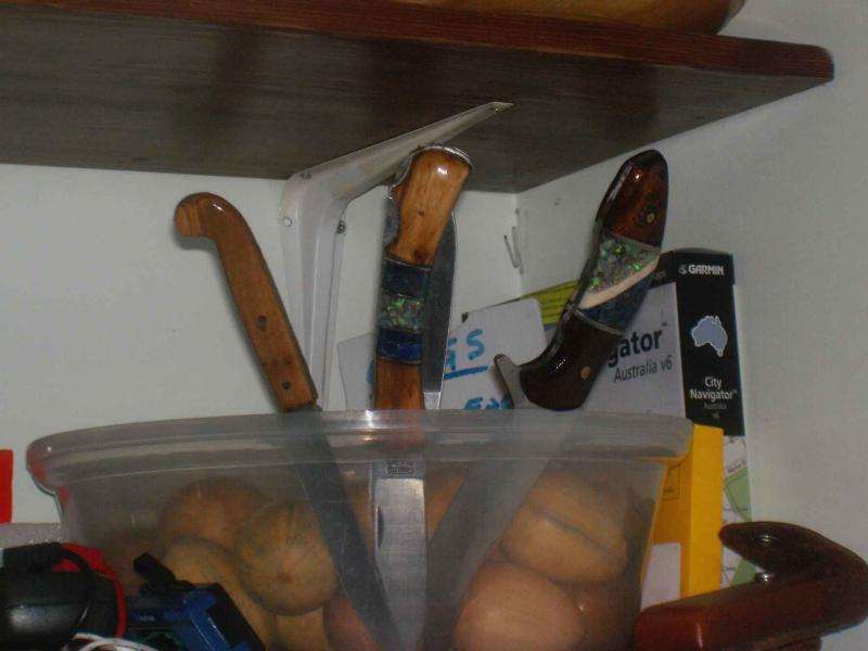

Was he happy or what,:cool: he didn't thing that I would give it a second tough as he has been promised some of those before and nothing ever happened so he was over the moon with these 2 quarters of a very large circular saw blade which he end-up cutting 16 knifes from (all shapes and sizes...!):biggrin:

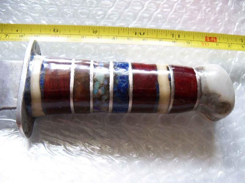

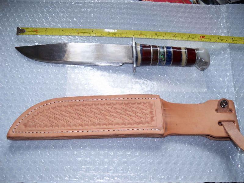

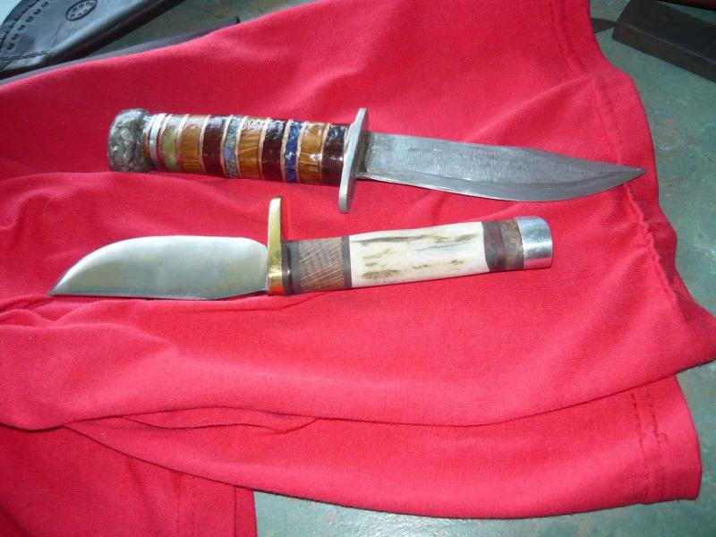

Little I knew, he himself decided to make me a "special" knife as a Christmas (2010) present surprise, and surely a few weeks before Christmas, I received this box from Barry and inside was this very interesting large hand made knife which he made for my hunting's. Considering what he had to work with, in materials and tools, I was certainly pleased with his surprise, as he also use some of the She/Bull-Oak I sent him...!:biggrin:
I have seen his work on another couple of knifes I made and send me, one also for my wife made with Majestic Olive in the handle. This large hunting knife he made me, would be and ideal "sticker" knife the days I was chasing feral pigs, nevertheless, it will be a knife that I will admire for many years to come.

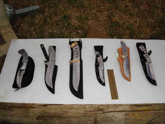

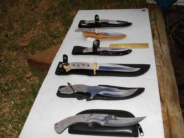

After spending so much time writing and talking with Barry about knife making, I got somehow excited about the idea of making a couple for myself but using already the blades (blanks) made from the US, there are many places on eBay where they are found at very affordable prices so, I got to one of these sites and let myself lose for a little while and before I knew it I had $300 worth of gear in my "basket"...!:eek:
This was about 18 months ago, and everything still in the box it came from, all my projects planned for last Winter, as a indoor stuff while the weather isn't inviting to be out there working on trees (woods), were in fact good plans but somehow they were all changed as a lot of outside work was required and the weather did allow me to do it so all the under cover jobs had/have to wait...!
I end-up ordering some more stuff, knife making related from the same people but I'm attaching a pic of what I got the first time I went on their site...!:eek::)

I will attached also some pics of this blade and the hunting knife Barry made for me...!

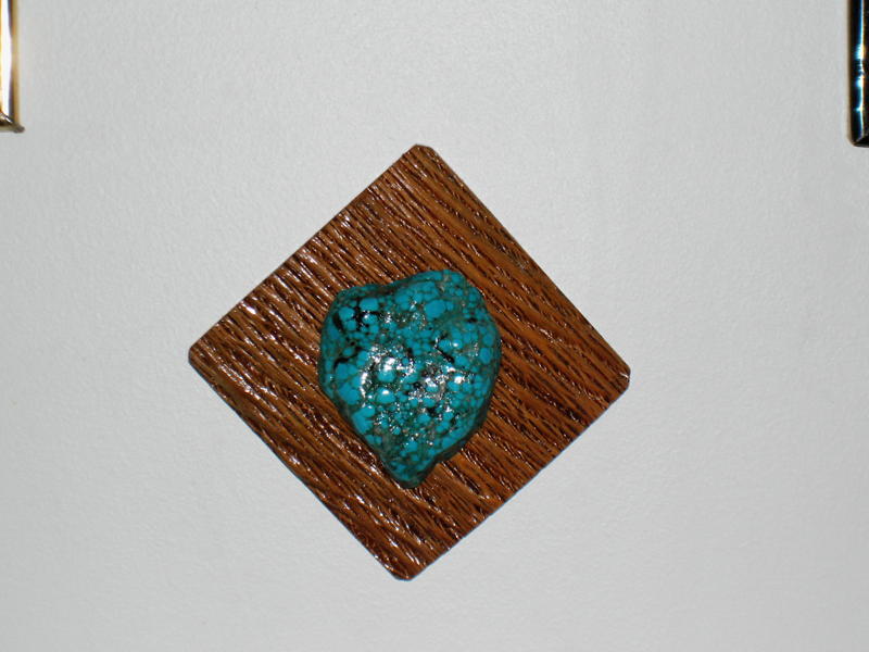

Oops... I forgot to add the pics from my latest approach to knife making (well..., knife handle making to be correct...!)
