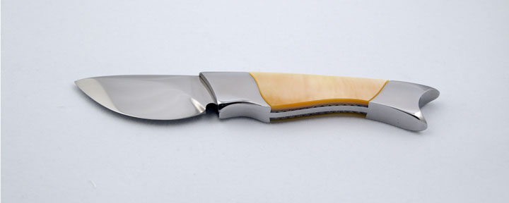

I've made a few custom knives and when I did I did not have fancy equipment, in fact, I did not even have a sander - all finishing was done with a file and then a buffing wheel.
For machines I had nothing more than a drill/mill for drilling only and a cutoff/band saw. Oh, I had a vise, too.
Here's a picture of what you can do with a drill, saw, and files - this is not a kit. You do have to develop technique but all you need to do is buy the tool steel blanks, finish it to final shape, get someone to heat treat it, and put your handles on it. This one has mother-of-pearl handles with titanium liners underneath with some decorative filework. Just an example and I'm sure your style will vary. There are lots of books on the subject and try to go to some knife shows where you will find a lot of helpful people.

Rich thats a nice one. Smoky Mountain Knife Works carries some kits but i didn't see any skinners like this one.

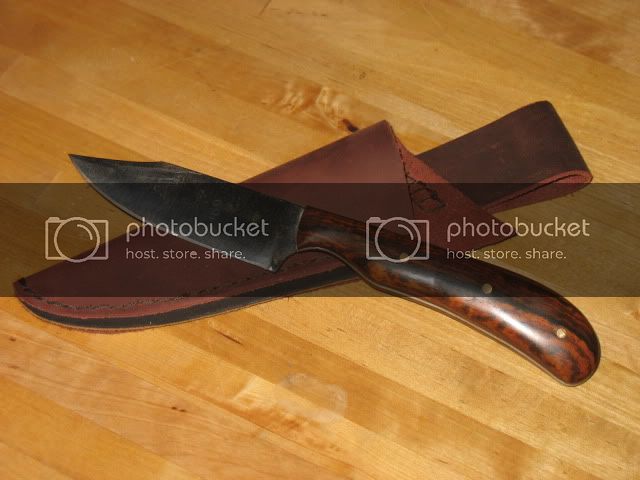

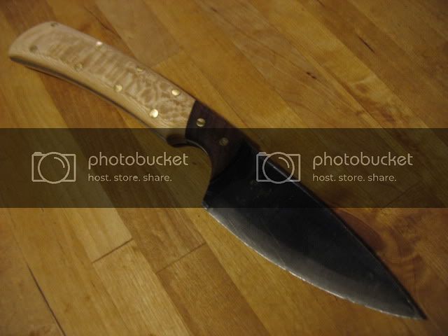

Having made a few knives myself (I forge my own blades) I think a kit is a good way to get started. If you go to www.knifeandgun.com/ you can find just blades in damascus or high carbon tool steel. That way you can use your own wood. If you want to go up a step then Rich L talked about stock removal (where you take a blank of tool steel and remove anything that does not look like a knife) make sure you get annealed steel. I would be willing to help if you have any questions.

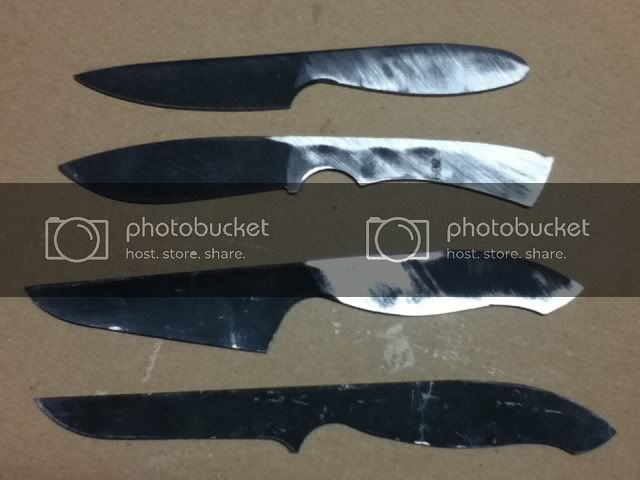

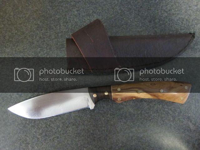

:smile::smile: Some of my knife blades are old files, some I buy, and some I use surgical steel. If you want to use the last one, figure on a lot of time grinding. I form the wood by drilling it and mounting it to the blade, then using an oscilating sander to shape the scales to the blade. I shape the scales with a dremmel tool or wood rasps and sand. My finish of choise is a high gloss water based poly (Hydrocoat) finished with 0000 steel wool and Murphy's Oil Soap, then buffed to a high sheen. After grinding my blade I use a series of Japanese water stones starting with 300 grit and finishing with 8000 grit. Next is aluminum oxide and a leather barber strop. The strop takes off the little curl you get when you sharpen an edged tool. If you look at the blade and you can see lite reflecting on the edge, it's not sharp yet. Anway, that my method. Good luck Jim S
