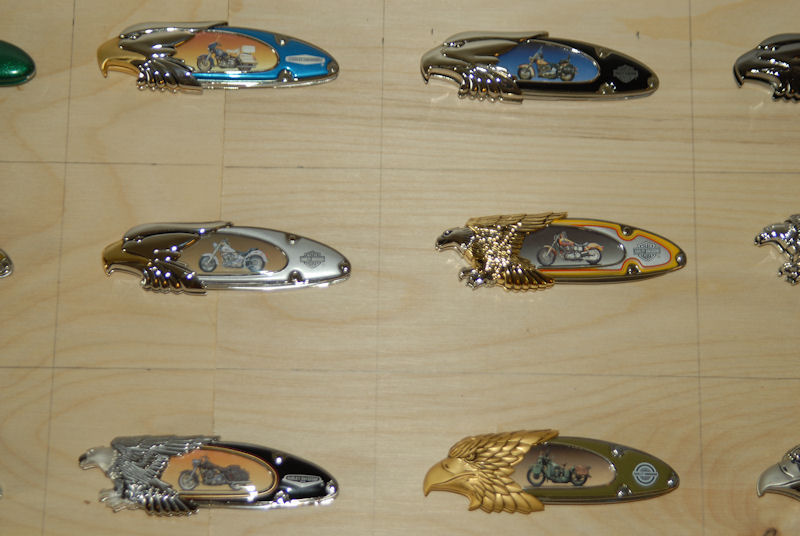

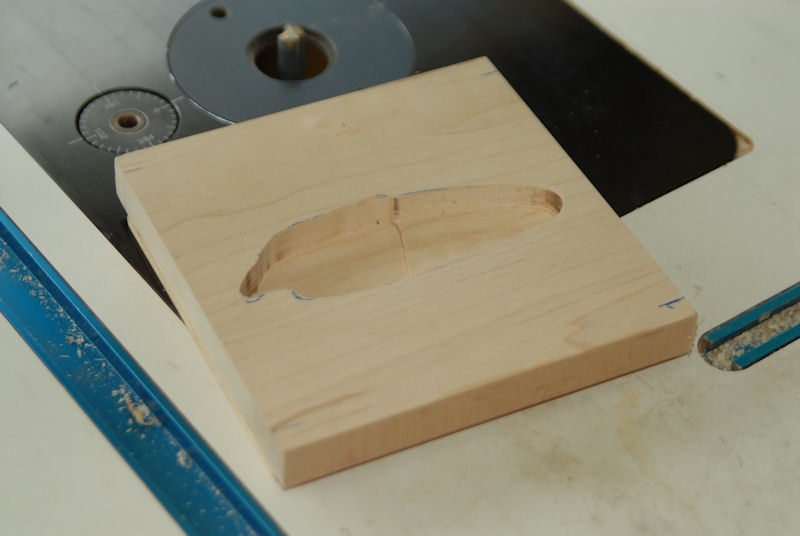

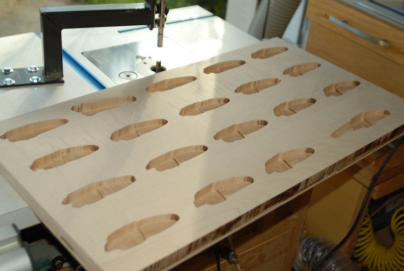

I've received a commission to build a knife display case. There will be a total of 19 slots routed into the backer board. Each slot is routed at two different depth because the handle of knife varies in thickness.

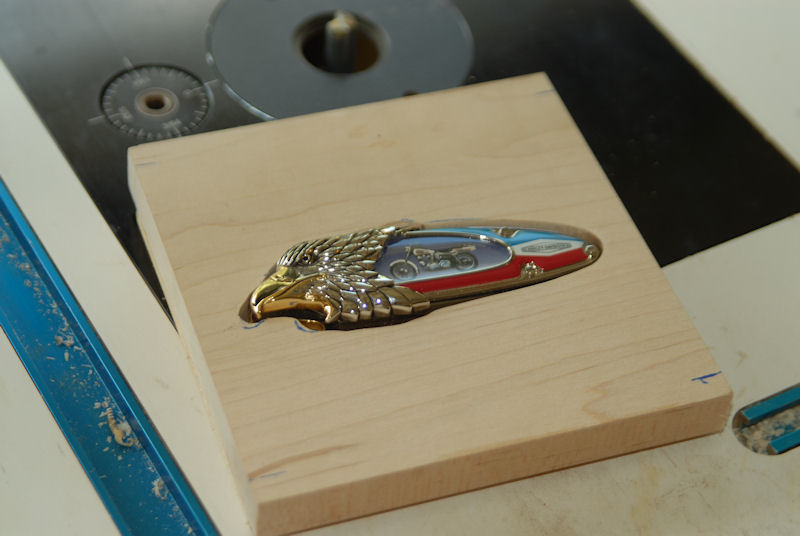

I've just done a test piece and it worked out great, with one small problem. The case will be configured so that it can be hung on the wall or placed on a desk. The knife sits in the slot nicely when the piece is either horizontal or vertical. However, in the vertical position I can see that it will not take much for the knife to fall out. A door in the room being slammed shut, someone knocking the wall hard, the space shuttle returning back to Kennedy, take your pick :)
I had anticipated this and had thought of epoxying a rare earth magnet into the slot to hold the knife securely. However, the magent doesn't stick very well to whatever material the handle and decorative eagle's head is made of.

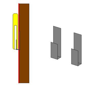

Keith, here's a sketch of how I'd do it. I'd make a couple of clips, like Terry Clips. Recess them into your backer and then cover the backer with baize.
The clips could slip between the blade and the inner knife frame, or perhaps have the knife blade open. This would hold them either with the display case horizontally or vertically.
You could make the clips from thin stainless ( or even from thin brass shim stock ) and if you polished them nicely then they wouldn't scratch anything. The pic is supposed to be a side view.

Steven, I like your clip idea. Unfortunately my customer wants the knives recessed in a slot. Also I suck at making metal into different shapes and look good :redface: If I had to start making little clips I'd probably be better off just nailing the knives to the board :biggrin:

I routed out all the pockets today. Still need to rout some finger pockets to make it easier to get the knives out. The material was thicker than my test piece and so I was able to rout the pockets deeper and so my concerns about the knives falling are somewhat reduced.
Taking Mikes idea a step further I have not ruled out making the sides of the frame (box) taper, so that the box sits flush to the wall but the board the pockets are in are at a slight angle relative to the wall.
Justin, your idea could work. There is a slight gap between the handles where the blade is that could accept a small piece of wood. I could cut the slots for that with a slot cutter in my router.
Thanks again for all the ideas. I've attached a picture of showing the pockets all routed with the knives in them.
